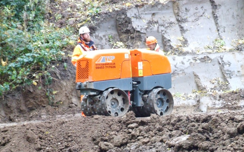

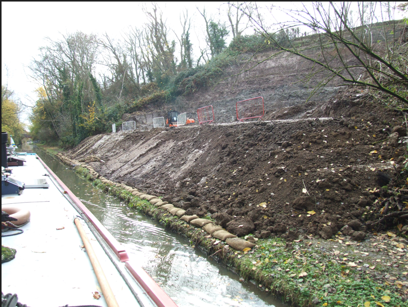

Some big earth works going on there at the moment

3 hours ago, David Mack said:
This is Easenhall cutting on the North Oxford (where there was a major slip last year) some time in the 1910s i.e. about 110 years ago. By no means as tree covered as today, but equally not kept clear of tree growth.
A close look at the embankment now shows very large number of burrows and holes . I suspect it’s badger or rabbits which can’t be helpful for embankment stability. Perhaps they don’t go deep enough but I fear they do.
Any action against animals is likely to be greeted with more uproar than tree pruning though.
#23
Looks like plenty of evidence of slope instability.
