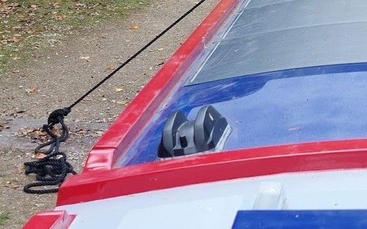

robtheplod Posted November 12 Report Posted November 12 4 minutes ago, IanD said: If you want an antenna to fit onto the roof instead of a pole, the Panorama GPSD4-6-60 (around £200) works very well though it's not easy to find in the UK -- in spite of Panorama being a UK company! It has the advantage of being designed to work right next to a big flat metal thing (a narrowboat roof) which the panel antennas don't really like (unless you put them up on a pole), and actually gets an extra couple of dB of gain from this. Here's one in situ... 😉 got one of these thanks to Ians advice, they are excellent, and if funds permit the Teltonika RUTX50 is an excellent router to go with it. 1
NB Thistle Posted November 12 Author Report Posted November 12 20 minutes ago, IanD said: If you want an antenna to fit onto the roof instead of a pole, the Panorama GPSD4-6-60 (around £200) works very well though it's not easy to find in the UK -- in spite of Panorama being a UK company! It has the advantage of being designed to work right next to a big flat metal thing (a narrowboat roof) which the panel antennas don't really like (unless you put them up on a pole), and actually gets an extra couple of dB of gain from this. Here's one in situ... 😉 And doesn't need taking down to do through tunnels either!
IanD Posted November 12 Report Posted November 12 3 minutes ago, robtheplod said: got one of these thanks to Ians advice, they are excellent, and if funds permit the Teltonika RUTX50 is an excellent router to go with it. As is the AX-3000, which has some advantages... 😉 They're both excellent products, there's a comparison here: 2 minutes ago, NB Thistle said: And doesn't need taking down to do through tunnels either! There's an extra hidden advantage if you can do what I did and put the antenna immediately above the router (mine's in an overhead cupboard in the galley) -- you can then use very short low-loss cables between them, which further improves signal levels compared to the common solution of a panel antenna in the bows and a router somewhere inside the boat connected by 5m cables.
NB Thistle Posted November 12 Author Report Posted November 12 3 minutes ago, IanD said: As is the AX-3000, which has some advantages... 😉 They're both excellent products, there's a comparison here: There's an extra hidden advantage if you can do what I did and put the antenna immediately above the router (mine's in an overhead cupboard in the galley) -- you can then use very short low-loss cables between them, which further improves signal levels compared to the common solution of a panel antenna in the bows and a router somewhere inside the boat connected by 5m cables. I've got holes where the current antenna cables go through the roof and the front bulkhead so I'll probably use those, but I am doing my research on the best cables to use rather than buying blind like I did last time.
robtheplod Posted November 12 Report Posted November 12 Skip past me droning on to see how i mounted this.... you might find it useful? 1 1
