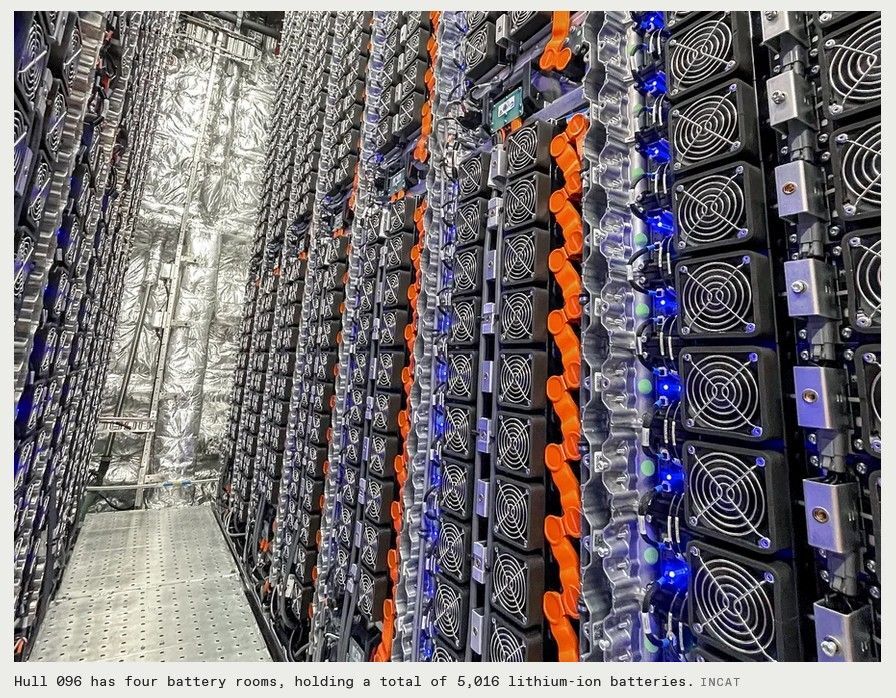

The ship’s 40 megawatt-hour energy storage system, which Incat says is four times as large as that of any existing ship, has 12 battery arrays with 418 modules apiece, for a total of 5,016 lithium-ion batteries distributed between four rooms
These will be able to keep the ship going for 90 minutes before needing to be recharged
Just 90 minutes from all that....more work needed.!!
Why, when the trip is only an hour long, with recharging while unloading/loading?
Batteries are nowhere near usable for long-range shipping (or planes) -- which is why they're being used here for a ferry, which they're ideal for... 😉
