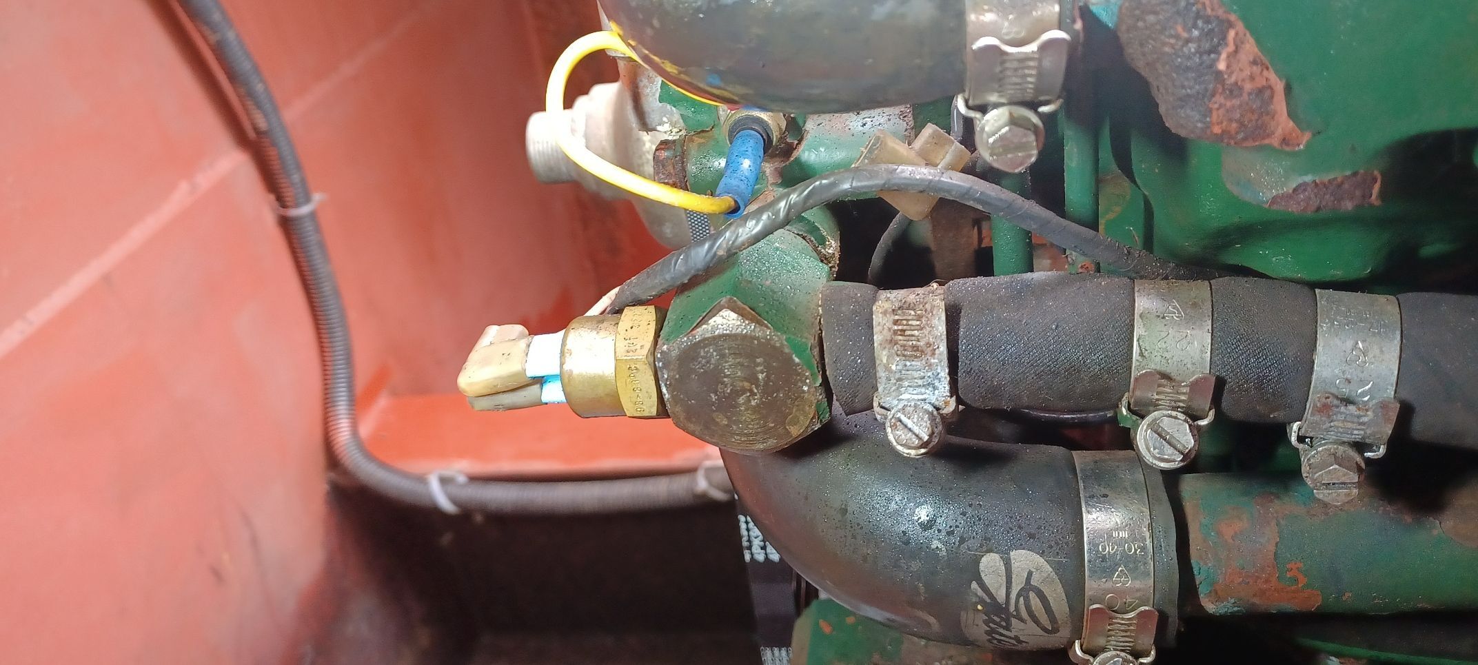

jonathanA Posted November 4, 2025 Report Posted November 4, 2025 (edited) The temperature warning light and buzzer fitted to the standard lister control panel is usually loud enough to alert me to a problem. So if you hsve a proper lister control panel it will be worth investigating why that's not buzzing and or fitting a louder/extra buzzer if you need one. Personally I wouldn't be looking at 3rd party strap on solutions, better to get the standard system working. The water temp warning light switch and sender for a gauge are usually separate devices on the side of the thermostat housing. If fitted. I've found the temperature warning light switch lister use to be a bit vulnerable as its easy to catch as you clamber round the engine and either knock.the wires off or break it. Is the oil cooler problem the rubber boot coming off ? I had that happen to me after replacing one that had split. You have to make sure the outside of theoil cooler tube is very clean and push the boot on as far as itvwill go which isn't very far then tighten up the jubilee clip tight. Then tighten it a bit more then take it off because it's not on square and do it again until the boot and clip are square and properly on the tube. 😅 Edited November 4, 2025 by jonathanA Sp

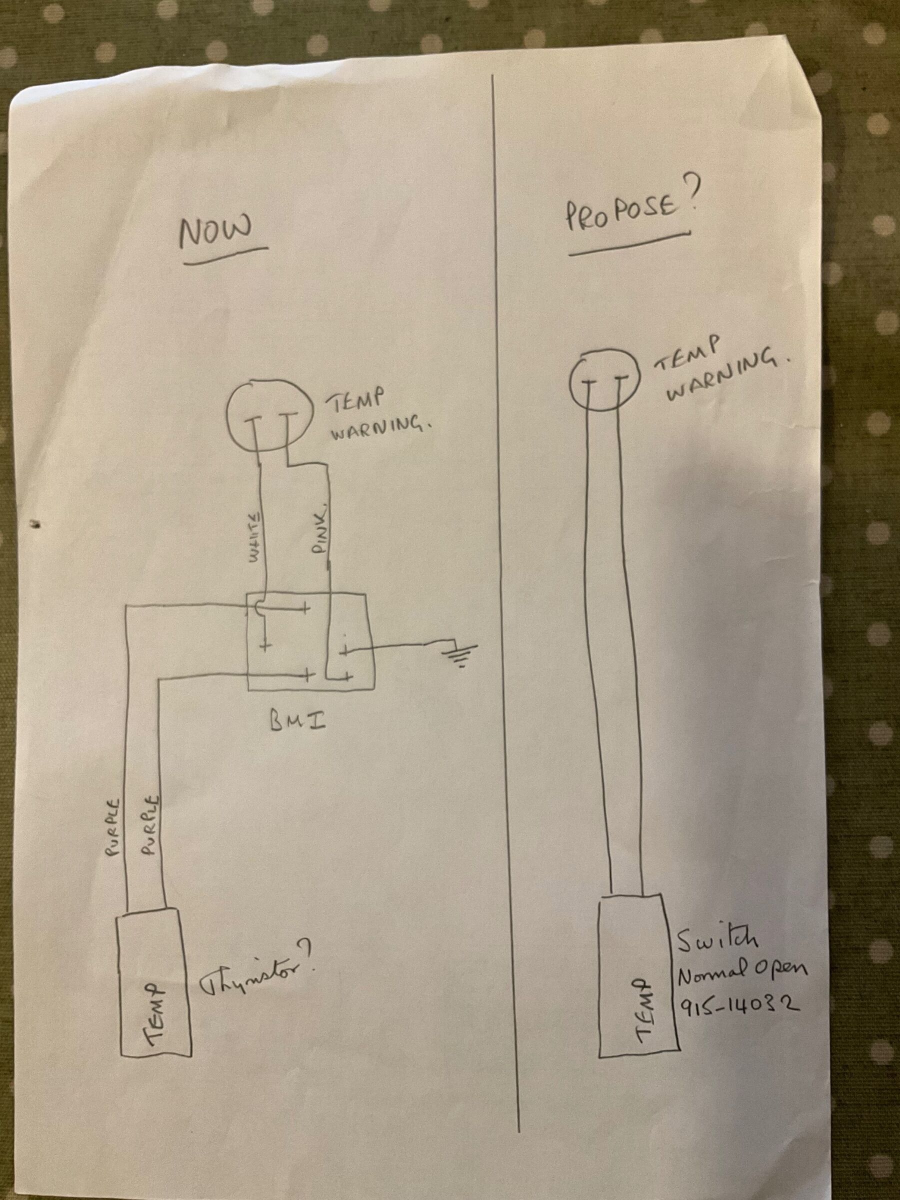

Peugeot 106 Posted November 4, 2025 Report Posted November 4, 2025 You probably have a thermistor and BMI giving you the alarm. If you PM me with your email address I can forward to you correspondence and instructions from Peter Thompson regarding replacing the thermistor and BMI with a normally open switch (available from Sleeman Hawken) Peter used to refurbish and marinise these engines for Lister Petter Agreed the wires fall off the thermistor easily so check as Jonathan suggests Just found my diagram!
jonathanA Posted November 4, 2025 Report Posted November 4, 2025 thought this pic might help you. this is my temp switch at the front and an after market gauge sender with the yellow wire/blue connector. my engine has the lister cauliflower take off which is where the temp warning light switch is fitted. The part number i have for the temp warning switch is 329-15140
