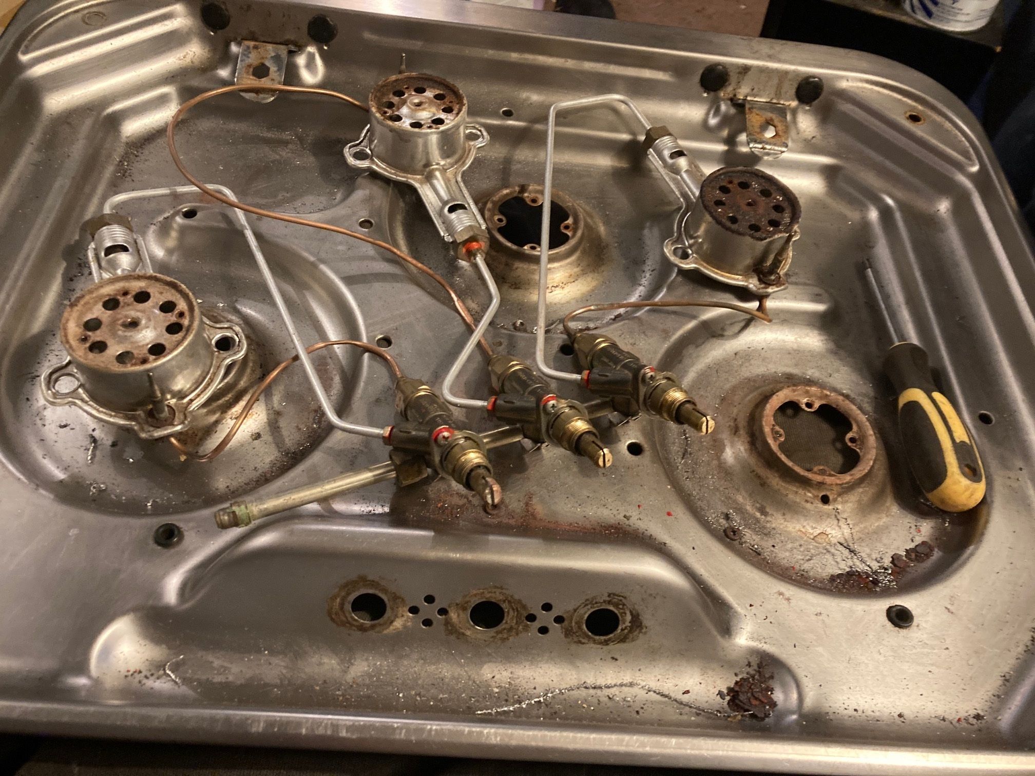

 Thanks for the additional thoughts. Btw, this is what it now looks like following an evening of dismantling it.
Alec
Looks in pretty good nick. Hopefully any individual parts you need are easier to come by.
