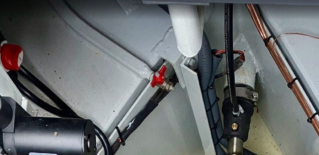

I don't have an inspection hatch, but I do have a drain at the bottom of the tank -- and before @Alan de Enfield pipes up, yes it's fitted with a stop valve and a plug according to ISO specifications... 😉
So did mine, but as the boat rimmed down by the stern, there was still a lot of water and emulsified fuel in there. That may have been caused by an emulsifying additive like Fuelset etc.
