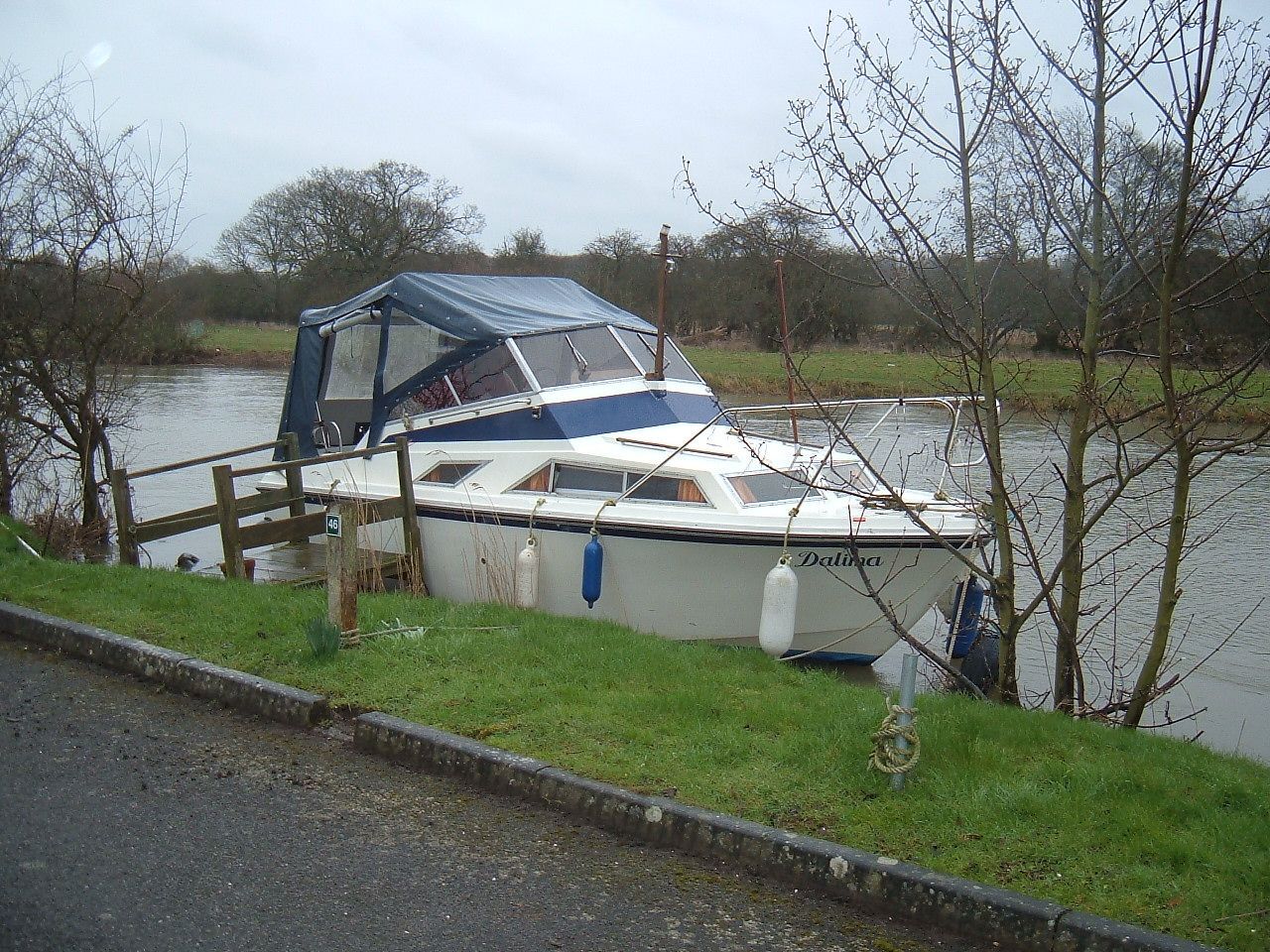

It looks very similar (apart from condition) to the 'early 80s'  Fairline "Weekender" I had on the Thames.

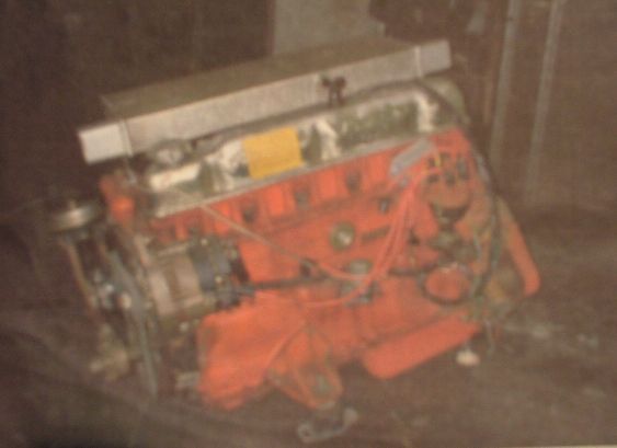

It is a petrol engine. No one in their right mind really wants an inboard petrol engine.  They are an explosion looking for somewhere to happen and cost a mint to run.
Taking on an  engine rebuild, on top of a total refit of the hull is, IMO, madness, unless you happen to be a skilled mechanic with your own workshop. Especially in this case because you have no idea of the state of the engine. Even if you are a mechanic,  doing the engine will get in the way of boatfitting, and vice versa.

If you check the guys other listings, he also seems to be selling the same engine for £500, same pics anyway.
How is he selling it if it's coming for free with the boat?

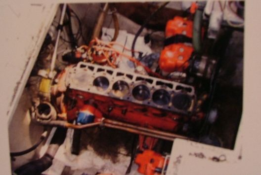

My Fairline (shown above) had a Volvo Penta Petrol engine and it had a total rebuild (takeout of the boat & stripped down to every last nut and bolt - and it wasn't in the state of the one the OP is looking at) It cost somewhere around £4000 (it was done before I bought it)
Petrol (either with an inboard or an outboard) is not ideal on the canals - some folks have petrol outboards and manage but they do give problems over and above those a diesel engined boat has.
The boat came with 100s of photos of the rebuild.

I wonder if the engine can be fixed whatsoever, its a volvo penta
Everything can be repaired.. It's just at what price.
I've never really understood how they pass safety inspections, if you can't store petrol or a suitcase generator in the inboard engine space of a narrowboat then how do these grp cruisers get away with a petrol engine in a similar space?
However, lots of boats do have inboard petrol engines and lots of people (in their right minds or otherwise) own them.
