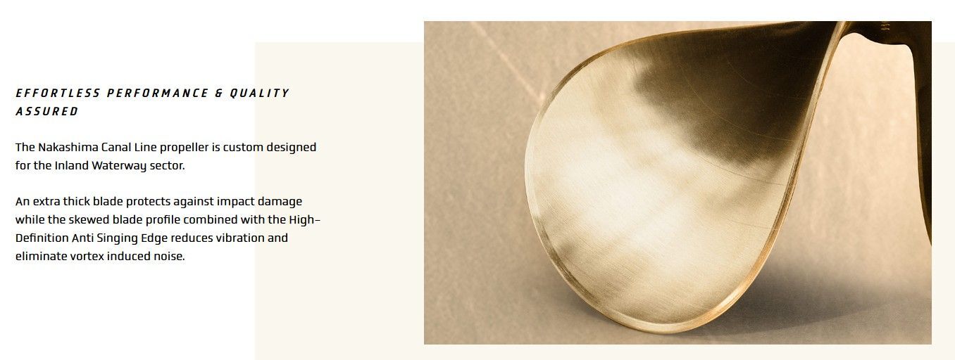

IanD Posted September 11, 2025 Report Posted September 11, 2025 6 minutes ago, nicknorman said: Well as I said earlier, sharpening the edges is the exact opposite of what needs to be done. We had prop singing when new, dry docked the boat, trailing edge blunted with a grinder, singing ceased. This was done by the builder. About 6 years later it recurred for some reason, just occasionally and not so bad. At the next blacking I took a grinder to it and blunted the trailing edge some more, so far so good. Opinions seem to differ on this -- commercial "anti-singing" props like these (used to be Michigan Marine) have ground edges, but it's not clear exactly *how* they're ground... https://nakashima.co.uk/leisure/canal/canal-line-propellers/ Looks to me like a thicker blade with the edges ground at an angle and then possibly some rounding of the resulting sharp edge. This is what's fitted to my boat, I'll have a look next time I'm there.
nicknorman Posted September 11, 2025 Report Posted September 11, 2025 3 minutes ago, IanD said: Opinions seem to differ on this -- commercial "anti-singing" props like these (used to be Michigan Marine) have ground edges, but it's not clear exactly *how* they're ground... https://nakashima.co.uk/leisure/canal/canal-line-propellers/ Looks to me like a thicker blade with the edges ground at an angle and then possibly some rounding of the resulting sharp edge. This is what's fitted to my boat, I'll have a look next time I'm there. It’s not really an exact science, but I think the main point is to have a blunt trailing edge that results in turbulent (chaotic) flow at the edge, rather than the trailing edge tapering to a sharp edge which results in vortices rather than chaotic flow. Gliders have the same sort of issue, on the underside of most modern glider wings is zig-zag turbulator tape a few inches forward of the trailing edge, its purpose being to force the laminar flow into turbulent flow rather than vortices, resulting in less drag.

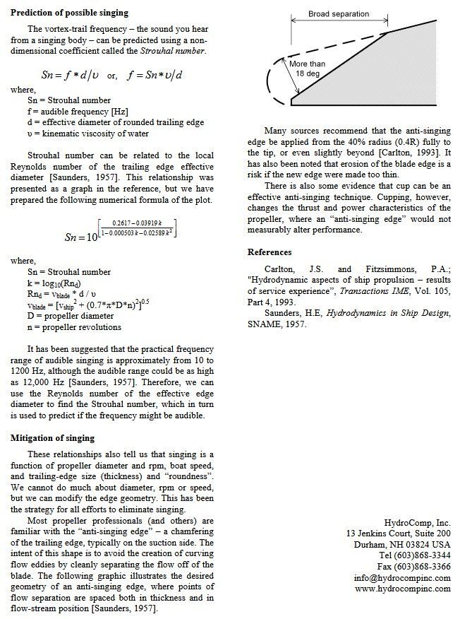

nicknorman Posted September 11, 2025 Report Posted September 11, 2025 Interesting article here: https://www.hydrocompinc.com/wp-content/uploads/documents/HC138-SingingPropellers.pdf
IanD Posted September 11, 2025 Report Posted September 11, 2025 (edited) 8 minutes ago, nicknorman said: It’s not really an exact science, but I think the main point is to have a blunt trailing edge that results in turbulent (chaotic) flow at the edge, rather than the trailing edge tapering to a sharp edge which results in vortices rather than chaotic flow. Gliders have the same sort of issue, on the underside of most modern glider wings is zig-zag turbulator tape a few inches forward of the trailing edge, its purpose being to force the laminar flow into turbulent flow rather than vortices, resulting in less drag. That's what they seem to be doing, the grinding angle is quite blunt, certainly much more so than a tapered edge would be with a blade that thick. 3 minutes ago, nicknorman said: Interesting article here: https://www.hydrocompinc.com/wp-content/uploads/documents/HC138-SingingPropellers.pdf The drawing in there looks very much like the Nakashima/Michigan propeller. Edited September 11, 2025 by IanD

Telstar Posted September 11, 2025 Author Report Posted September 11, 2025 3 hours ago, IanD said: That's what they seem to be doing, the grinding angle is quite blunt, certainly much more so than a tapered edge would be with a blade that thick. The drawing in there looks very much like the Nakashima/Michigan propeller. Interesting read. The Nakashima picture shows extensive bevelling to the rudder side of the blades. The hydrodynamic article doesn't state which face of the blade is modified. It does state "trailing edge" but that doesn't define which face. Andy
IanD Posted September 11, 2025 Report Posted September 11, 2025 (edited) 30 minutes ago, Telstar said: Interesting read. The Nakashima picture shows extensive bevelling to the rudder side of the blades. The hydrodynamic article doesn't state which face of the blade is modified. It does state "trailing edge" but that doesn't define which face. Andy It says "typically on the on the suction side", which I assume would be the front (leading) face. But as you say the photo seems to show the rudder side... Maybe it doesn't matter which face is bevelled (or both?) so much as having an obtuse angle not a fine trailing edge? Edited September 11, 2025 by IanD
