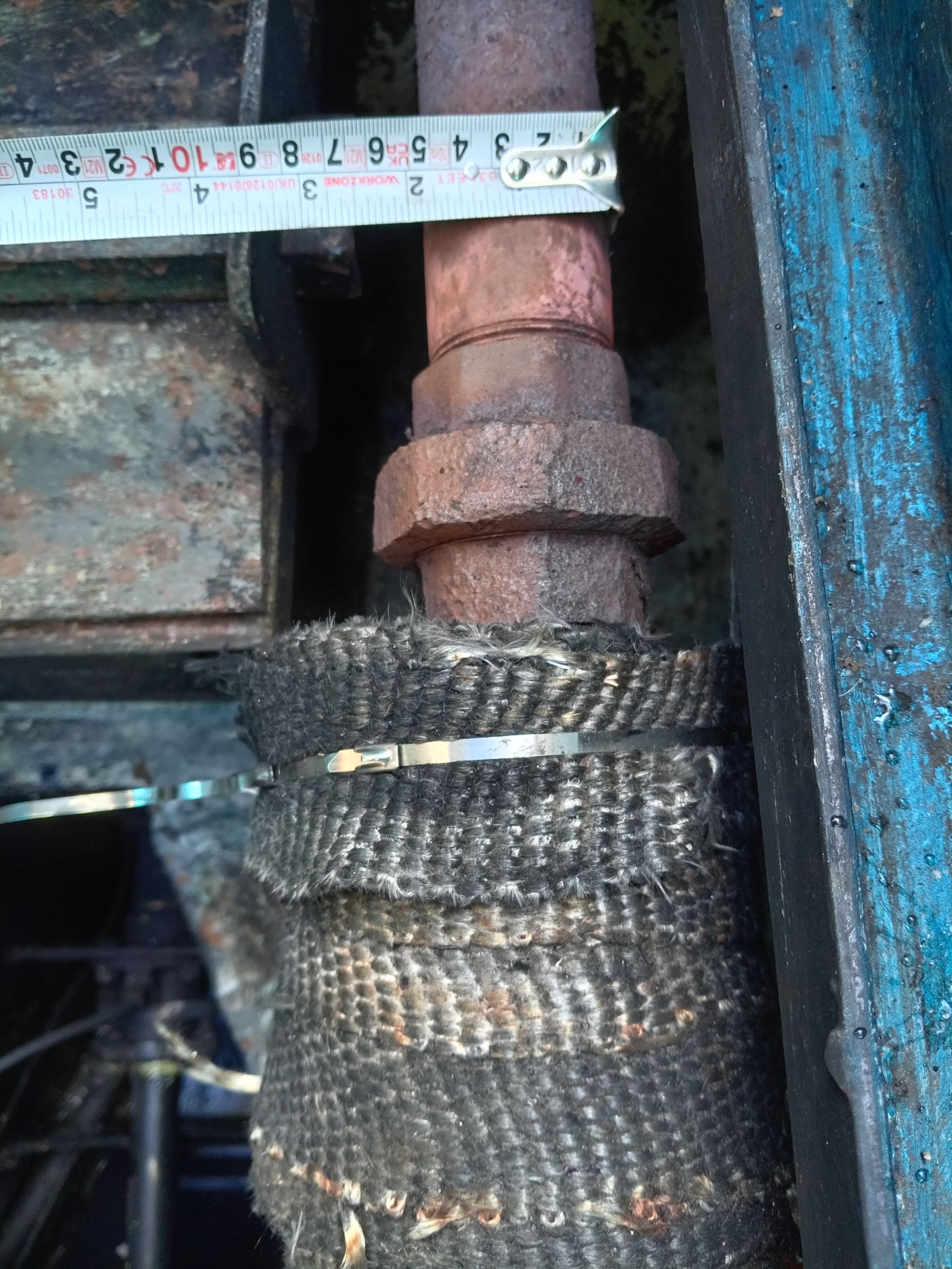

The Alchemist Posted September 22, 2025 Author Report Posted September 22, 2025 So. Here's the update on my engine racing issue. It took me a while to discover but the diesel lift pump was at fault. I've replaced it along with the fuel filter and bleed the system several times! before it finally started for me this morning. While the engine was down I also undertook an oil and filter replacement and replaced the air filter which I've been meaning to do for sometime. The engine seems to be running much sweeter for it too. 😊 Thanks for all your help and advice. My only issue now is with the exhaust back box which needs to be replaced as it's peppered with small holes. There's a slight problem there though as the existing box is 15" long and has a threaded inlet and outlet pipe which measures 2". I've visited Calcutt boats and they only have a 15" box which has either a 1" inlet and outlet for around £23 or a 1.5" inlet and outlet for around £125, but they tell me there isn't a 2" 15" box . Anyone able to offer advice as to how I can find one or direct me to somewhere I could get adapters to enable me to install either of what's available!
Tony Brooks Posted September 22, 2025 Report Posted September 22, 2025 (edited) I think that you might be confusing pipe outside diameter with the BSP size such things are measured in. for 1.5" BSP Google gives this 1-1/2 Inch BSP. 47.80mm, which pretty much matches up with your photo. However, I would have expected Calcutt to realise that, it is something we run across all the time on here. LGQ who own Aquafax, Midland Chandlers and I think ASAP list one, 1.5" BSP and 15" long, but no price, one from Parts 4 Sale is a bit cheaper than Calcutt, including delivery. Edited September 22, 2025 by Tony Brooks
Kingdom Isambard Brunel Posted September 22, 2025 Report Posted September 22, 2025 Its definitely 1.5"BSP threads. There is a table on the web with the outside sizes and the BSP size corresponding. You will have great fun undoing the rusty union and the threads. The best way is to get them very hot, like red hot, and then fast cool the pipe not the threaded pipe unions with a wet cloth. Then big Stillson wrenches and lots of muscle power.
