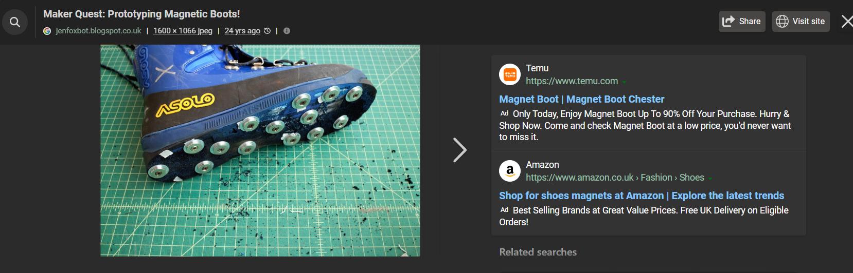

#7
2 hours ago, beerbeerbeerbeerbeer said:
Magnetic boots are the way forward
