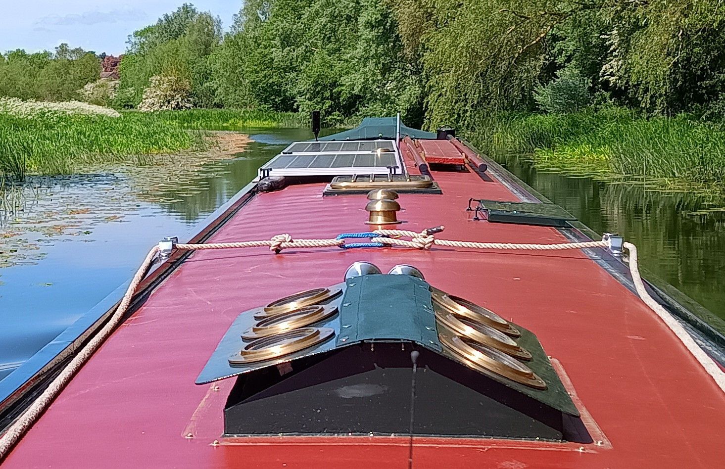

Bowlines shown with soft shackle to allow two ropes on a small eye with no paint scratching.

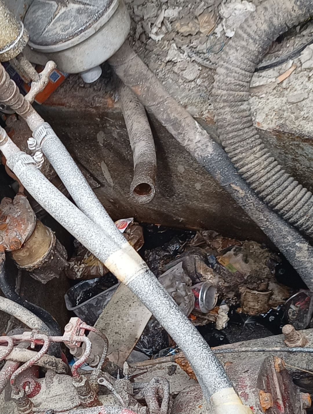

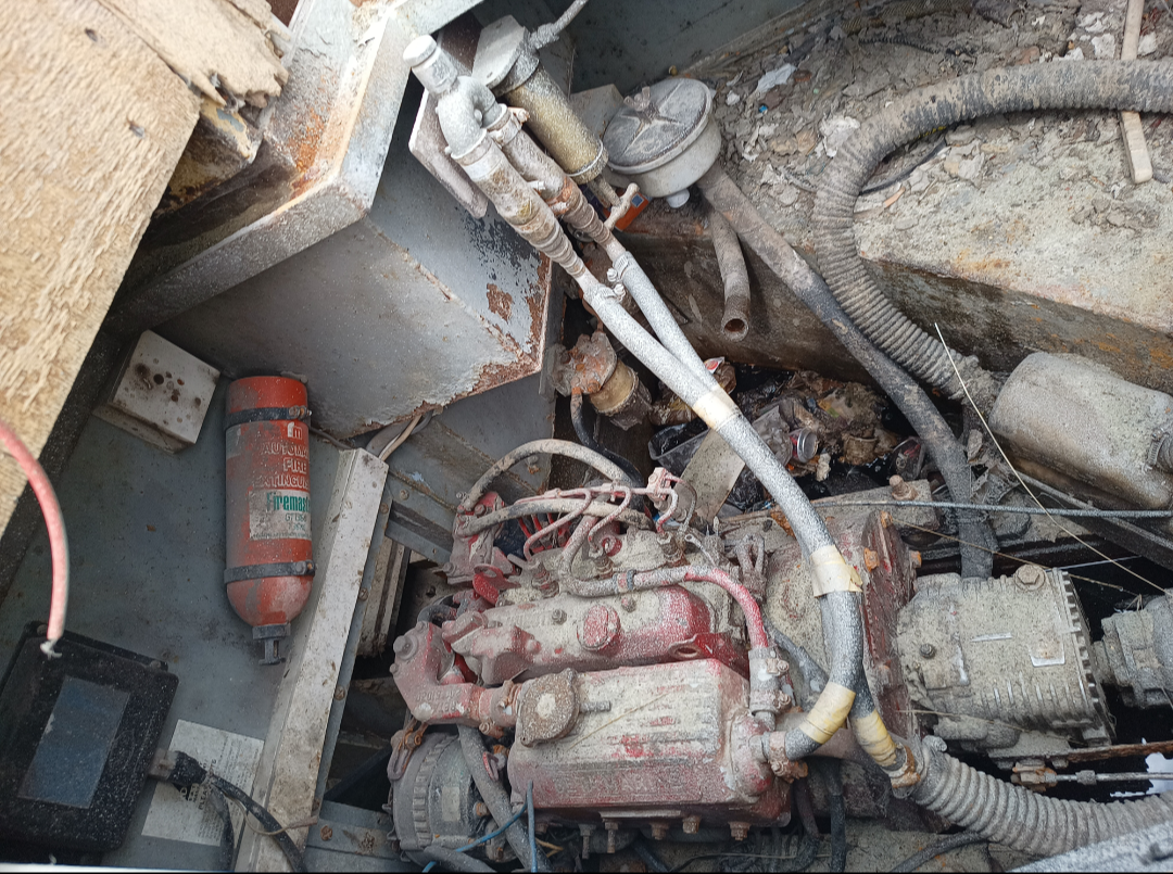

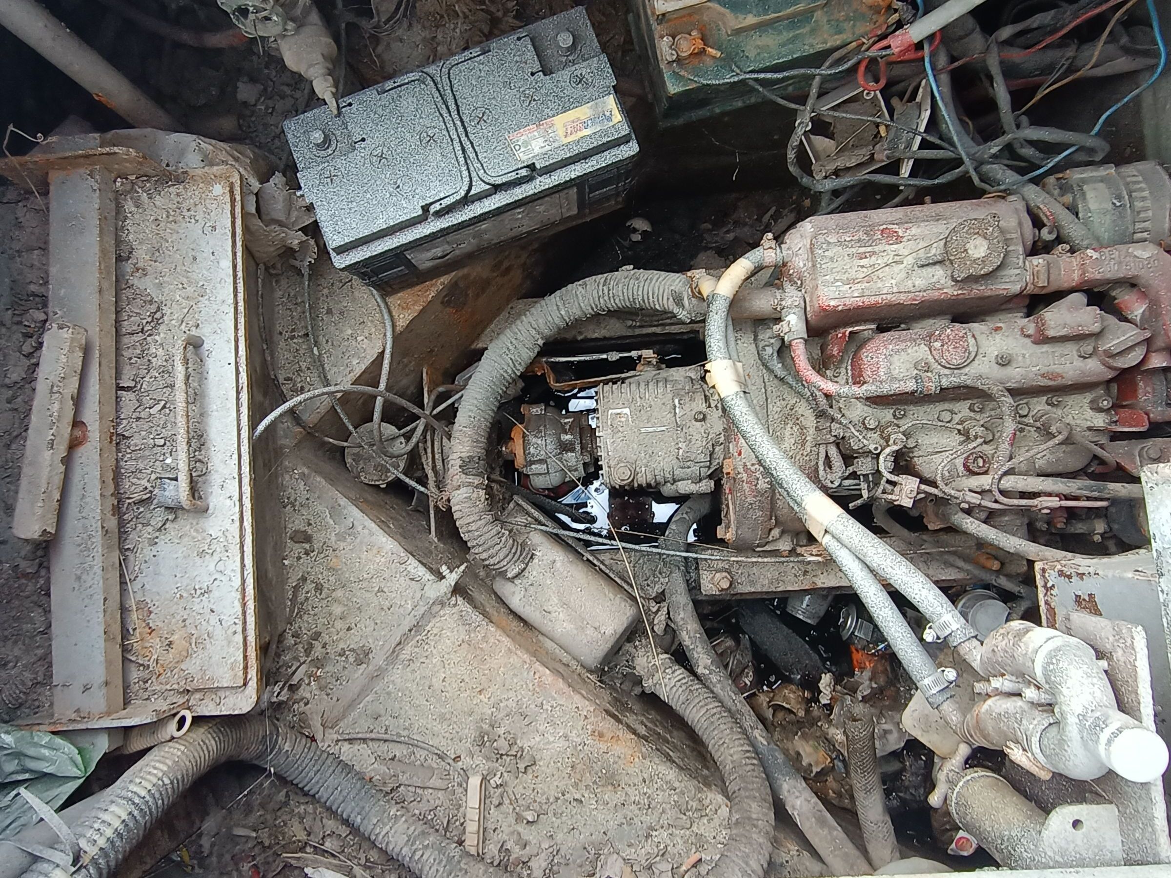

An update:
Well. I've just had three days on the boat.
The first day I spent digging out the disgusting 8" of canal mud and other assorted filth from the engine bilge, using my stove shovel, a pot noodle tub (they were better when they were plastic), and my bare hands, depending on the access I had.
Pleased with the progress on it. I can now see red floor paint...
I felt I had to dig it all out before I could start fettling the engine, so now when I go next week I can crack-on with bleeding the fuel system through, changing oil and filters, etc.
I'm thinking I should at least inspect the raw water pump impeller and the fuel pump impeller before I try to run the engine?
Also I'm on the hard, so I need to rig up some sort of fake raw water input, maybe from an iso bulk container of oil drum?
Yesterday I was boarding-out someone else's boat, which was hard and onerous, because I had to walk about 50m to my boat every time I wanted to make a cut, because I didn't have a round 240v to domestic 240v adapter for my generator, so I had to put it through my boat into an extension lead (I suppose that makes my boat into a giant adapter), but anyway, it earned me 3 antique brass mushroom vents, which I require, as the flying saucer vents from my boat were destroyed during their removal for grit blasting ,so that's a good saving.
This morning i blacked the swim of my boat with Jotun 2 pack, as it was still bare steel. I'm thinking I'll go over the rest of the hull with it, as it's been done a bit thin, in my opinion.
8 minutes ago, Shandybass said:
Pretty grim before
Red floor!

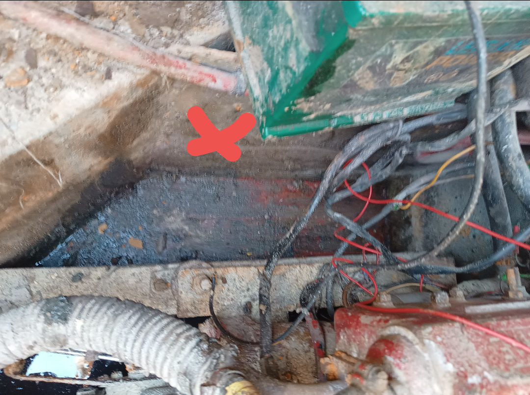

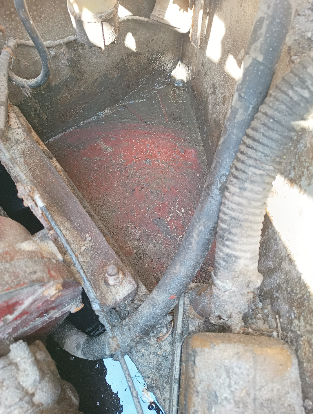

The port side of the bilge has this steel plate welded to partition it - some sort of open topped keel tank? Any ideas?
Anyway, that still has the 8"of mud at the bottom, which is going to be a contortionist job to remove!
Edited by Shandybass
Does that correspond with the holes you found on the swim?

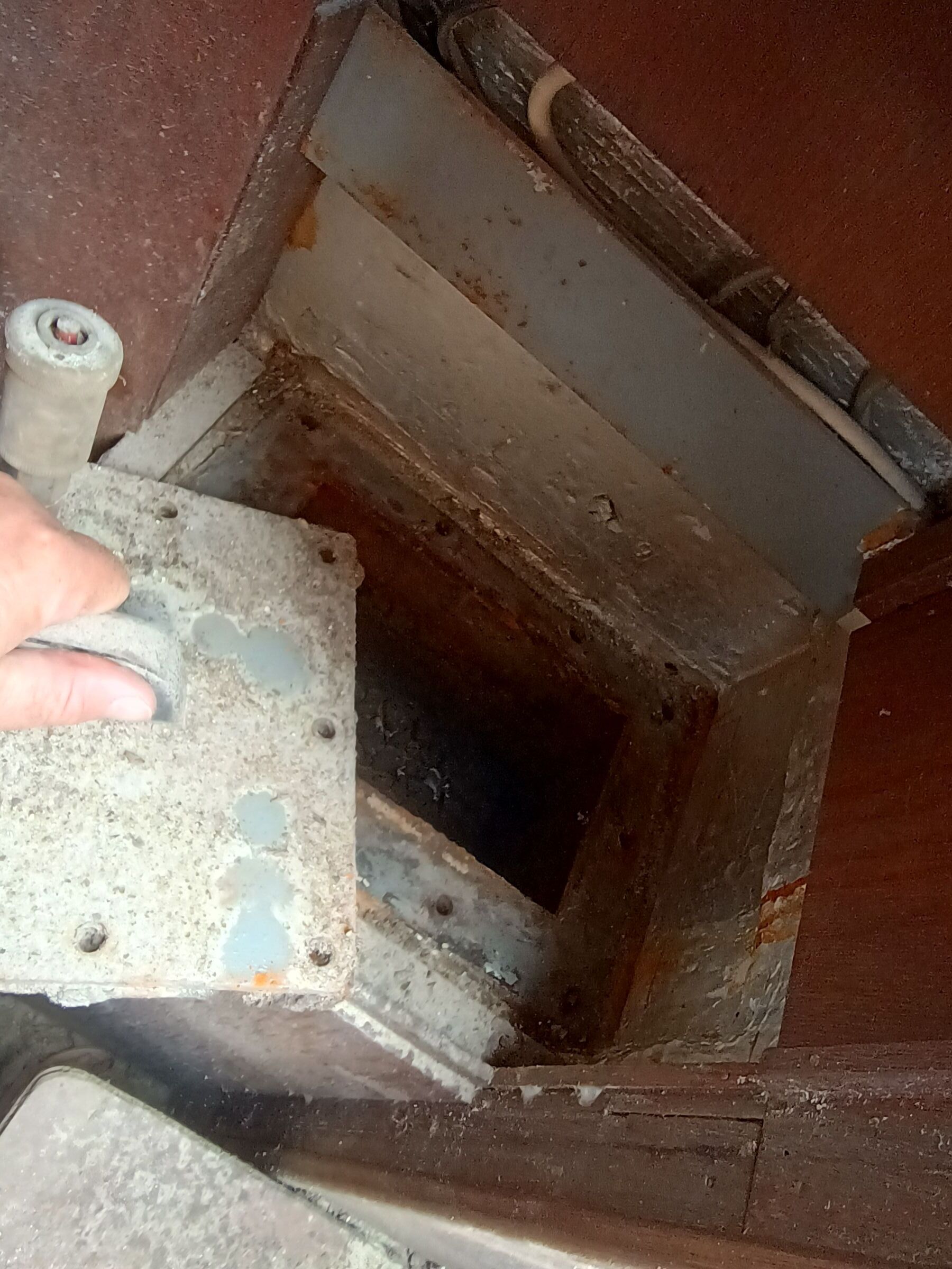

No, they are on the starboard. They are the inlet holes for the mudbox (pic of inside attached)

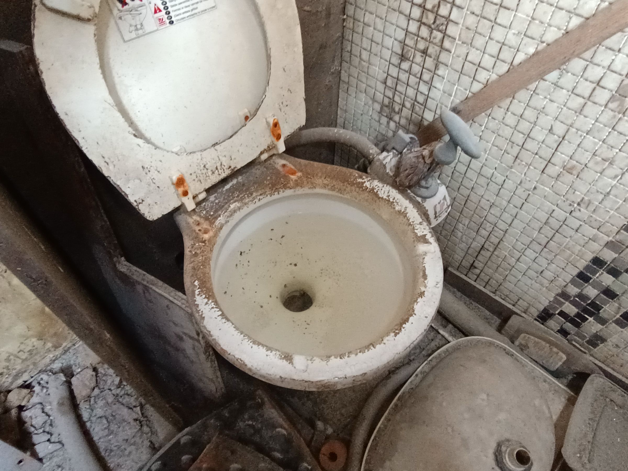

It turns out the toilet flush is also fed from the canal water via the mudbox
Lovely

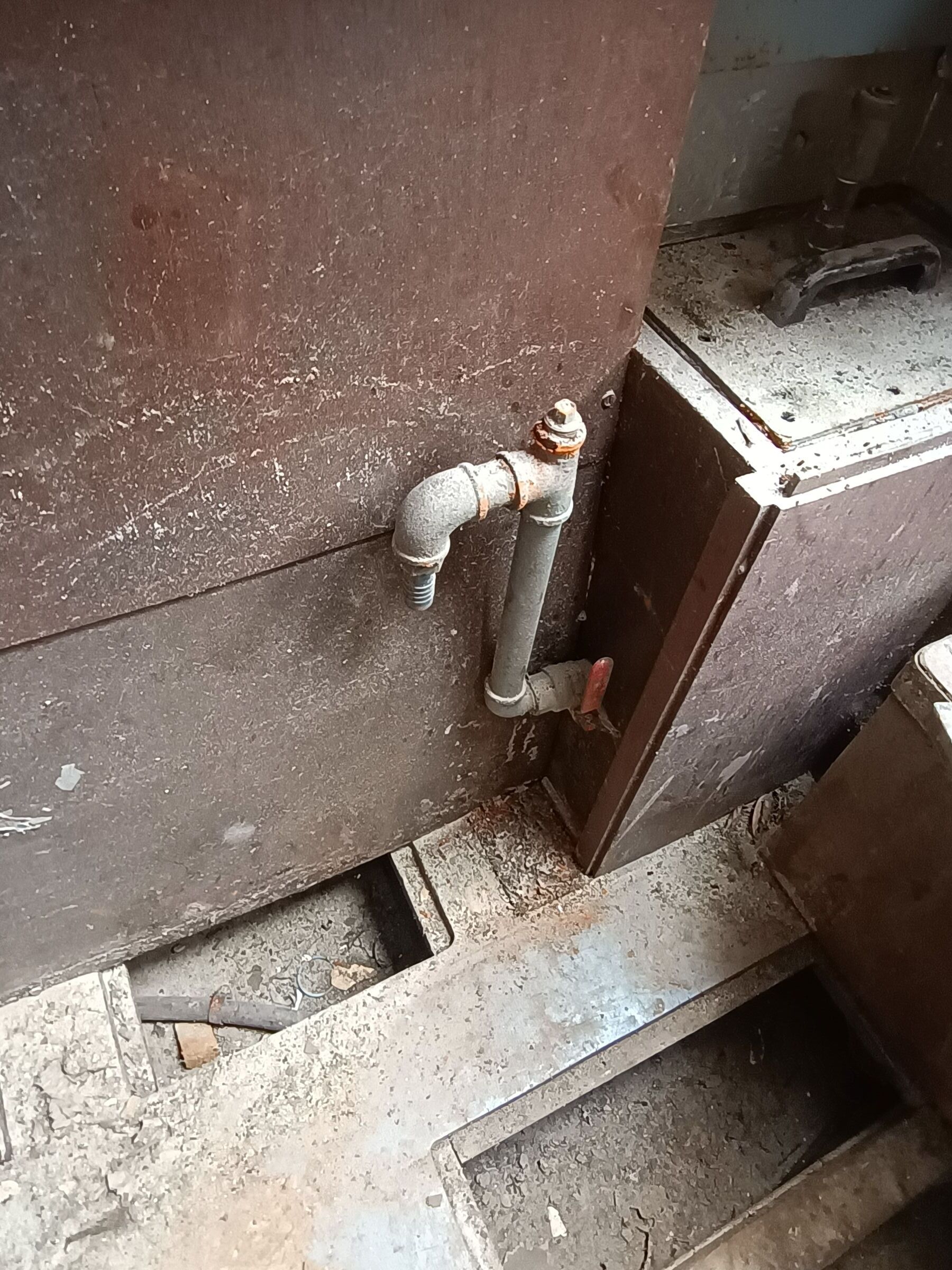

So I haven't investigated it fully yet, but I think this pipe comes from the mudbox, then a hose pushed onto the tail, and feeds under the deck boards into the bathroom to supply the toilet flush. Not sure yet if there's a pump before the toilet, or if the macerator pulls water through.
