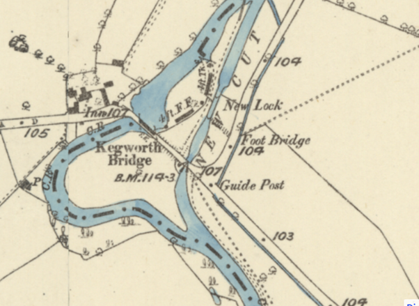

Did Kegworth Shallow Lock ever bypass a weir? This extract from the 1850s six inch map suggests not
In which case one wonders why they built a lock?
Interestingly the maps refer to this as New Lock and Kegworth Deep as Old Lock, so presumably it was a later addition
No, there was no wier on that section of river, BUT the wier by the Old Lock was extended to include the Plaster Mill stream once that shut down to increase water capacity.
The Old lock was moved Eastwards at the same time..straightening the lock cut and is about 2 feet higher than the old OLD lock.
Ratcliffe Lock was moved at a similar time.
Edited by matty40s
There does appear to be shallows just above the river bridge which the new lock and canal would ave avoided. The sharp bend could also have created difficulties in lining up for the bridge.

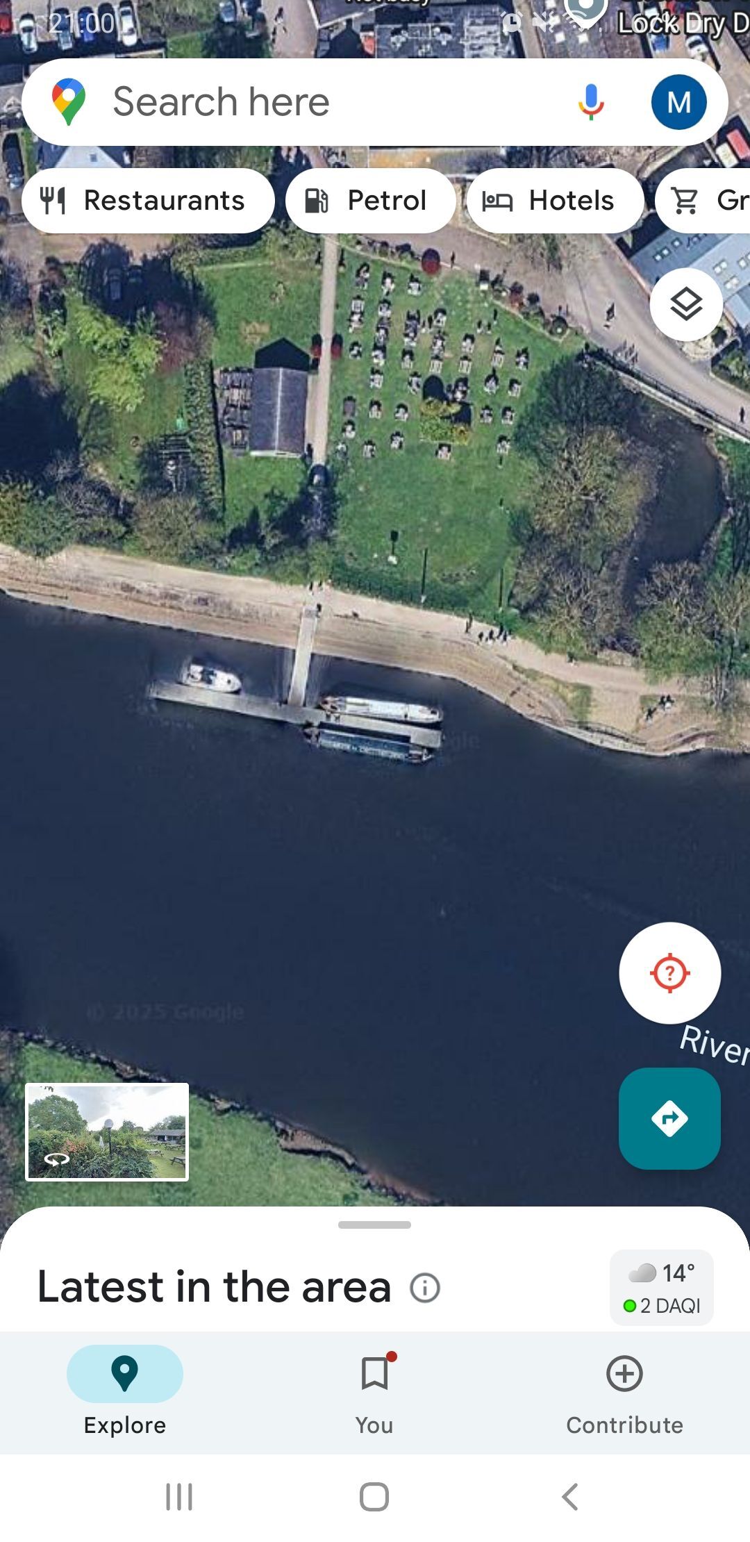

On 29/09/2025 at 11:31, PeterScott said:
AM-JKLVb_K7P61bypRcsj4sSlNk_Gp05WWAD_wdv
As in this picture! 🫢
From memory I went through in April and the gates were closed - it has a fall of about an inch. I could of opened them both ends but felt it wasn't my place to do so.

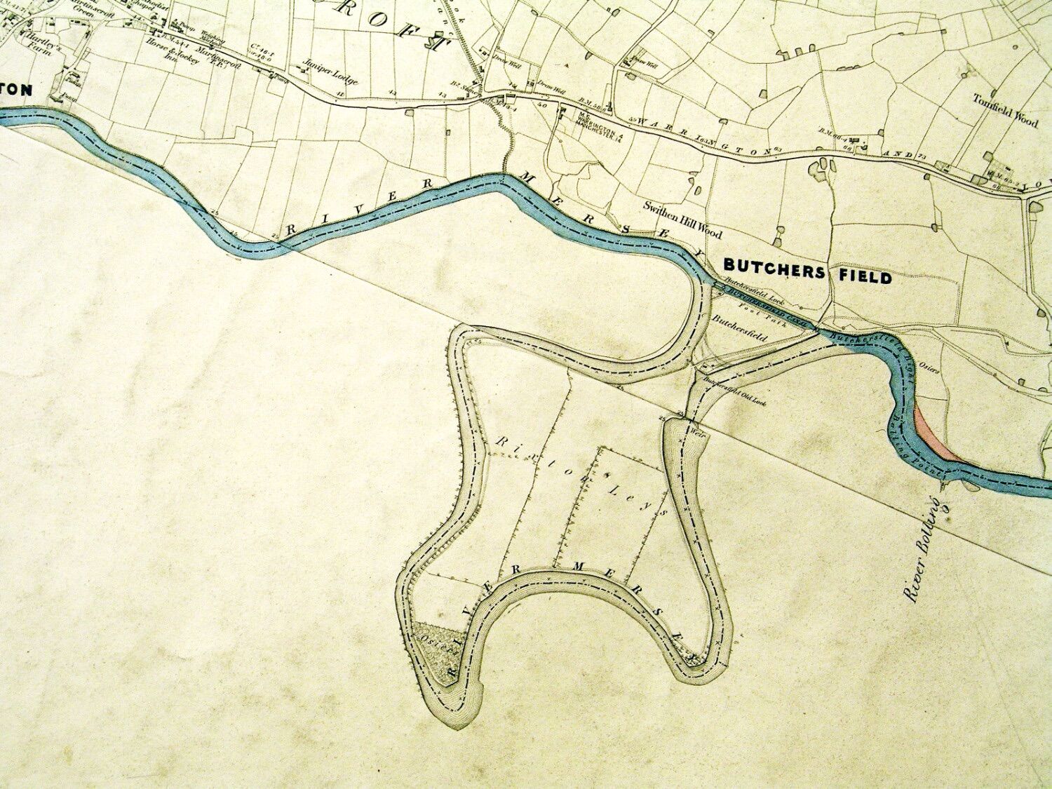

I'm aware of other locks where there was no weir on the section of river bypassed - Butchersfield on the Mersey and Irwell had a fall of around two feet - but they weren't common, more often a simple bypass channel would suffice and 100-200 years on it's often not easy to tell that this channel isn't the river.
Butchersfield was to cut off a huge loop in the river - little more than the length of the lock saved around 2 miles IIRC, and the flow through the cut would have been excessive given the gradient. The locks were removed along with much of the loop when the ship canal was built, and now only the short cut remains - it's straightness giving away that it isn't natural

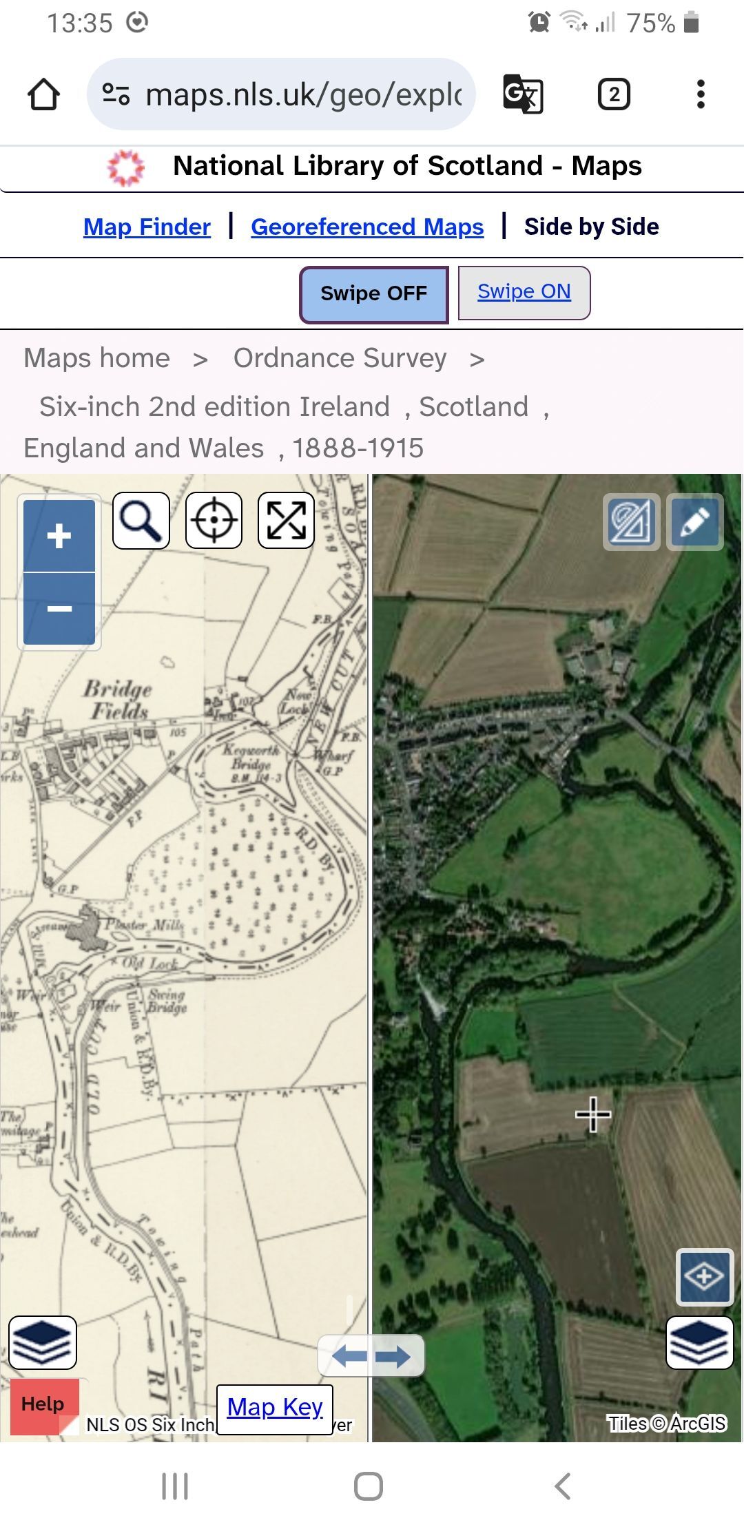

Looking at the aerial view on Google maps. Butchersfield did have a weir, as marked on the 1849 OS map, which also shows that a new lock had replaced an older one, close to the weir. The old lock site seems to have been made into a weir subsequently.
I think it was the old lock site I had in mind before the new larger one was built
The new locks were built around 1828, and OS maps suggest the old lock was converted into a flood channel between 1873 and 1891, with the upper end of the meander being cut by infilling between the old lock and the old weir.

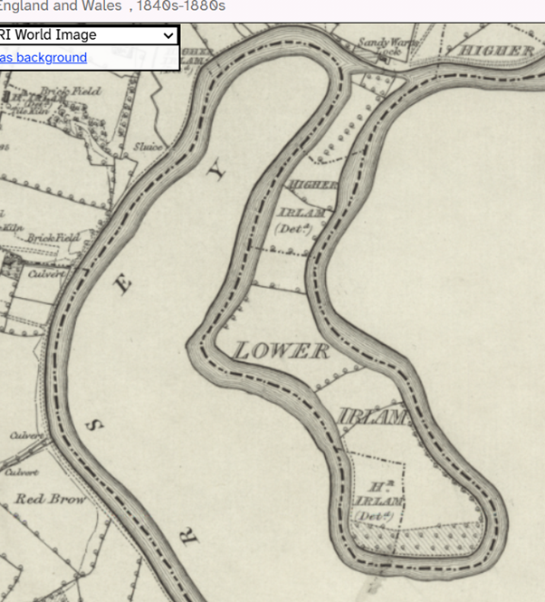

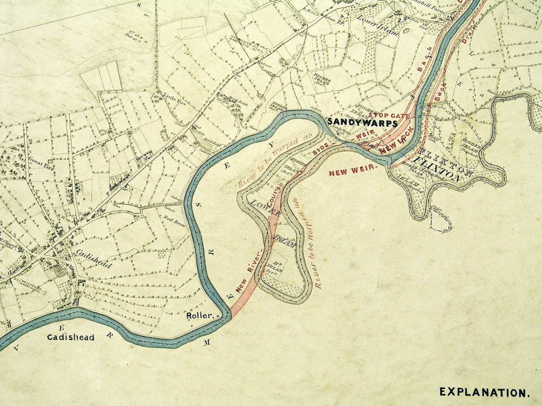

Further to the above, and having just explored that navigation on NLS Maps, I think I had the wrong lock - was it Sandy Wards Lock on the M&I? 1850s 6 inch plan below
8 hours ago, magpie patrick said:
Clearly I am, at best, relying on incorrect information and at worst misremembering things - my source is a talk on the M&I I went to a couple of decades ago where I'm reasonably certain the speaker said that Butchersfield Lock was added later as a short cut and had no weir, just the gradient of the river. I'm reasonably certain as it wouldn't occur to me to invent something like that - it is so unusual, but I may have the wrong lock, the wrong navigation, or (just possibly) be misremembering what he said - it is plausible for example that the lock was built and the weir then added, and I didn't hear, or didn't remember, the second bit
Initially constructing a new (short) Lock Cut and Lock, at Butchersfield or anywhere else, without a new weir to replace the first/original one, is and would have been the most practical, and obviously the lowest cost way of making this particular improvement to the Navigation, . . the try it, initially with the minimum cost outlay, and see how it works approach.
However, my own experience and first hand observations on a great many different River Navigations, of the effects of Cuts, with or without Locks, constructed primarily for the purpose of distance shortening and/or navigational imrovements, is that there is/was always an increase in silting and shoaling at the points where the new cut leaves and rejoins the existing or orginal course of the River.
A new Cut with new Lock, but initially no new weir, . . then new weir added later, dependant on the rapidity and/or severity of any new problems occuring with siltation and shoaling, . . is the order in which I would expect improvents and new construction to have taken place.
Edited by AKD
Patrick, you need new glasses as well!!! The name is Sandywarps, as the OS map annotated with the 1849 scheme for improvement shows. Just the sort of name you would expect for a meandering section on a flood plain. This section is almost level, with not enough fall for a water mill, and Steers, in his first plan for a navigation in 1721, did not have a lock between Warburton and Holmes Bridge. The later improvements were to straighten the river and to dredge it to increase carrying capacity. There was much discussion around how the increased rate of flow in the river would affect the Mersey below Runcorn, and thus the port of Liverpool.
