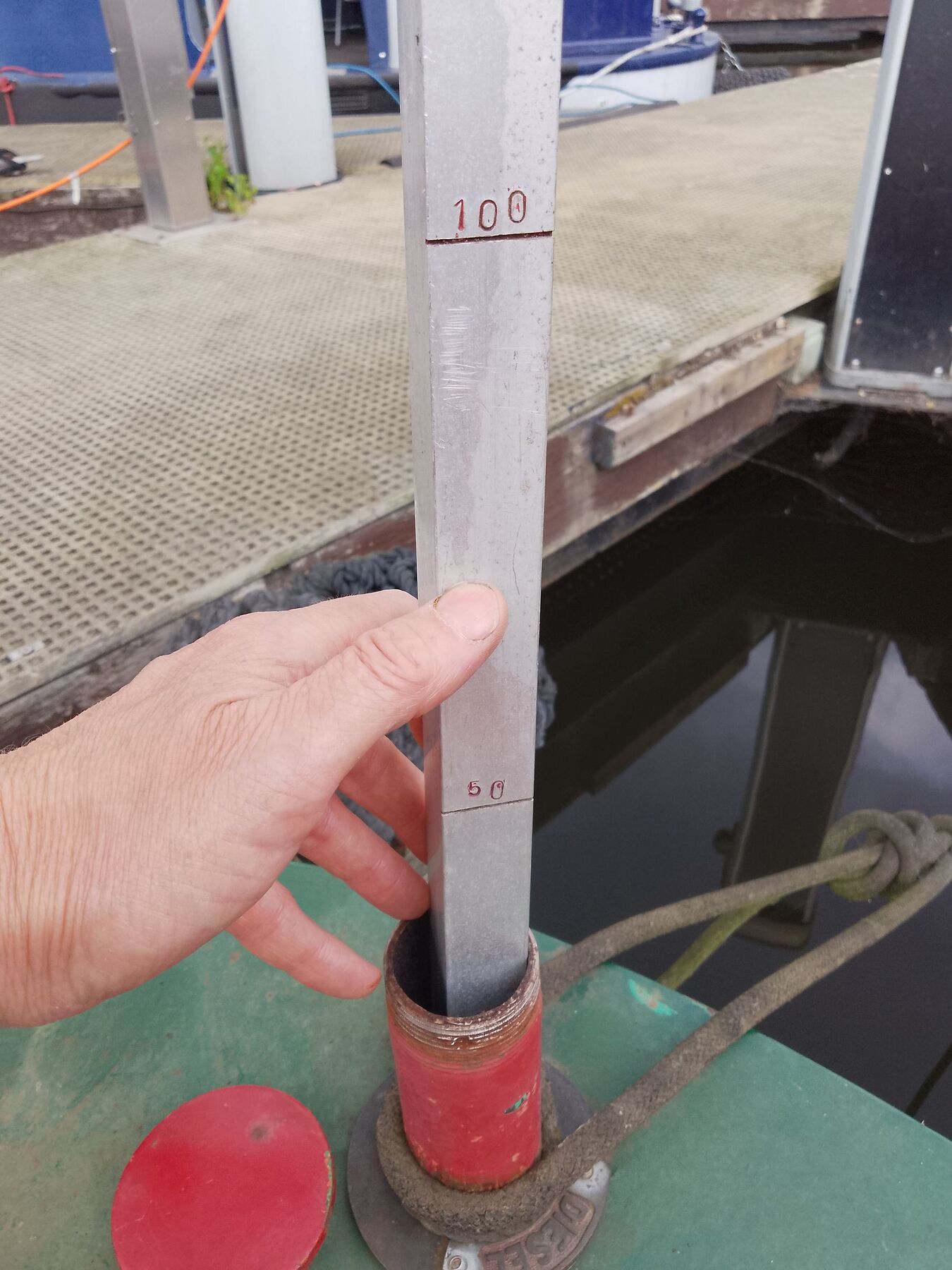

Jen-in-Wellies Posted July 13, 2025 Report Posted July 13, 2025 1 hour ago, blackrose said: the person (like me) who uses a dipstick but rarely actually uses it because of the hassle of finding it, dipping it, wiping the diesel off and putting it away. In my case I hate getting diesel on my hands so I'd put on some latex gloves first too. I have mentioned this before, but it has been a while, so time for a repeat. My dip stick is calibrated from the top of the tank to the diesel surface, rather than from the bottom of the tank filler neck to the diesel surface. That way, the stick doesn't have to be dipped to the bottom to find the volume of diesel in the tank. To use it, I slowly lower the stick in till I see it just touch the surface, then read the volume from the stick. In my case, this is the litres needed to fill up to the top. Subtract from 225l and that gives the volume in the tank. This way means only a tiny drip of diesel is on the tip of the stick. The rest remains dry. In this picture, the tank is nearly full. Perhaps 30l from the the top.
PeterF Posted July 13, 2025 Report Posted July 13, 2025 I have fresh water, black water and diesel gauges from MCS. However, these are voltage based senders and to get them on the Cerbo GX you need the Victron GX Tank 140 accessory. The other thing you might he able to do for fresh water if you can access the top or bottpm of the tank is a Mopeka Bluetooth sender, but these need to be close to the cerbo as Bluetooth does not travel through steel bulkheads, or use a Bluetooth dongle on an extension USB cable. https://www.mcsboatproducts.co.uk/ https://mopeka.com/shop-our-products-mopekaiot/
Kingdom Isambard Brunel Posted July 13, 2025 Report Posted July 13, 2025 1 hour ago, Jen-in-Wellies said: I have mentioned this before, but it has been a while, so time for a repeat. My dip stick is calibrated from the top of the tank to the diesel surface, rather than from the bottom of the tank filler neck to the diesel surface. That way, the stick doesn't have to be dipped to the bottom to find the volume of diesel in the tank. To use it, I slowly lower the stick in till I see it just touch the surface, then read the volume from the stick. In my case, this is the litres needed to fill up to the top. Subtract from 225l and that gives the volume in the tank. This way means only a tiny drip of diesel is on the tip of the stick. The rest remains dry. In this picture, the tank is nearly full. Perhaps 30l from the the top. How do you tell when it is just touching the surface?
Jen-in-Wellies Posted July 13, 2025 Report Posted July 13, 2025 5 minutes ago, Kingdom Isambard Brunel said: How do you tell when it is just touching the surface? Try it. When the stick touches the surface a wave is sent out across the diesel surface that is easy to see when looking down the roughly 2" filler pipe on my boat. There is a minimum BSS size for fillers, so yours won't be much smaller.
nicknorman Posted July 13, 2025 Report Posted July 13, 2025 1 hour ago, Jen-in-Wellies said: I have mentioned this before, but it has been a while, so time for a repeat. My dip stick is calibrated from the top of the tank to the diesel surface, rather than from the bottom of the tank filler neck to the diesel surface. That way, the stick doesn't have to be dipped to the bottom to find the volume of diesel in the tank. To use it, I slowly lower the stick in till I see it just touch the surface, then read the volume from the stick. In my case, this is the litres needed to fill up to the top. Subtract from 225l and that gives the volume in the tank. This way means only a tiny drip of diesel is on the tip of the stick. The rest remains dry. In this picture, the tank is nearly full. Perhaps 30l from the the top. Never thought of that before, it’s a great idea. Well it would be if you have a tank like yours. Our tank is under the engine with a long flexible and slightly curving filler pipe from gunnel to the tank. Which is why we have an electronic gauge!
Jen-in-Wellies Posted July 13, 2025 Report Posted July 13, 2025 1 minute ago, nicknorman said: Never thought of that before, it’s a great idea. Well it would be if you have a tank like yours. Our tank is under the engine with a long flexible and slightly curving filler pipe from gunnel to the tank. Which is why we have an electronic gauge! Yes, it only works if you can see the diesel! However that applies to most narrowboats and widebeams with integral steel stern tanks.
