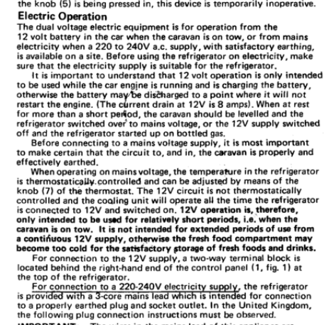

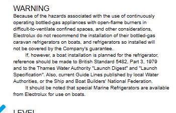

54 minutes ago, AJLElectronics said:
Why are three way 'fridges not used on boats, like they are on caravans?  Running on Propane works very well.
1) The manufacturers state they are not suitable for boat usage (so the likes of insurance companies and the BSS get twitchy)
2) The 12v side is not thermostatically controlled so use something like 160Ah per day as they run continuously and draw 8amps ( the manual actually states that for a caravan it should be disconnected / switched off) if you park the car (go to services etc) as you may be unable to start the car on your return.
3) The latest BSS regs  ban their use on petrol engines boats (see section 8:2)

Manufacturers advice is that they cannot be used in boats. So you cannot install them in accordance with the manufacturers instructions, and that could be a problem if you ever have to claim on your insurance.

A 3-way fridge on 12v does draw a continuous 8 amps according to the owners manual.
However a quality, designed for boats, 12v fridge only uses ~ 28-30Ah per day which is why I changed mine over.

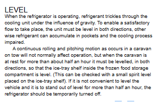

But also tend to react badly (stop cooling) if they go much out of level, which is why Electrolux used to supply a levelling spirit gauge with a new fridge. I understand the way the fridge is leaning has different degrees of effect.
Says he, who had an email from France asking why the fridge had stopped working, and it turned out the son's motor home was parked on a slope.
As explained in the owners manual ..........................
