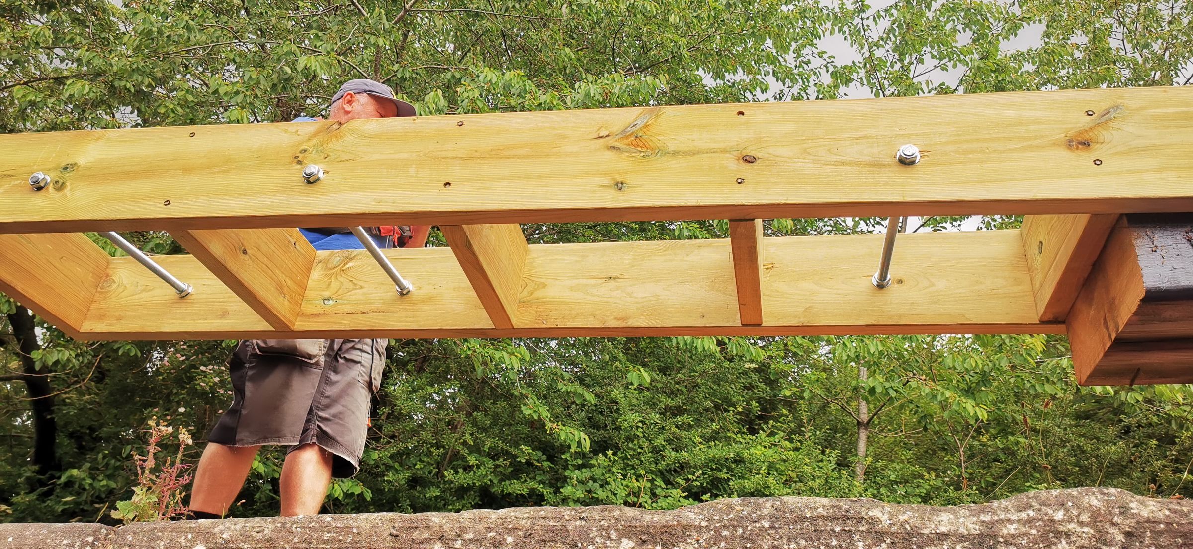

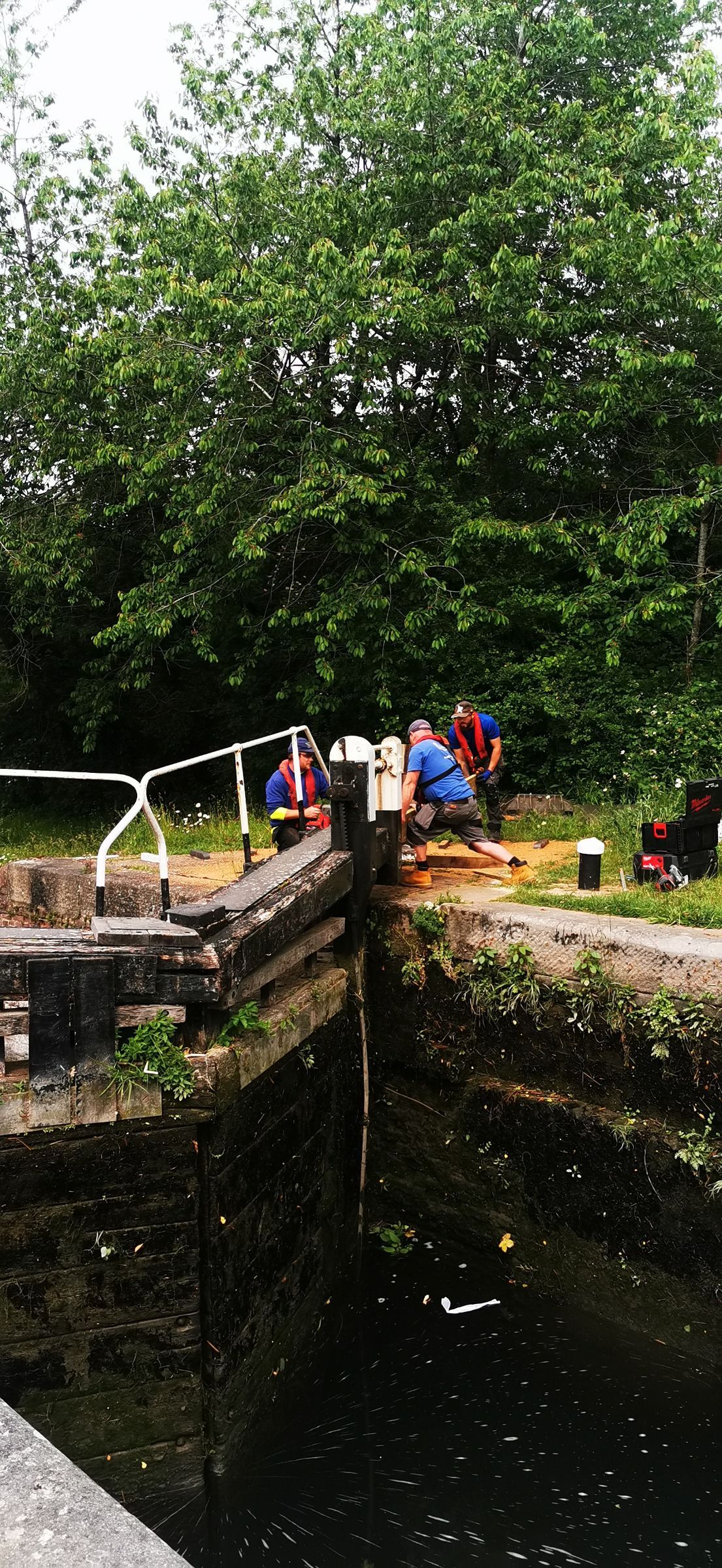

2 hrs from start to finish the replacement beam with the skeleton frame. On lock 43 on the grand union. Took longer to get the van and materials and tools to the job. Well done CRT. The number of locks on this stretch with this temp fix is quite considrible.
That is all very good but one idly wonders if it is called a 'balance beam' for a reason. I do not know anything about it but it seems plausible that the weight of the beam itself helps to counteract forces elsewhere so putting on a lightweight lattice type thing while making the lock useable is causing unseen problems which could turn out to be more serious than a piece of wood.
Edited by magnetman
There are lots of temp beam fixes on this stretch. Going to be a costly job to replace all the temporary fixes at some point. Maybe they will fill them with concrete to get a few more years out of them 🤣
I suppose one advantage is less damage to the gate anchors when someone opens the paddles before the gates are closed.
The old GU composite gates with steel beams were terrible for that.
But yes trouble is ahead with these scaffold board repairs. It does not seem to be hardwood.
I suppose at some stage new gates will be put in.
I reported over 20 between Brentford and MK last Summer.
