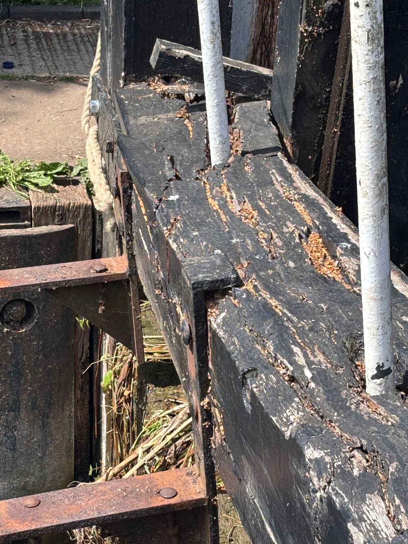

"Due to a boat strike of the bottom gate the balance beam has been broken meaning the lock is not safe for use and locked off accordingly."
What I suspect they meant to say:
"Due to it being old and extensively rotting, the balance beam was not strong enough to withstand a boat strike."
Surely the balance beam will swing free if the gate is struck. The only way in which the beam could fail in a strike is if it is rotten and the shock/vibration is the proverbial straw....
It's 2 or 3 years since I was on the Oxford and if this gate is in the same state as lots of the others, then maybe the lock operatives had a lucky escape, if the fail had occured when opening or closing the gate in the normal way.

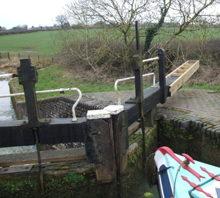

I find it interesting that the principle of beam temporary repair has moved on from the Armco crash barrier used on the Oxford to the varying lengths of angle iron and big bolts used on the Trent and Mersey and Staffs And Worcs, which apparently is standard equipment in what is left of CaRT response vans.

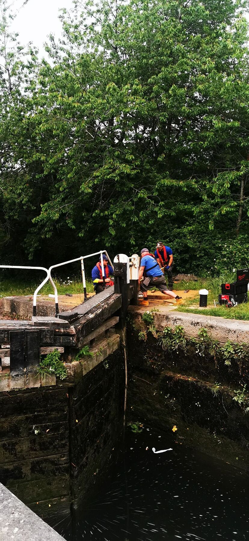

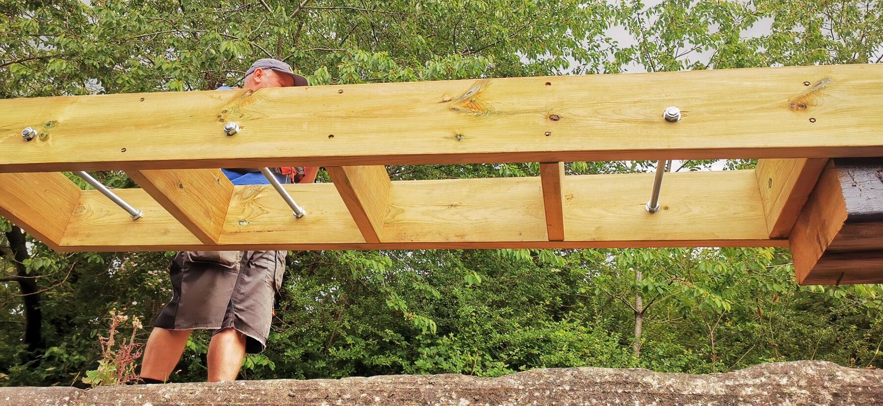

2 hrs from start to finish the replacement beam with the skeleton frame. On lock 43 on the grand union. Took longer to get the van and materials and tools to the job. Well done CRT. The number of locks on this stretch with this temp fix is quite considrible.
That is all very good but one idly wonders if it is called a 'balance beam' for a reason. I do not know anything about it but it seems plausible that the weight of the beam itself helps to counteract forces elsewhere so putting on a lightweight lattice type thing while making the lock useable is causing unseen problems which could turn out to be more serious than a piece of wood.
There are lots of temp beam fixes on this stretch. Going to be a costly job to replace all the temporary fixes at some point. Maybe they will fill them with concrete to get a few more years out of them 🤣
I suppose one advantage is less damage to the gate anchors when someone opens the paddles before the gates are closed.
The old GU composite gates with steel beams were terrible for that.
But yes trouble is ahead with these scaffold board repairs. It does not seem to be hardwood.
I suppose at some stage new gates will be put in.

A boaters gear box failed on entry to the lock so they couldn't reverse to slow down meaning they hit it going at a pretty decent speed... it doesn't help that the gate was old and overdue a replacement.. there was even a little nest of bees living near to the lock for a short while that were seen 'chewing' the wood away from the balance beam, most likely leaf cutter bees... Grants bottom gate often gets debris like sticks and boat fenders stuck behind it and with folk forcing their way though it was always going to have something happen to cause a closure... at least now the gate will be replaced sooner rather than later... might even make it easier to single hand though it next time. 😂

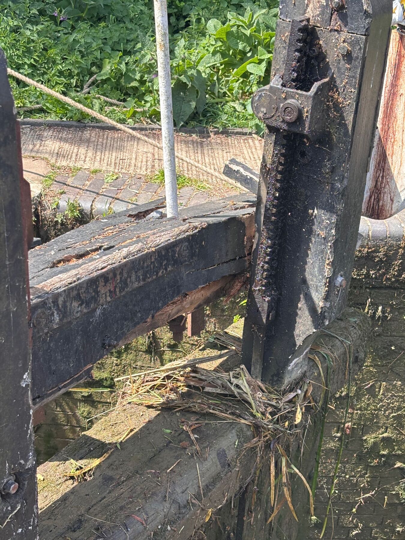

Update on today at Grants Lock.  When CRT started the assisted opening at 10am, there were 10 boats waiting to come down and 15 or so waiting to go up.  We were no 4 going up and left the lock at 11.35.  CRT closed the lock at 12.30 yesterday & the day before.  Those at the end of the queue will be lucky if they get through tomorrow.  So expect two nights in the queue if you join it today.
The top beam of the lock is smashed in two or three places.  Will take a while to repair when that starts!  CRT are pulling boats in & out with ropes and opening & closing the gate with ropes as well.
