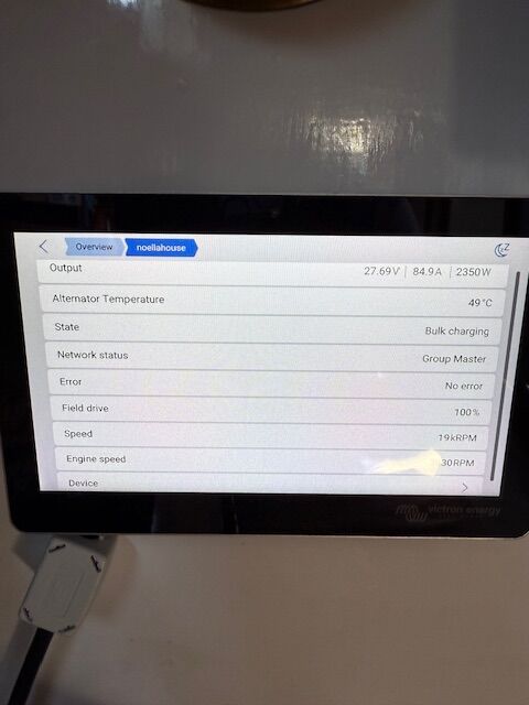

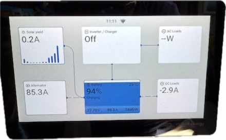

Davidgabriel Posted June 15 Author Report Posted June 15 (edited) Ok. So an update. Fitted the new brush box and it is charging beautifully. Only issue is. The wakespeed box on the cerbo shows no data. And I have a negative Dc load of 80 amps when in fact I’m putting charge in. Also the rpm sensor on the cerbo is 10000 too fast. At least it’s all charging though Edited June 15 by Davidgabriel Spelling
PeterF Posted June 15 Report Posted June 15 OK excellent news. Regarding your points 1. Cerbo GX data. Earlier you said you had an alternator box, so comms were good, presume this remains the same but you have no current measurement data. To get the alternator current you need a shunt to measure the alternator current, bit your description did not include one. You need another dumb shunt to measure the alternator current and connect the WS500 shunt wires to this and swap the shunt setting from battery to alternator. Then you need to tell the WS500 to use the SmartShunt. The setting "Alternative CAN / BMS protocol" must be set to Victron SmartShunt. 2. You have a negative DC load which is a charging current. Because the Cerbo can not see the alternator current it assigns any unmeasured charge current to the generic DC system. This is normal behaviour. Unless you have a shunt to measure the alternator current this is how it will work. 3. Increase the WS500 setting "number of alternator poles" and/or pulley diameters until the readings match. You can divide the indicated rpm by the actual rpm to give you the factor for correcting the number of poles or pulley diameters. When fitted with an alternator shunt you will see
Davidgabriel Posted June 15 Author Report Posted June 15 That’s really helpful. Thank you. I do have a Victron smart shunt bmv712 fitted at the battery. Which is where I put the grey and purple wires. Shall I get another shunt and put it on the alternator? some great stuff here. Thanks again.
PeterF Posted June 15 Report Posted June 15 if you would like to know what the alternator is doing then yes you can fit one. You only need a dumb shunt, I purchased Victron part number SHU500050100 link below. Victron dumb shunt SHU500050100 If you can fit it in the negative that is great as it does not need insulating and the sense wires do not need fusing, I managed on my set up. If it has to go into the positive then it needs to go into an insulated box or cover and the sense wires need 1A fuses. Then the changes to the settings covered above will be needed. I ran for a while with AGM non managed batteries with the WS500 picking up the battery current from my BMV702 via the Cerbo using the Victron SmartShunt in the CAN protocol mentioned above. Now I have swapped to BMS managed Victron batteries I still get the battery current via the Cerbo from the BMS, it works just as well as directly measuring the current so no problem losing that input and having the shunt at alternator. One advantage if you have the alternator shunt is that you can set the alternator max current, say you have a 100A alternator and find the current gets limited to 70A by the temperature control, then you can set the max current at 65A and it will control to this. I have my Iskra 175A unit set to max 120A in the WS500 settings. You can then also use DVCC if you wish but I am not 100% sure if it would do anything with non managed batteries. Here is my wiring diagram with alternator shunt in the negative, both alternators 12V, you will need to work yours out.

PeterF Posted June 16 Report Posted June 16 Beware, if you have purchased a SmartShunt for the alternator then you do not want to connect this to the Cerbo because then you will have the alternator current measured twice, once by the SmartShunt and once by the WS500 connected to the SmartShunt. This will cause all sorts of problems with the Cerbo. That is why I linked specifically to the dumb shunt.

PeterF Posted June 28 Report Posted June 28 You need to set the tacho calibration, my alternator has 12 poles, the default setting is 2 which is silly. Try 12 poles if you do not have a value for your model then that will divide the rpm by 6. Then you can fine tune the pulley ratio or try a different number of poles.
