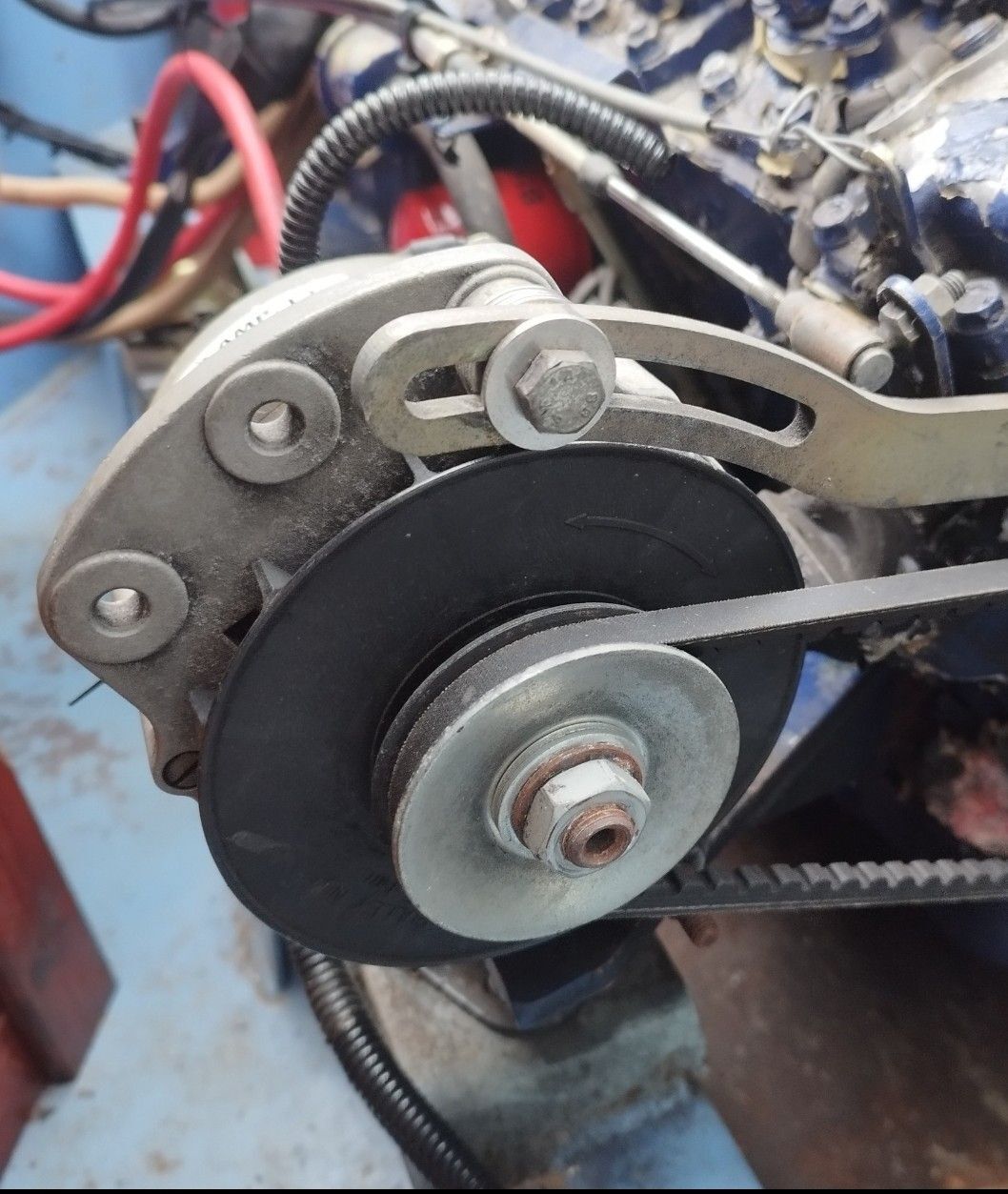

blackrose Posted June 3 Author Report Posted June 3 (edited) This is the alternator. Edited June 3 by blackrose
Kingdom Isambard Brunel Posted June 3 Report Posted June 3 3 minutes ago, blackrose said: This is the alternator. That is a universal 3 hole one, set up as left hand.
