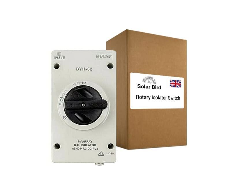

I bought this one, it feels like a good bit of kit and I have seen other boaters use them.
I note that it has no obvious current rating, which is one thing that may cause a fire if it is insufficient. You really should calculate the maximum likely current your panels can produce and compare that with any switch's current rating.
It's 32A
TRUE DC ENCLOSED ROTARY ISOLATOR IP66 SOLAR/PV - 32A 2 POLE/4 POLE 1000VDC
The V-Switch is a configurable DC isolator for a photovoltaic system with PV string voltage from 300V to 1000V. The switch is a piece of essential equipment for any PV installation and should be connected between the solar panels and inverter.
Features ;
— IP66 water proof with UV resistance
— Arcing time <3ms
— Earth connection
— IEC60947-3, AS60947.3 compliant
— 2 poles, 4 poles available for single and double string
— 32Amps up to 1000V configurable
IP66 1000V 32A true DC isolator switch BYH-32, shall be installed between the solar arrays and solar inverter.
For isolation the PV array during system installation or any maintenance.
The switch must be rated for system voltage ( 1.15 x string open circuit voltage Voc ) & current ( 1.25 x string short circuit current ISC ). Recommend as a standard isolator to solar installers.

Never ever fit an AC isolator in a DC circuit.
There's one chap who calls himself a professional solar panel fitter on YouTube who fits AC ones he get's from Screwfix! There is a significant fire risk as DC causes a huge spark across the contacts which you don't get with AC, so you need an isolator with both a greater distance and faster closing and opening than AC. The one @Manxcat54 has fitted is spot on.
Here's a rather scary video if anyone doesn't believe me...
The jaw dropping difference between AC and DC isolators
The arcing on the DC only arises due to inductance in the circuit. The heater in the video has a lot of coiled wire inside which I guess gives it plenty of inductance. I don’t know what the inductance of a solar panel itself is, not much I’d have thought. And the wiring is in straightish lines so again very little inductance. So I think the video rather over-eggs the issue as applicable to solar panels.
Whilst of course it’s true that a switch rated for ac will have a different (much lower) current rating for dc, that is only an issue when interrupting a high current with significant inductance in the circuit. It has no bearing on the current rating whilst the switch is on. And if you only switch it off when the current is low (batteries fully charged, darkish etc) then again no problem.
So yes of course the correct answer is to ensure that the dc rating of the switch is adequate, but in practice let’s not over scare-monger!

Well I'm sure you're right but I'm not taking any chances. I've probably over engineered my setup but better safe than sorry.
