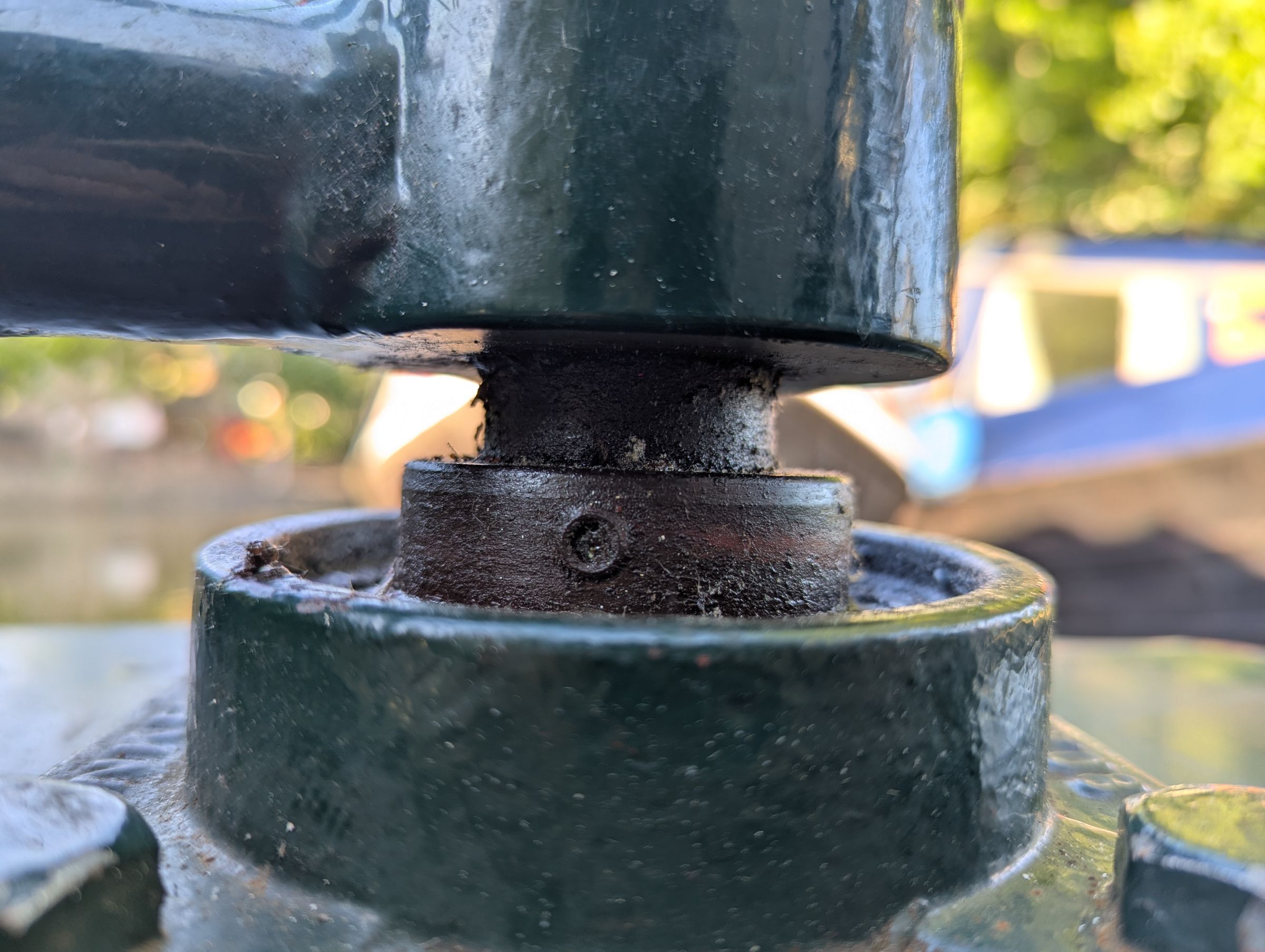

My surveyor has written this on the report:
The rudder stock bearing was found to have failed and would be advised
to replace ahead of further failure of the bearing race to ensure smooth
steerage:
Comments: Recommend the rudder stock top bearing at deck level is replaced
to ensure smooth steerage.
This was 3 months ago and recently, I’ve noticed that steering is getting worse - it seems the tiler is more wobbly and that I don’t do that fine manoeuvring anymore.
I’m wondering if I got what the surveyor is recommending right - before buying the parts. I found this blog that seems to explain what I need to do: https://dru-withoutamap.blogspot.com/2021/06/replacing-rudder-stock-bearing-on.html
And this is what I’m thinking of buying:
https://www.bearingboys.co.uk/4-Bolt-Flanged-Bearings/UCFX08-FS-4-Bolt-Square-Flanged-Bearing-with-40mm-Bearing-Insert-96617-p
Pictures of the current bearing below
RudeStock-3.jpeg.87c052c8f60262c41c4574eb5de8a1e8.jpegRudeStock-2.jpeg.1d73006be03ef57d122aedc08fc4abfa.jpegRudeStock-1.jpeg.956466724985d7898c009baa1a26c487.jpeg
Any insights my appreciated.

Yes, the top rudder nut bolt without a washer suggests this may be a square rudder shaft top end into the tiller....which may be far easier to remove.
Usually, we have to use heat, pullers and lots of hard banging..(think Thor) to get tillers free from the rudder stock, but our latest paint job had a 40plus year old boat with a square stock come free with a slight knock.

Also, any tips for measuring the diameter. I can measure the outside, of course, but it it the inside that matters, right?!
Why do they put almost the same name for something with 1.9mm difference 🤔
UCFX08-24 or UCFX08
https://bearing-king.co.uk/products/ucfx08-24-bkl-brand-4-bolt-hole-flange-bearing-1-1-2-inch-shaft?_pos=2&_sid=277f24c4d&_ss=r
https://bearing-king.co.uk/products/ucfx08-bkl-brand-4-bolt-flange-bearing-40mm-shaft?_pos=1&_sid=277f24c4d&_ss=r
I think it's the UCFX08 as FX08 is written on the current one.
You need to measure the shaft itself with a pair of Verniers. It might be tricky to get access, but if you're taking the rudder stock out that should be easy enough, just means you can't go anywhere until it arrives, unless you refit it.
As it has to come off anyway, I would take the swan neck off the stock. That should allow the OP to measure the stock diameter just above the bearing.
Mine has room to measure between the top of the bearing and under the Swan neck.
So did mine, but the OPs seems to have a large boss, so if he is not familiar with vernier calipers he may find it easier with the boss out of the way.
I'll see if I can measure between the top of the bearing and under the Swan neck as @ditchcrawler is suggesting. If not, I guess I'll have to take it off to measure in order to buy the right one.

Looking at this I think I'll be able to get the measurements before taking the swan neck off.
What do you all think?
