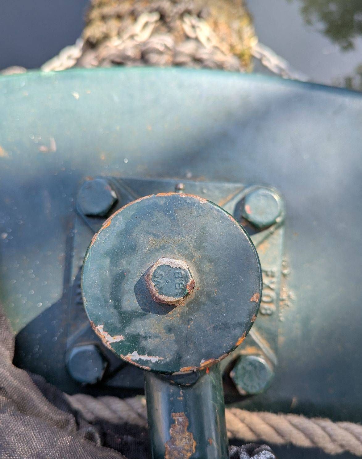

matty40s Posted May 16, 2025 Report Posted May 16, 2025 (edited) Yes, the top rudder nut bolt without a washer suggests this may be a square rudder shaft top end into the tiller....which may be far easier to remove. Usually, we have to use heat, pullers and lots of hard banging..(think Thor) to get tillers free from the rudder stock, but our latest paint job had a 40plus year old boat with a square stock come free with a slight knock. Edited May 16, 2025 by matty40s

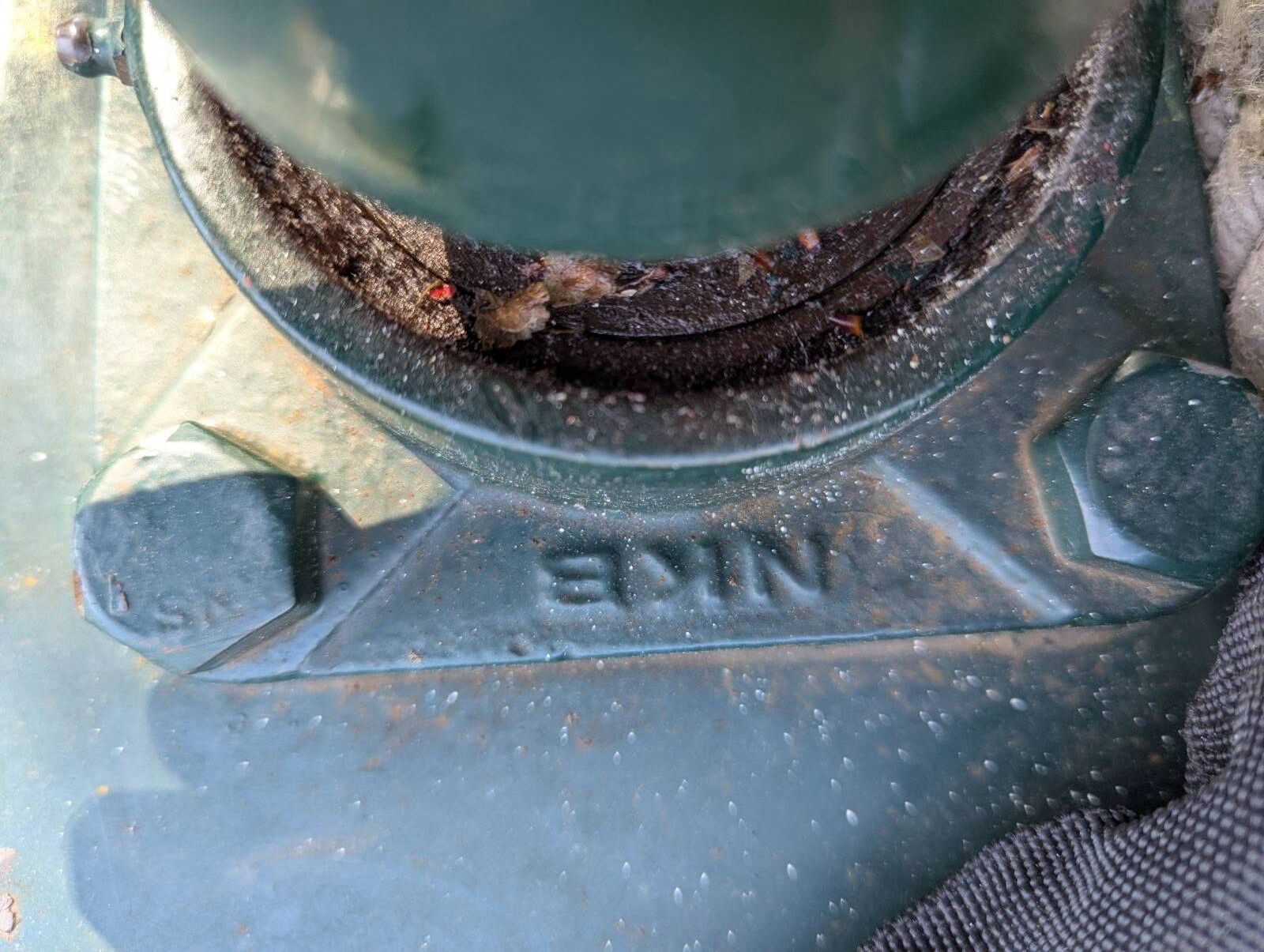

Tony Brooks Posted May 17, 2025 Report Posted May 17, 2025 When you do replace it, make sure that the rudders stock is not angled, as many are. If it is, be very careful where you put the grease nipple because in the last bearing I fitted the grease path into the actual tracks and race was via a small hole in the outer track, and if the grease nipples were at the front or back the housing blocked the grease path. I am not saying all are like this but worth checking when you fit it.

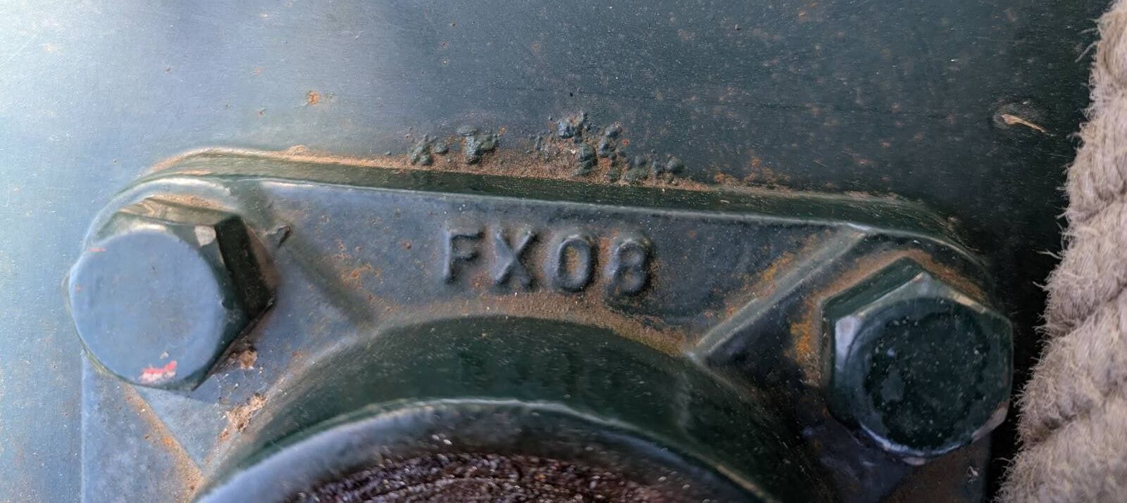

blu Posted May 17, 2025 Author Report Posted May 17, 2025 What's the score stainless vs marine? I lost the count hehehe Which one should I go for? Also, any tips for measuring the diameter. I can measure the outside, of course, but it it the inside that matters, right?! Why do they put almost the same name for something with 1.9mm difference 🤔 UCFX08-24 or UCFX08 https://bearing-king.co.uk/products/ucfx08-24-bkl-brand-4-bolt-hole-flange-bearing-1-1-2-inch-shaft?_pos=2&_sid=277f24c4d&_ss=r https://bearing-king.co.uk/products/ucfx08-bkl-brand-4-bolt-flange-bearing-40mm-shaft?_pos=1&_sid=277f24c4d&_ss=r I think it's the UCFX08 as FX08 is written on the current one.

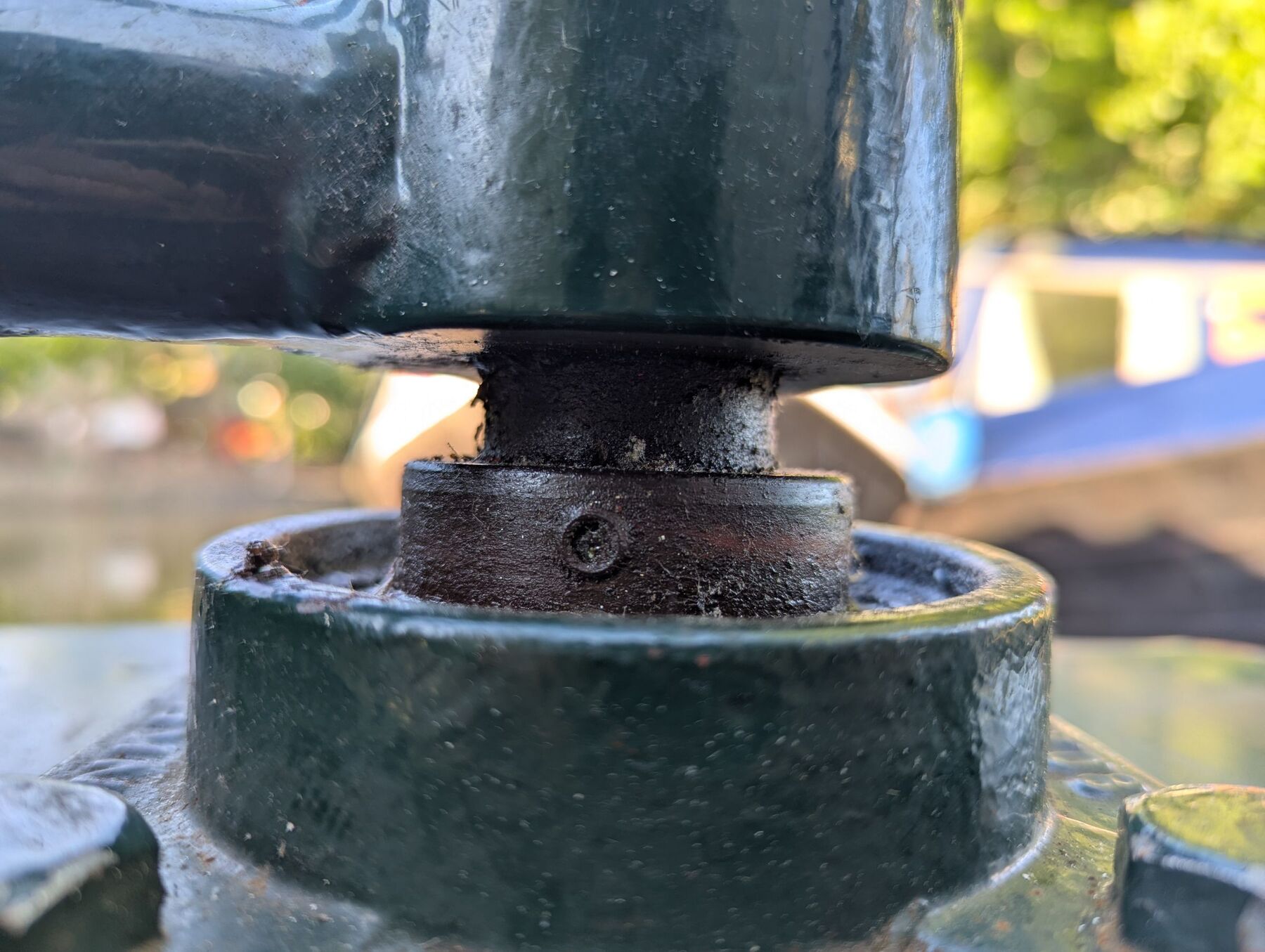

ditchcrawler Posted May 17, 2025 Report Posted May 17, 2025 1 minute ago, Tony Brooks said: As it has to come off anyway, I would take the swan neck off the stock. That should allow the OP to measure the stock diameter just above the bearing. Mine has room to measure between the top of the bearing and under the Swan neck.
Tony Brooks Posted May 17, 2025 Report Posted May 17, 2025 1 hour ago, ditchcrawler said: Mine has room to measure between the top of the bearing and under the Swan neck. So did mine, but the OPs seems to have a large boss, so if he is not familiar with vernier calipers he may find it easier with the boss out of the way.
blu Posted May 17, 2025 Author Report Posted May 17, 2025 I'll see if I can measure between the top of the bearing and under the Swan neck as @ditchcrawler is suggesting. If not, I guess I'll have to take it off to measure in order to buy the right one. Wow, why boats have to be so impractical? Why make things simple if they can be complicated 1

blu Posted May 18, 2025 Author Report Posted May 18, 2025 Many thanks @Psychalist I'm more prone to go for the like for like replacement tbh, things in boats are already not that straight forward as they are LoL. So I'm going to go for either the UCFX08-24 or UCFX08 from my previous post. I'll work on the measurements later in the week and see what I get.
blu Posted May 19, 2025 Author Report Posted May 19, 2025 Looking at this I think I'll be able to get the measurements before taking the swan neck off. What do you all think? Thanks
