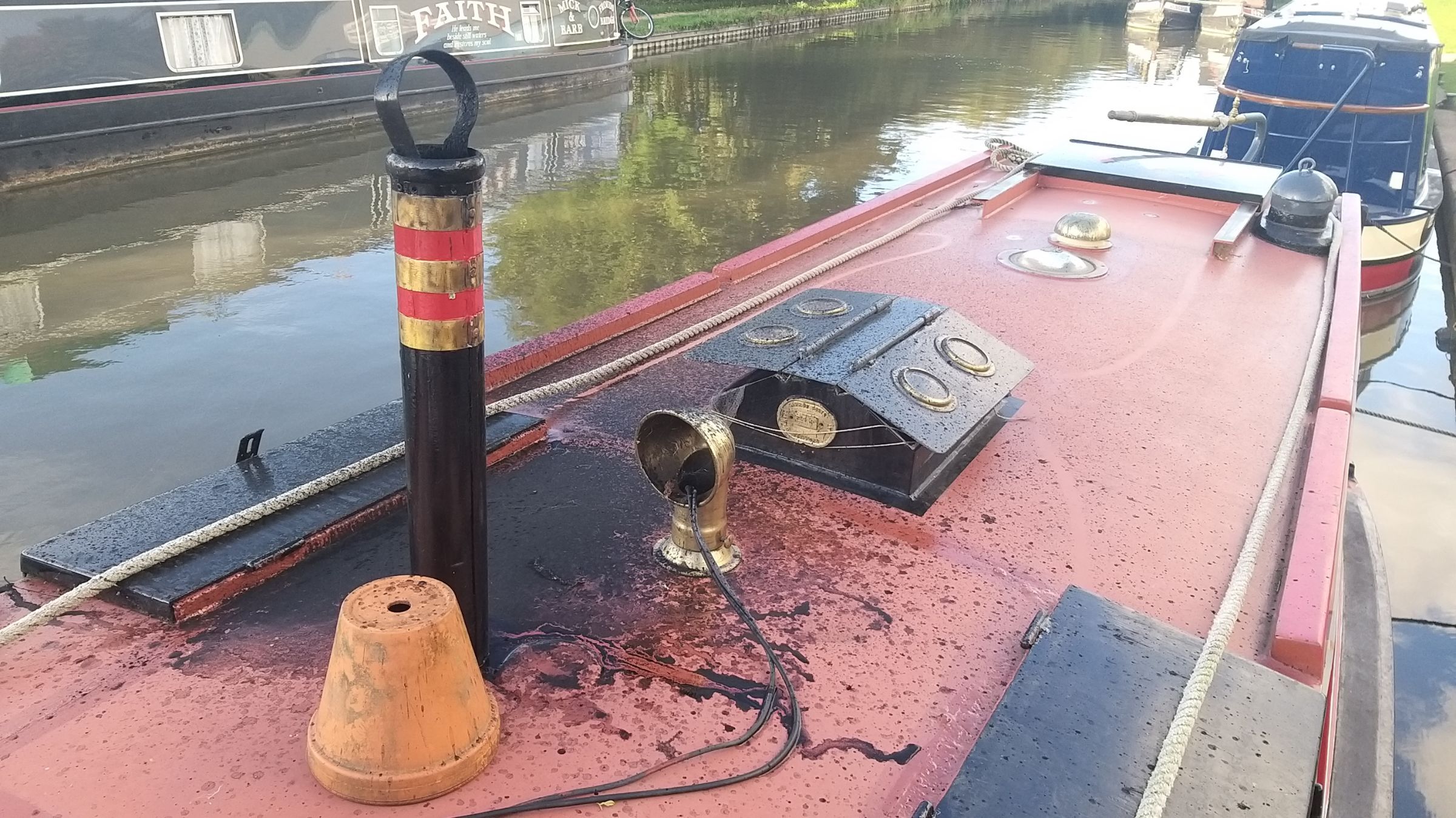

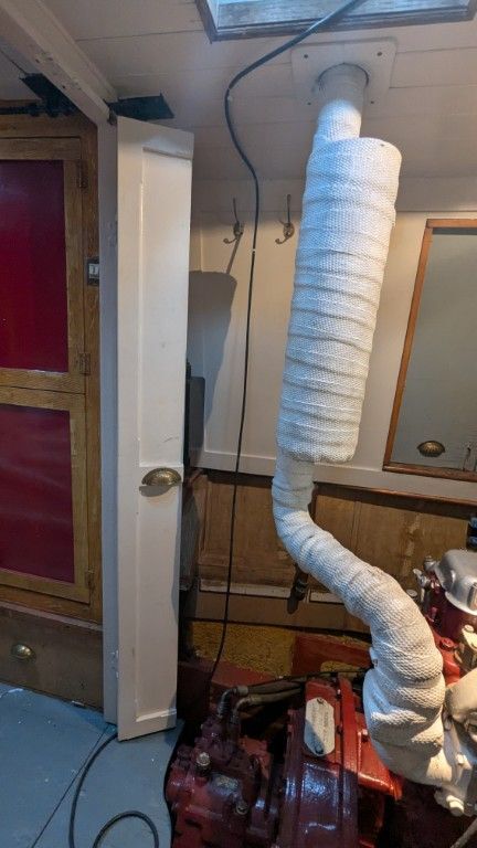

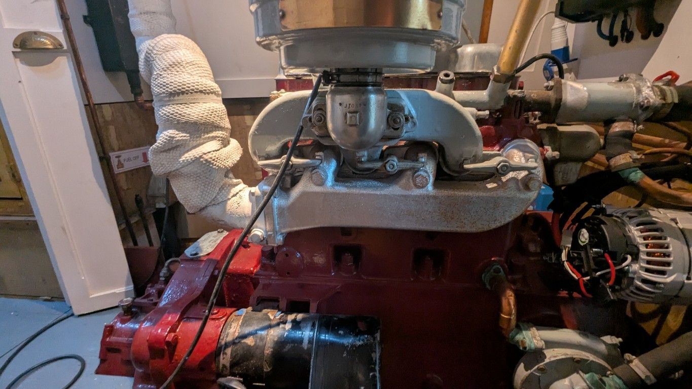

So I am an idiot and forgot to put the cap on the exhaust. There was no rain scheduled so I was planning to go back to the boat and put it on in the morning, however there was a massive downpour and it rained for about an hour overnight.  I am obviously now worried about water in the engine and don't want to risk starting it until I can be sure there isn't any, or at least none has made it into the exhaust valves.  The layout of the exhaust and manifold means it would realistically need quite a lot of water to hit the valves (I calculated about 2L would be required) and the hole is only 80mm in diameter.
2025-05-1208_59.29(Medium).jpg.b4e55851f9875703abae60b9b39dfa5b.jpg2025-05-1208_59.34(Medium).jpg.f2bd38ecf41b8d418422271fa00cdc80.jpg

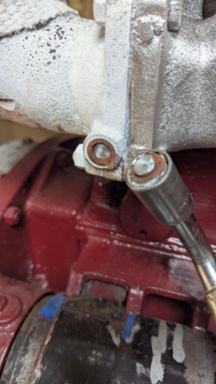

There is what looks like a convenient drain hole but this happened:
I guess my questions are; how likely would there have been enough water to reach up to the level of the exhaust valves and water to have got into the engine? Is there anything else I can do to check other than removing the manifold (and potentially shearing more bolts....)?
I'm sure you're not the first to have done this and I've not heard of any dire consequences.
But that doesn't mean to say that there haven't been any, of course.
Any rain (surely only a couple of inches?) would be caught in the baffles within the silencer and not have chance to reach the innards of the engine.
Gardners are robust. I'd start her up and let her get hot. I'm sure that would remove any moisture before any harm can develop.
Having said that, it's not my engine so i've nothing to lose...
I'd be worried trying to start any engine that might have water in the cylinders.  Water is incompressible, but something has to give - a con rod perhaps!
Does your engine have manual decompressors? If so open them up and spin the engine on the starter. That will throw any water in the cylinders out into the exhaust. Then close the decompressors again and start normally.
If I have done my maths correct, it would have needed 99mm of rain to create 2L over an 80mm hole, which is all the rain we had for the whole month of January 😂
It does indeed, well it has one lever which I assume opens all of them. How long would you suggest?

A few seconds will empty the cylinder(s) of any water which may have got in. Then start her up and run for long enough to get the whole exhaust system hot to dry out the silencer - leave water in there and it may start to rust.

FWIW I always turn our 3LW over a few times with decompressor on if its been left for more than a few days. Our engine's exhaust manifold points down at 45 degrees, then has a bend back to the vertical, so more room to accumulate water below the valve inlets.

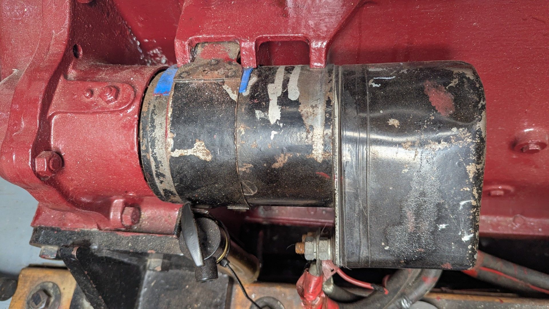

I think it might be something else but I need a photo.
Alec

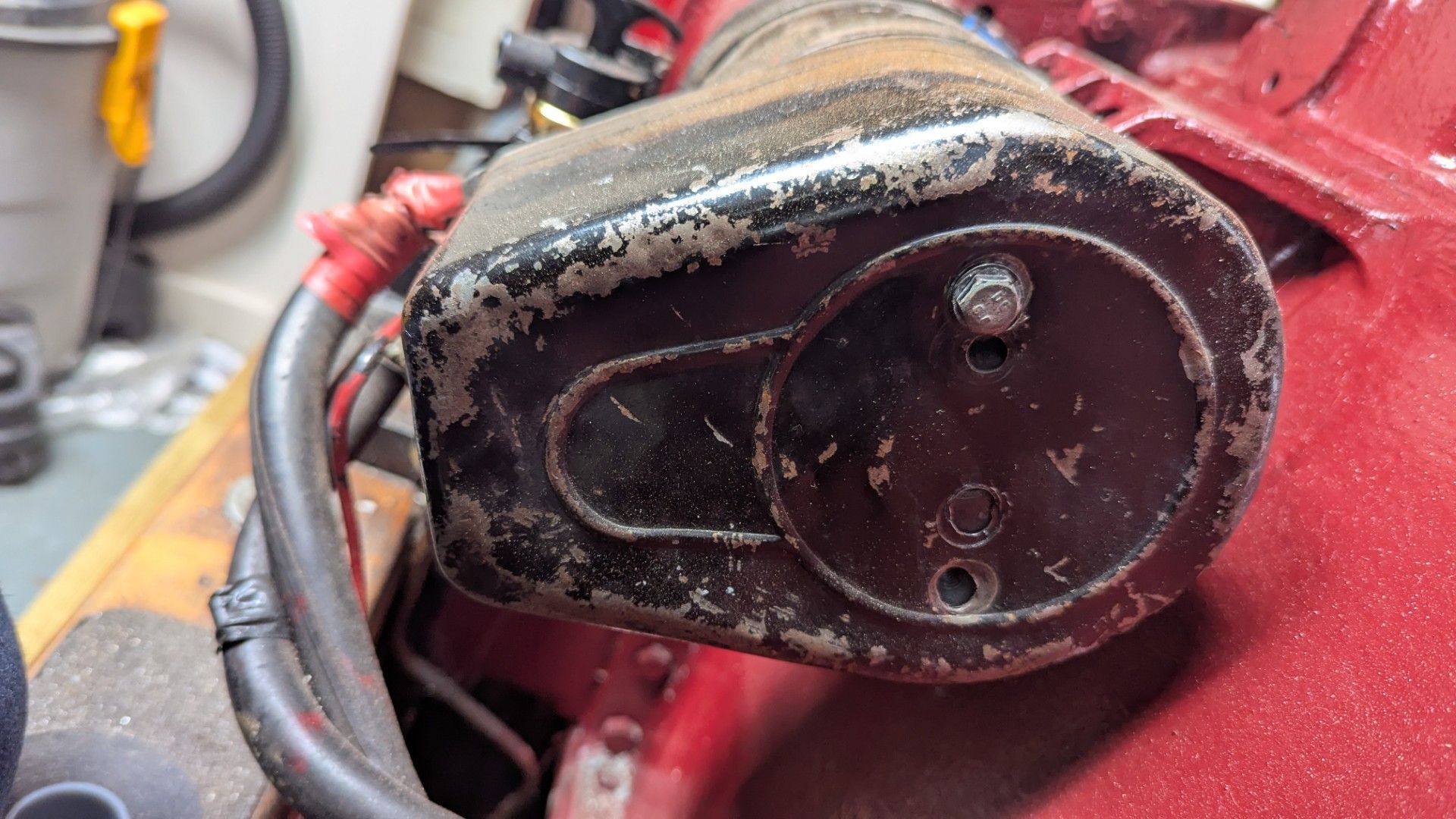

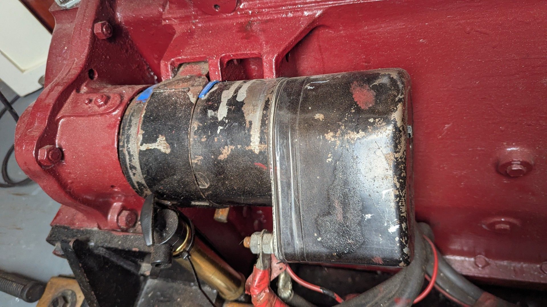

I certainly do have photos of the starter as it's the next thing to look at on the engine, I have been told it doesn't sound right.
The battery is brand new and fully charged, it was even more laboured on the old battery. Since getting the new battery she does start straight off without the decompressor under normal circumstances so I was hoping that was all there was.....

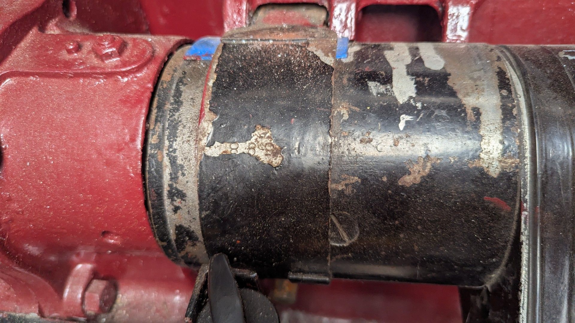

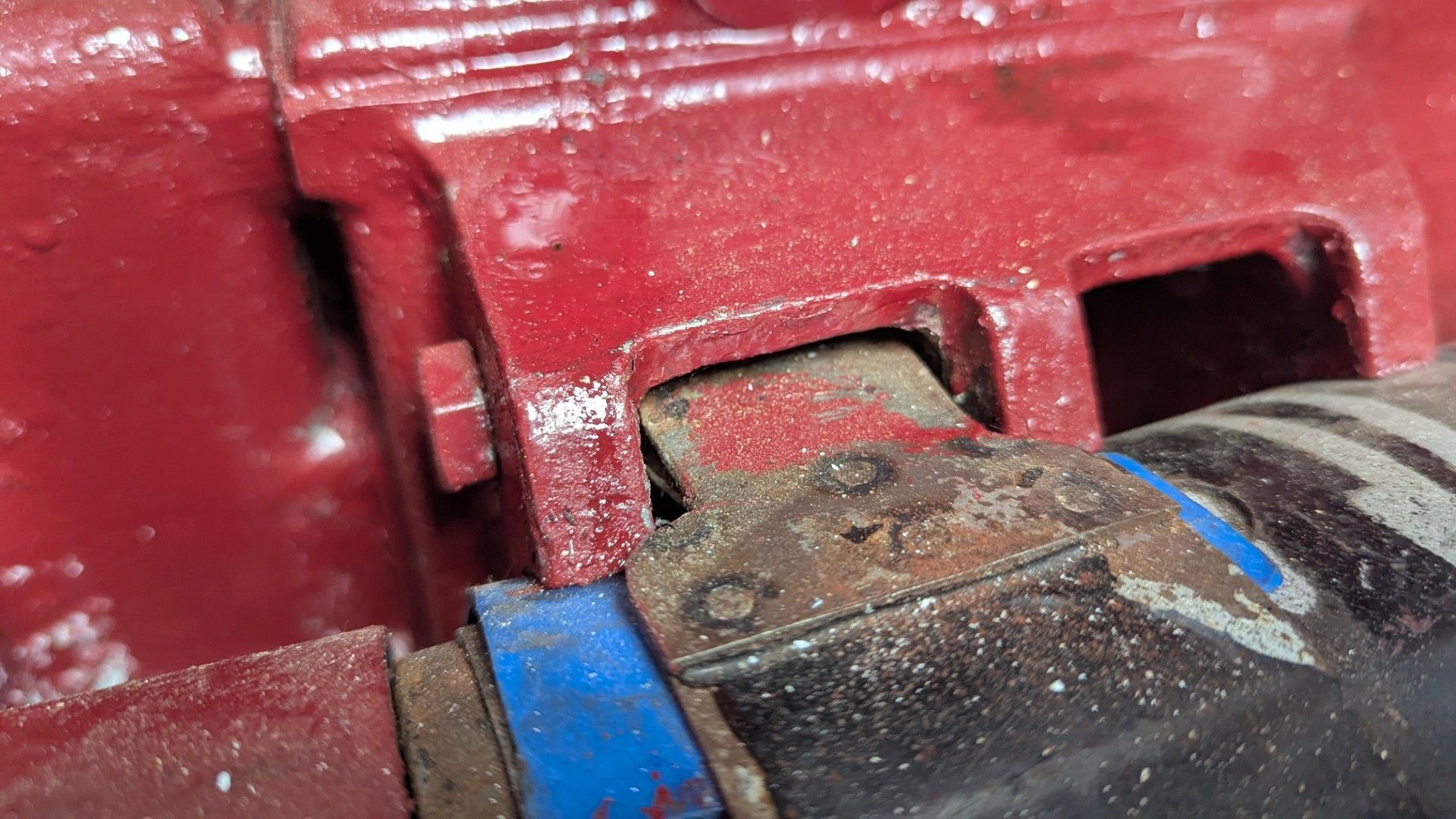

The photos confirmed what I thought. That is a CAV BS5 starter motor, which is exactly what should be on there. However, these come in two variants - 12V and 24V and I strongly suspect that you have a 24V starter motor fitted and are running it with a single 12V battery. I know this because someone had done the same to ours. It will start on a well charged battery with a good engine but you only have a few attempts before the surface charge depletes too far and you have to wait 10mins before you can have another go.
The main advantage of the 24V starter motor is that you need much thinner cables (I do have the recommended diameters for these somewhere, posted on another thread). However, it does require space for two batteries and some more complicated wiring to charge at 12V but discharge at 24V (don't ask me how to do it!)
In the end, I found a 12V starter motor and swapped it over - works much better!
Alec

How would I confirm this is a 24V model? Other than what you described about having to wait 10 minutes being EXACTLY what I've experienced. The above video was 6 and half minutes before being cut.
Presumably I could add a second battery and change out to a 24/24 charger? (I'll consult the electrician before doing anything of course)
You could well be bang on the money there. I had this motor on my K1 in 24V format and it spun the engine over faster than tickover once started!
Ref. confirming 12V vs. 24V, sometimes there is a data plate on the starter motor, on the same face as the connecting terminals. Mine was missing. My approach to confirming it was 24V wasn't very scientific. I borrowed a second starter battery and a wire and temporarily wired it in series. My reckoning was that I knew the engine was good, so it was either a faulty starter motor, in which case cooking it at 24V wouldn't make it much worse as it would need to go off for repair anyway; or it would work properly and prove the point. It did the latter.
No idea on the electrical charging side I'm afraid. @Ben Jameson has a 24V starter and may be able to comment on the wiring.
These starter motors are capable of delivering around 15hp, which is 930amps at 12V. I have a 900CCA battery fitted which means in reality the limiting factor is the wires, but in practice it draws a lot less than that, even at full compression. It does explain why they will spin the engine faster than tickover when properly set up!

At the moment she does start so I have no need to rush into anything, might have the back off the starter to see if there is any identification on it anywhere. If it is 24V, I'm the opposite of that other thread's poster; I'd rather fiddle with the electrics than the mechanical bits.
It's very probable she's been set up this way for nearly 30 years!
Could 12V on a 24V starter motor also mean the solenoid which pushes the pinion into gear doesn't push it all the way, hence the teeth not engaging every time?
