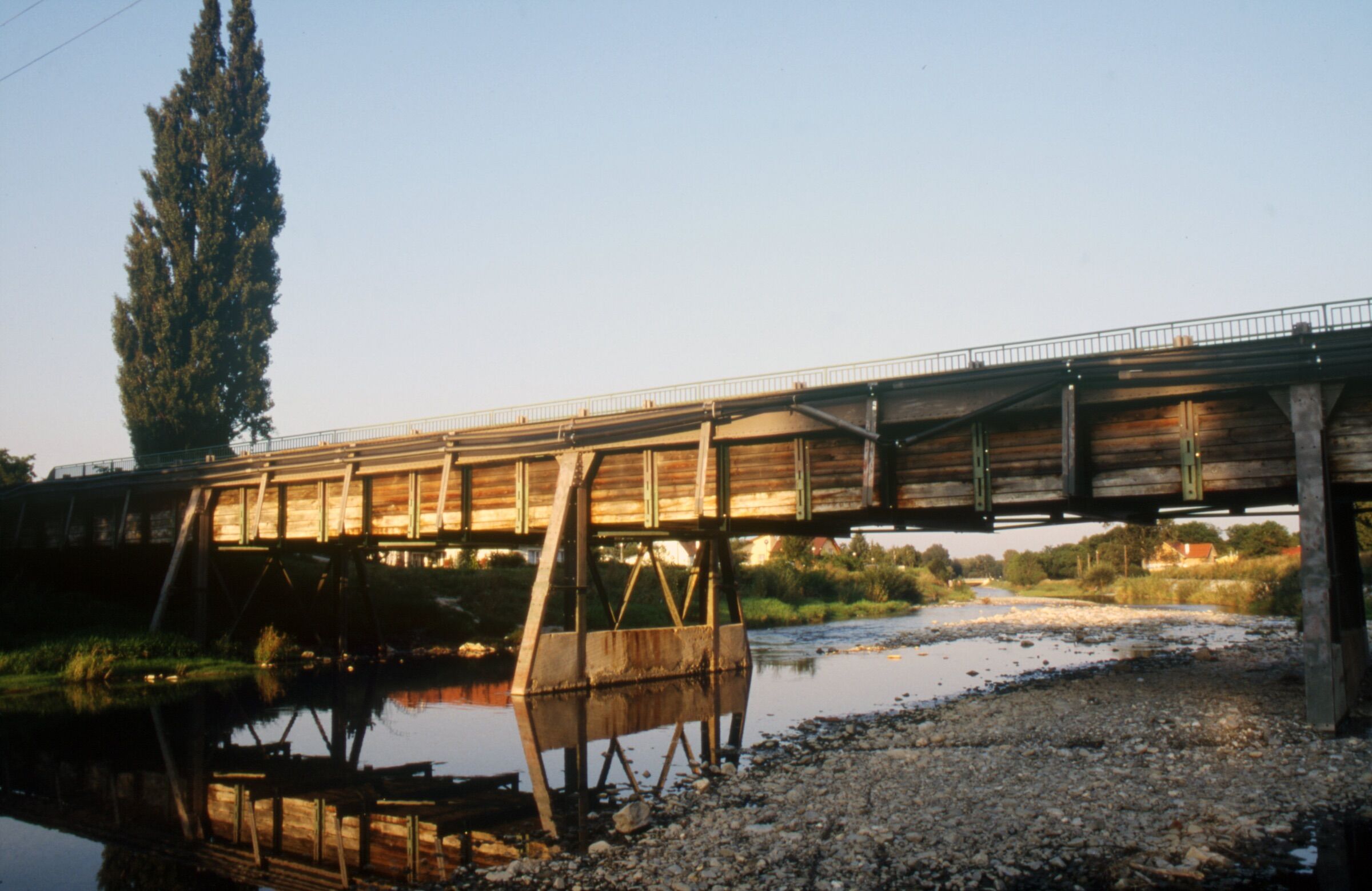

It may reflect on the Germanic origins of many US inhabitants. Wooden bridges were common in the European Germanic area, and some were quite advanced in design. This is the Schwecht Aqueduct on the Wiener Neustadt Kanal, built from Vienna in 1800c. No cover, but the principal is the same. Perhaps Americans did not want to get their canal water wet?
