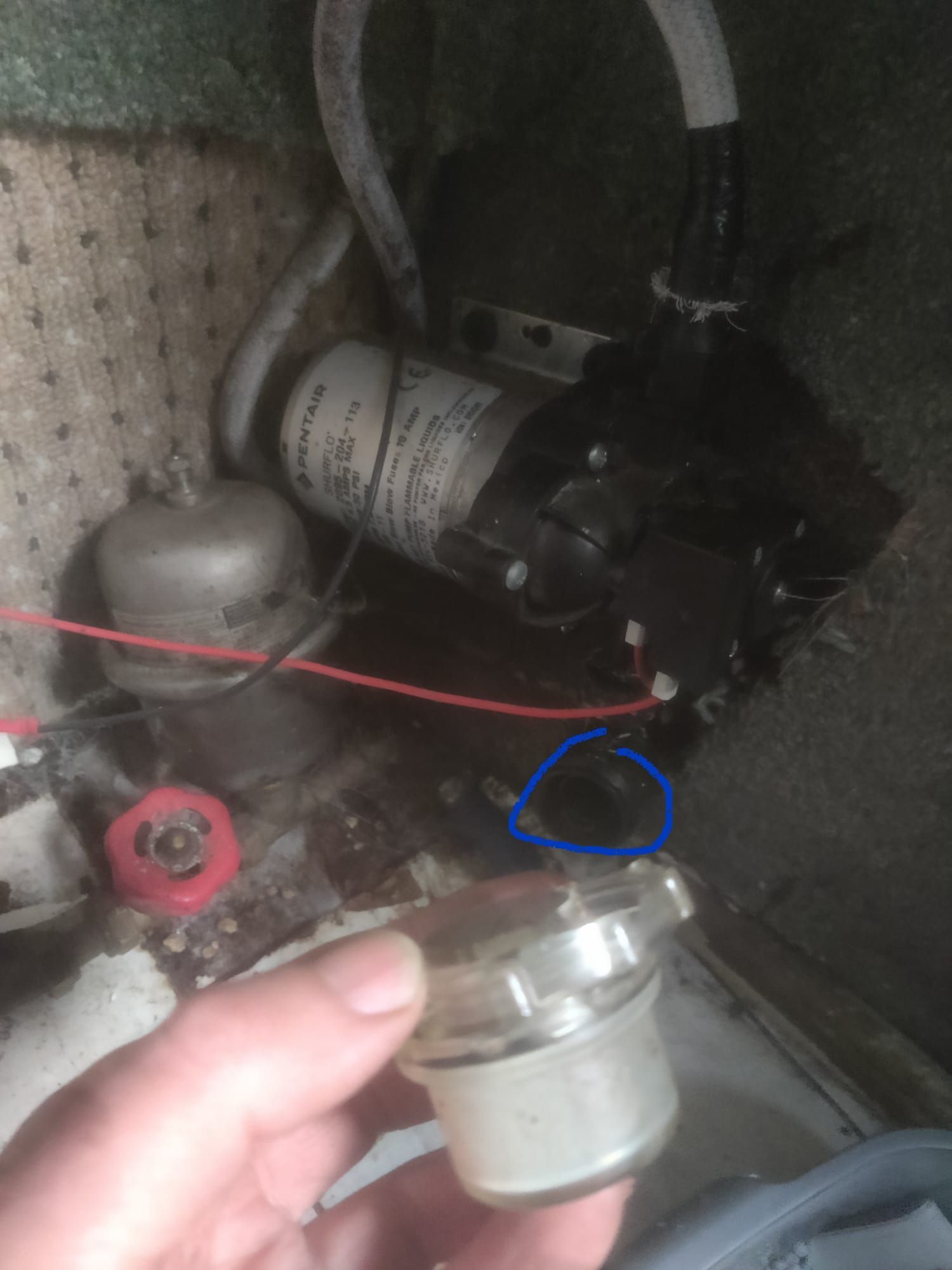

On a separate note the plastic screw-on water filter attached to the pump (shurflo) had also cracked and fallen off but I'm pretty sure this wasn't the cause of all the water ending up in the cabin bilge (rather than an issue with the water tank which is my current theory), as I had turned off the power to the pump before leaving the boat for a couple of weeks.

10 minutes ago, Chris Watkeys said:
Thanks Nick - I might be able to access it from inside the cabin, will check when I get back to the boat.
If you turned the power to the pump off but not closed the outlet from the tank, then a cracked filter would happily empty your tank in a couple of weeks
Blimey, if that's the case I'd be very happy as it's obviously a quick fix.
The only doubt I have is that above boards in the cabin between the front and the rear was dry, and all the water I was bailing out of the bedroom (at the rear of the boat) was basically overflowing from the small cabin bilge access right at the back.
Given this, would you say there's still a chance it was just the cracked filter?
If the cover was off the filter it would be like fully opening the drain tap on the tank. I take it. it's one of those clear plastic jobs mounted directly on the pump inlet

Unless you have lifted a complete cross-section across the whole boat, somewhere between the filter and the definitely wet bit, and found that there is absolutely no damp area anywhere across the width then yes.
Most boats are slightly lower at the stern than the bow - yours is because otherwise regardless of where the water started it would have ended up either level across the whole boat length or at the lowest point, so it's reasonable to conclude that yours is low at the stern. If the water trickles through from somewhere, it gradually runs in that direction and, unless there is an obstruction that it has to pond to get over (not generally desirable as it means the area immediately uphill stays wet) then you can have a slight trickle for an extended period that gradually ends up with a big pool at the lowest end, leaving little trace of where it ran.

Given the relative costs involved I'd suggest it is worth eliminating the @ditchcrawler suggestion from your enquiries. Concurrent failures in the water system while you were away seem unlikely. Recent freezing weather further points to weather related cracking of the filter. Is the filter above the waterline and away from the warming effect of canal water?
There was a thread on CWDF discussing nocturnal gurling in a water system. One theory was that warm water contraction sucked water through the water pump even though the pump was switched off. Someone said the internals of a water pump are just rubber paddly whotits.

Ditchcrawler - yes, it's a clear plastic filter mounted as you say.
Alec - thanks very much for your reply and explanation also, much appreciated.
I guess I'll fit a replacement filter, fill the tank up and see what happens!

The early bayonet shurfo type strainers were notorious for either failing or coming loose. The plastic tabs would generally snap. Even if yours has worked loose,i would replace it with something better.

The plastic filter is on the inlet to the pump, so if you didn’t turn off the water stopcock then when the filter cracked, all the water will come out of the tank.
For future reference, what I do on leaving the boat is to turn off the gate valve at the tank exit, then disconnect the pump inlet. I then run the pump (which sucks in air) and open the taps to push out as much water as possible. Because the lower you are in an unheated boat in winter the warmer it is (because the canal bottom never gets that cold) any water lying in the pipes at the bottom of the boat is unlikely to freeze badly and conversely things higher up eg shower hoses and valves are more prone to freezing. So I always disconnect the shower hose from the taps and drain it, push air through the shower valve etc..
