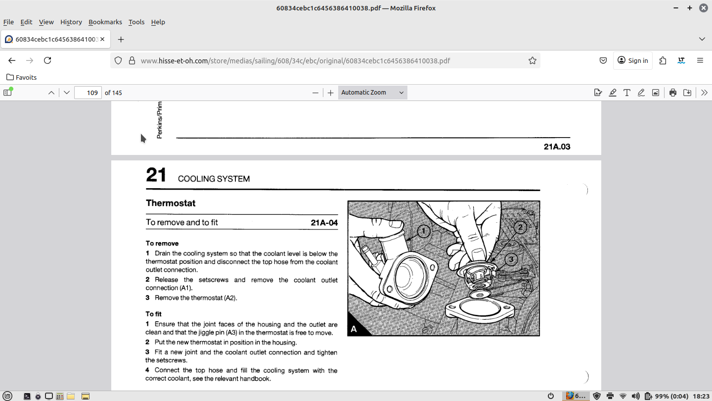

Long shot. You say that you have the manual. Check what type of thermostat it uses. If it needs a bypass stat and someone has fitted a normal one, then a lot of coolant could flow back into the engine rather than through the skin tank.
A bypass thermostat is one that has a large "washer" hanging down below it. There is another type but doubt it would be used in that engine.
Just checked, according to Mr Google the Prima does use a bypass thermostat.

The photos on Google, including the ASAP listing clearly shows it is a bypass stat, without a manual I have no other way of checking.
Misnaming a Perkins Perama or using its manual that does seem to use an ordinary (non-bypass) stat it would explain the discrepancy.
If you take the thermostat out I expect you will see a largish hole in the bottom of the housing with an up stand around it which the "washer" seals as the coolant heats up. If it is not there, then an ordinary stat would be fine, but if it is, then that hole will allow hot coolant to pas staright back into the engine.

This screenshot from the manual clearly shows a bypass thermostat - you can see the washer like thing hanging below it.

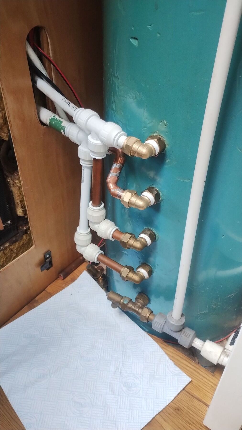

For those all helped me resolve my issue (and I finally have).
I d just like to thank for all the input received. I also learnt a few things along the way which I very much appreciate.
So. I had a spare coil connection on my calorifier. I linked the coolant pipework to both with 15mm T pieces.
Hey presto the hot water now heats up. The bottom one is still cold at the bottom exit so I believe that the calorifier is full of limescale.
Which apparently can affect the flow and cause many other issues.
So at my earliest convenience I will attempt to flush it out. If not it will be replaced.
Thanks again.
