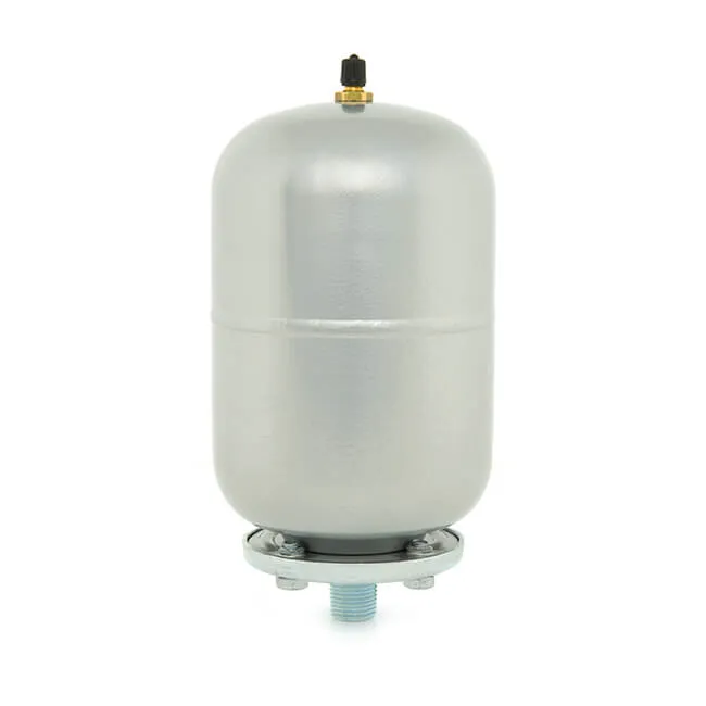

MtB Posted April 9 Report Posted April 9 12 minutes ago, Cancunia said: My 25 year old boat has no accumulator so I'm thinking of fitting one to save undue stress on the pump but I'm not sure what size is needed. I've searched on here and see things like 'the bigger the better' but how big is big? There are loads of 0.75L accumulators for sale including from brands like Seaflo, is that big enough for a small 36 foot boat with a sink and a calorifier tank? Can I use a central heating expansion vessel? Thanks. It's all a matter of taste. The bigger the accumulator, the longer the on/off/on cycle will be. I find a 2 litre accumulator about right. I've just bought one of these, coincidentally. https://www.bes.co.uk/catalogsearch/result/index/?q=25745 And no you need one for "potable water" not central heating. 1

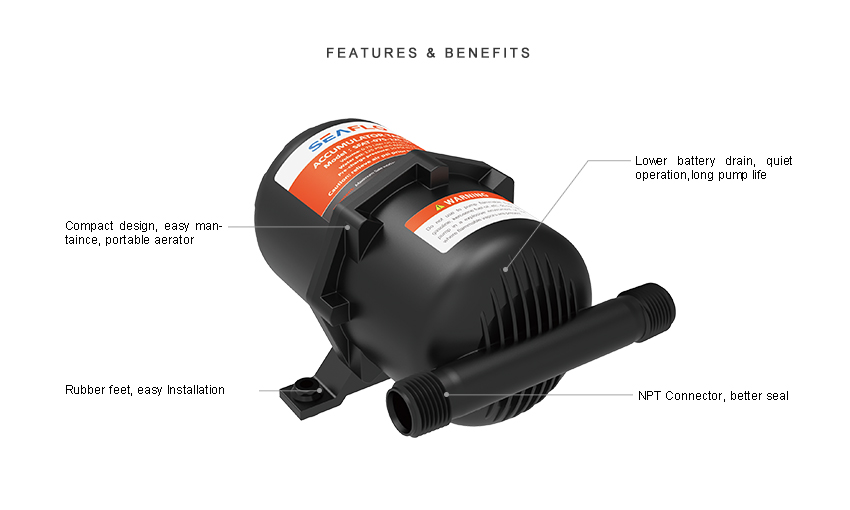

Cancunia Posted April 9 Author Report Posted April 9 Thanks for the quick replies. I did wonder if 0.75L would be big enough and was thinking about 2L. I'm fairly sure that I have enough space for a 2L tank but don't want to take up space without good reason. Any ideas why the smaller tanks have 2 water connections and the larger tanks have only 1?
MtB Posted April 9 Report Posted April 9 2 minutes ago, Cancunia said: Any ideas why the smaller tanks have 2 water connections and the larger tanks have only 1? Errr.... they don't normally! Can you post some examples perhaps? Maybe you are confusing the Schrader valve on them for a water connection...
Cancunia Posted April 9 Author Report Posted April 9 1 minute ago, MtB said: Errr.... they don't normally! Can you post some examples perhaps?
MtB Posted April 9 Report Posted April 9 7 minutes ago, Cancunia said: Oh I see. That is just to save you installing a tee fitting in the pipe! But hang on, thats a pump not an accumulator!
IanM Posted April 9 Report Posted April 9 1 minute ago, MtB said: Oh I see. That is just to save you installing a tee fitting in the pipe! I think that's a combined accumulator and pump. Or that's what it reads like.

MtB Posted April 10 Report Posted April 10 12 hours ago, Canal321 said: I fitted a cheap 0.75 L as shown, works fine 👍. Except the picture shown is a 2 litre vessel.
Cancunia Posted April 10 Author Report Posted April 10 1 minute ago, Canal321 said: One of these. Ah, the one that I posted! Yes, I was looking at them and then decided that a few pounds more would get me a 2L version. Did you have any problems with the pipe connections? I saw some comments (maybe on Amazon) about the connectors leaking when using jubilee clips.

jonesthenuke Posted April 10 Report Posted April 10 On 09/04/2025 at 11:21, MtB said: It's all a matter of taste. The bigger the accumulator, the longer the on/off/on cycle will be. I find a 2 litre accumulator about right. I've just bought one of these, coincidentally. https://www.bes.co.uk/catalogsearch/result/index/?q=25745 And no you need one for "potable water" not central heating. This looks to have the plated mild steel connection like one the one that I fitted. It lasted less than five years, failing with a pinhole corroded through the very thin threaded connection. I would avoid and look for one with a stainless threaded section.
