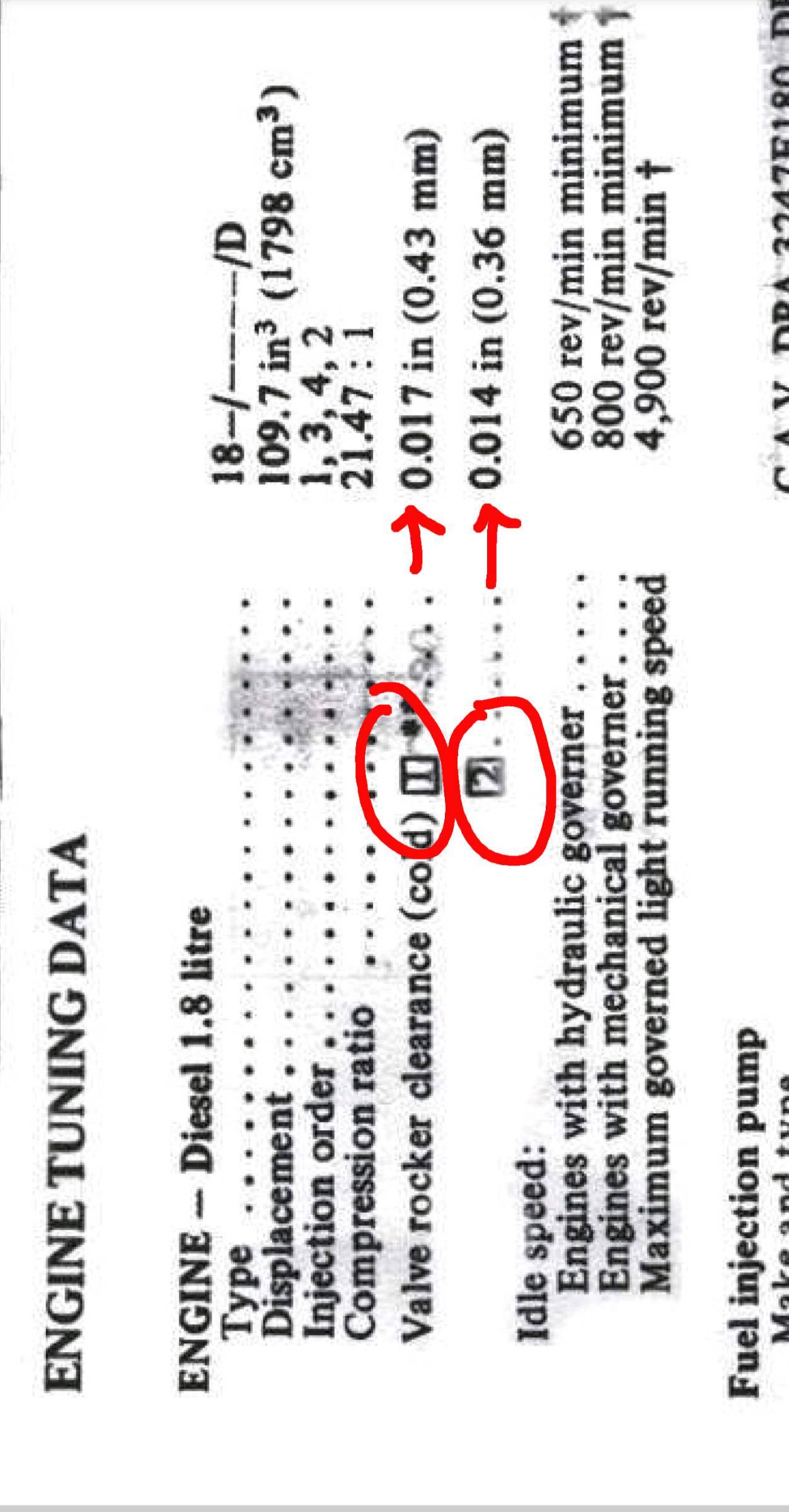

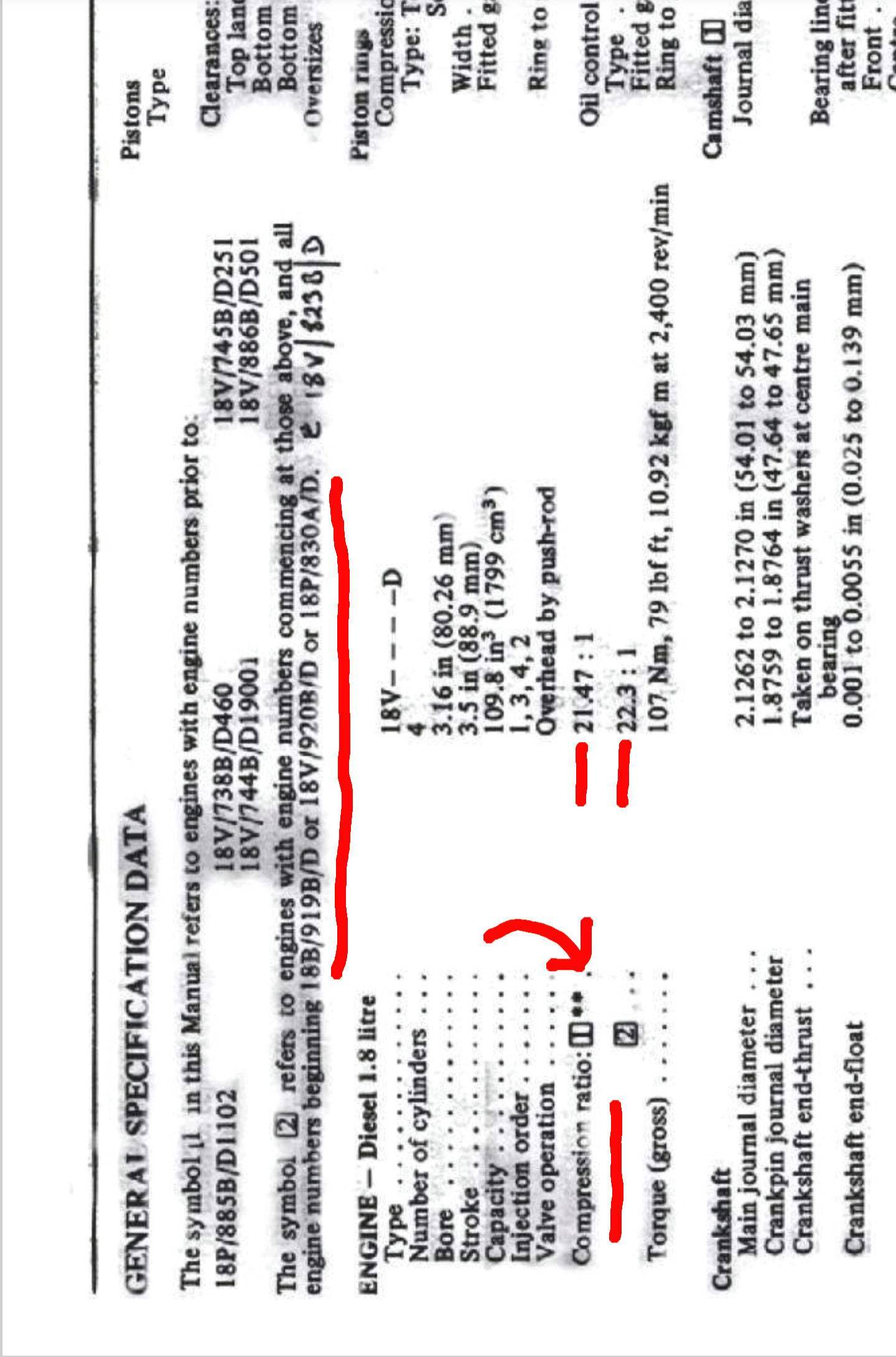

I was actually referring to the asap supplies manual I purchased. It indicates there are two camshaft variations, which slightly different specs.
Oringal 21.47:1 compression, and newer version  22.3:1 compression. The camshaft is slightly dimensionally different too.
.... and I just found the answer to my question when reviewing the manual just now for this reply. Please see attached!
Guess my westerbeke w50 manual is wrong for this engine. The serial lines up with spec '2'.
Edit: forgot to reply to the extra info. the block has a 1800D on it. I'll have a look into the info you shared to make sure I'm not messing things up. the westerbeke w50 manual is availble for free online, but is too large to attach if you are curious.
