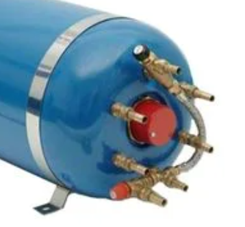

ditchcrawler Posted April 5, 2025 Report Posted April 5, 2025 10 hours ago, Ex Brummie said: There is no doubt the design does not really allow for it to be bled . Very true, I wonder if the hot take off point goes to the top inside like a snorkel ? 3 minutes ago, ditchcrawler said: Very true, I wonder if the hot take off point goes to the top inside like a snorkel ? It doesn't look like you could put it up side down but the hot takeoff is not that close to the top edge
Tony Brooks Posted April 5, 2025 Report Posted April 5, 2025 40 minutes ago, ditchcrawler said: It doesn't look like you could put it up side down but the hot takeoff is not that close to the top edge But there will, presumably, be a certain thickness of insulation, plus the outer case, so the out connection is probably a lot closer to the top of the inner calorifier cylinder than it looks. Anyone had one apart who could tell us?
ditchcrawler Posted April 5, 2025 Report Posted April 5, 2025 20 minutes ago, Tony Brooks said: But there will, presumably, be a certain thickness of insulation, plus the outer case, so the out connection is probably a lot closer to the top of the inner calorifier cylinder than it looks. Anyone had one apart who could tell us? I would love to know as well
