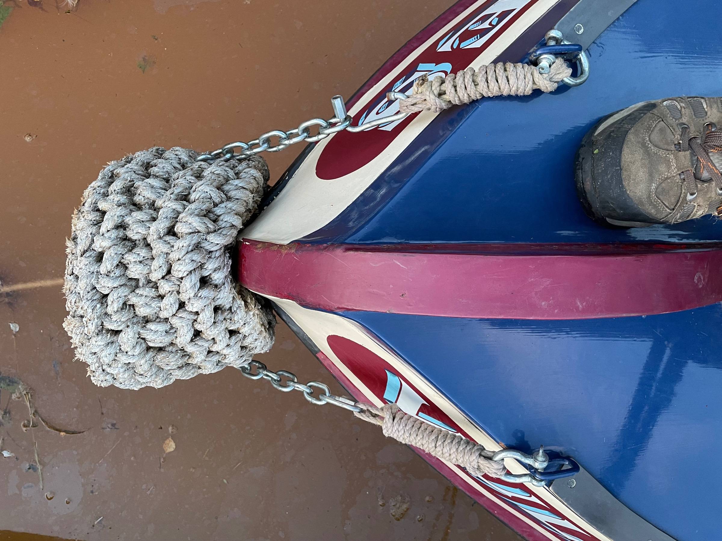

The photo below shows damage to the screw lock carabiner type fitting rather than rope links that you might assume to be the weakest link.
This was caused by the bow fender riding gates while the boat was in gear due to having a boat under tow behind (35’ tug towing an alleged 42’ boat).
I didn’t realise until after the event.
That is a handy weak link but more expensive to replace than a normal chain link cut on one side.
Back in the day I used to regularly pull out opened up forged iron chain links with the magnet. They were forged in such a way as to have an overlap. A bit like a keyring.
I wondered if these may have been a safety feature on the towing harness attached to the animal.
Its nice in some situations to have this sort of thing.

I've found that chain links cut right through on one side eventually open up in normal use (and the chain comes apart) just like the carabiner link in your photo. Similarly with cable ties, they just break pretty soon.
So nowadays I cut 95% of the way through one side of a chain link. These work fine and still break under extreme stress. DAMHIK.
They’re not particularly expensive but it could be argued it didn’t work sufficiently to avert a full hang up as the fender hasn’t been totally released. I didn’t though recall any alarming moment and because of the circumstances was being ultra-vigilant. I can’t even tell you which lock it was in just that it was somewhere between Hillmorton bottom (where with the volockies help we trialled both boats in a narrow lock) and Bosley top.
It was more for the interest that what you’d think to be the weak link wasn’t. The rope ‘shackles’ were stretched too. And you’ll note the bow shackle attachment has been turned around suggesting the fender did lift at some point.
You say that happened from riding the gate. I would be pretty sure that would have failed and released the fender if you had actually had a complete hangup.
Hopefully.
I haven’t changed the arrangement as it’s even weaker than I thought. It’s also how it was installed by Tradline. It’s the same as would happen by cutting a notch in one side of a link in a chain which is the normal advice.
It’s also possible it happened by the fender being pushed to one side.

If you covered the front fender with a car tyre turned inside out then you'd get less gate hangups. Also why have you a steel shackle attaching to the boat ( damaging the paintwork) when you could of tied to the boat or used a rope shackle

I use cord, I may change to thinner cord after seeing this
