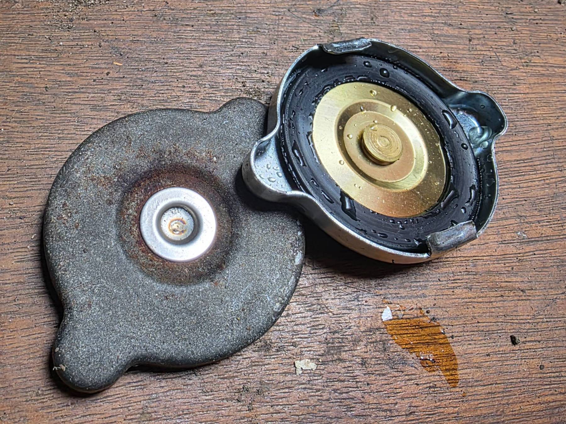

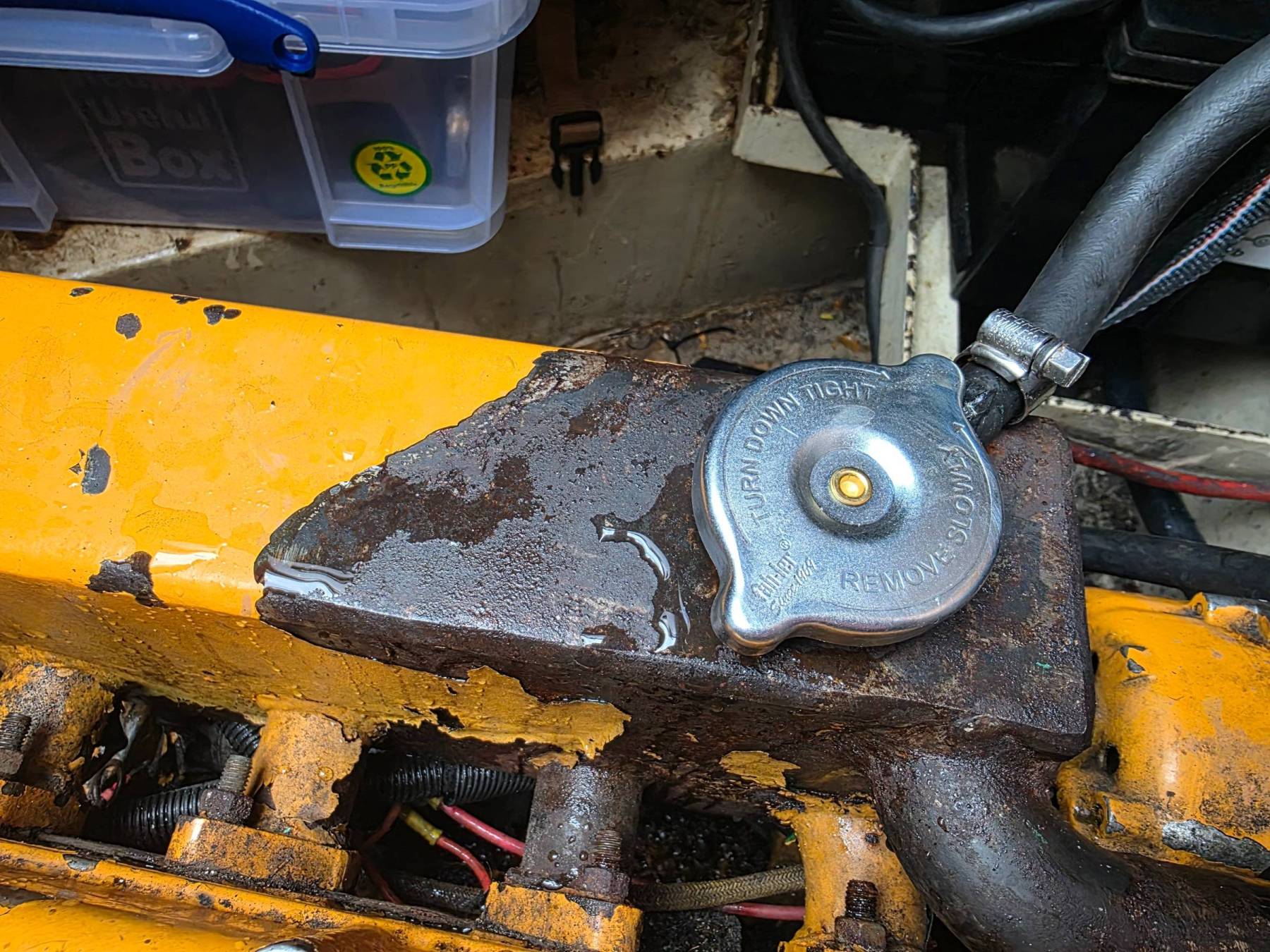

I hope someone on here can help. I have had a coolent leak, which I fixed. Fingers crossed 🤞.  But I am trying to put the blanking cap back on after filling the system back with coolent, and it just keeps leaking. The seal on the original was completely gone and it looks as though the previous owner had used silicone to reseal it. So I have bought a new one, and I am having the same issue.
Any suggestions?
What sealant would I use if went down the sealant route, the same sealant as the would use on the stove?

Does your new cap have the 'spring' underneath ?
OIP.mg-jTLW57Tjl3pxPGQXrRQHaHa?w=202&h=2
The reason that the small hose is coming of the side is so that as the water expands, the spring lifts and allows the water to flow up the hose inti the expansion chamber (you do have an expansion chamber ?)
If you have got a 'blanking cap', then as the water expands it cannot get to flow up the pipe and it must go somewhere so it squirts out under the cap. Nothing you do will stop it.
No the cap is flat. No spring20250320_133121.thumb.jpg.60cf8474f79736aea7759627b0aa94b4.jpg

I have just retried with one with a spring,  but the pipe inlet blocks it.

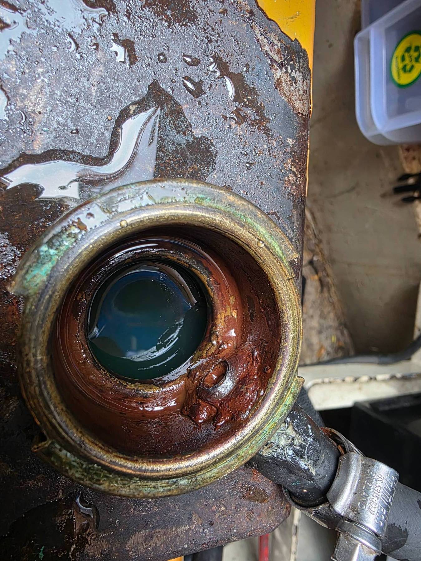

That pipe is a bodge repair, the pipe is too far into the neck.

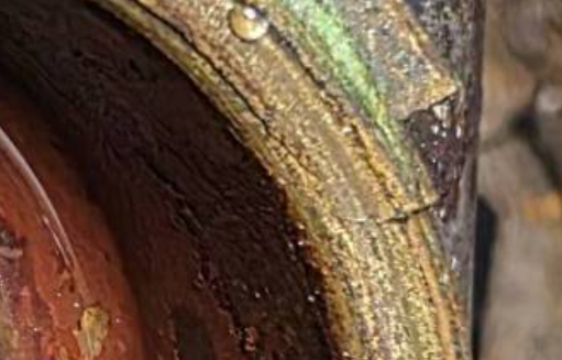

It looks to me as if the filler neck has split on the turn-over at the top at about 2 o'clock on the photo, so it will never seal. So you either need to get the little pipe resoldered in its correct position, then a normal pressure cap will seal on the bottom of the neck, or you need a new filler neck.

Agree. But if the OP has a separate header tank, there still needs to be a seal on the top of the filler neck. The metal to metal of a standard pressure cap won't cut it.
True, but depending upon skin tank volume, the manifold tank might be enough as long as the level is kept low. That would solve the overflowing problem, but not utilise the expansion tank. I am not sure how the filler neck is fitted, if it bolts or screws on that would be an ideal change, but if glued in place the change could be difficult. The OP could get a pressure cap with rubber under the cap to seal the neck, but as soon as the coolant expanded past the lower seal, it would still leak through that crack.
If the manifold is taken off, inverted and one could get the underside of that top flange clean enough, I think there will be a groove that could be filled with solder to seal the leak. I don't think it would last if done from the top, and it would need better soldering than that shown on the pipe joint into the neck. Maybe even a lowish melting point silver solder.

Some Vetus engines, I assume it is Vetus by the gold paint, have a hexagon plug in the top of the thermostat housing. If (and it is a big if) the OP's is like this, then the hose on the filler neck could be removed and reattached to an adaptor in the plug thread.   Then the application of a blow torch should melt the solder to allow the pipe stub to be removed from the neck, then a high pressure spring type cap would seal on the bottom of the filler neck while keeping the header tank in use. The pressure would not be important as long as it is higher than the one on the expansion tank.
You are right, there is a split on the top. It splits into the neck and then runs left. I did not see that.
Now it make sense  that the cap with the new rubber gasket would not seal.

Don't have any direct knowledge of the manifold tank concerned but could it be the seal between the filler neck and the manifold tank itself? I had this on a Polar manifold tank some years ago. In the end I had to replace filler neck complete with a new gasket. It wasn't a straightforward job.

It certainly is cracked and the crack seems to be not just at the 2 o clock position but propagating around the top of the filler neck. I agree there is no surprise this is leaking. Looks like its been leaking some time as evidenced bu the missing paint. Sooner or later it will fail altogether.
