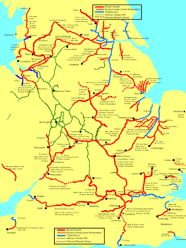

smiler Posted March 16, 2025 Report Posted March 16, 2025 Hi all Question for "the collective". I know there is a north/south restriction regarding length of narrowboat access(57ft). What are the restrictions for a shorter widebeam, say up to 50ft long x 9ft beam on the UK canal system? Not only lock sizes, but how much of the system isn’t accessible (or even "comfortable" to access) with a wider beam? Thanks in advance for your replies.

Alan de Enfield Posted March 16, 2025 Report Posted March 16, 2025 (edited) 1 hour ago, smiler said: I know there is a north/south restriction regarding length of narrowboat access(57ft). The North / South divide is caused by width - not length. The cut off is because of 'single width locks' (ie around 7 foot beam boats) and 'double locks'. A 9 foot beam boat gives you ther worst of both worlds - you cannot pass thru' single locks, and you don't have the benefits of more space given by a (say) 12 foot widebeam. With a boat over 7 foot beam you cannot get North of, roughly, South Birmingham / Coventry / Northampton without going out to sea and back in Edited March 16, 2025 by Alan de Enfield
smiler Posted March 16, 2025 Author Report Posted March 16, 2025 1 minute ago, Alan de Enfield said: The North / South divide is caused by width - not length. The cut off is beacuse of 'single width locks' (ie around 7 foot beam boats)and 'double locks'. A 9 foot beam boat gives you ther worst of both worlds - you cannot pass thru' single locks, and yo don't have the benefits of more space given by a (say) 12 foot widebeam. With a boat over 7 foot beam you cannot get North of, roughly, Birmngham without goig out to sea and back in Thanks Alan. I thought the north/south divide was due to length, not width - so my question is answered, thank you - standard 6'10" it is then. 👍 I plan to be a CCer, not a CMer and want to see most of the UK canal system in my upcoming retirement. Hiring cranes/transport to jump the restrictive parts doesn't outweigh the benefits of a slightly wider narrowboat for me. 4
alan_fincher Posted March 16, 2025 Report Posted March 16, 2025 2 hours ago, Alan de Enfield said: The North / South divide is caused by width - not length. The cut off is because of 'single width locks' (ie around 7 foot beam boats) and 'double locks'. A 9 foot beam boat gives you ther worst of both worlds - you cannot pass thru' single locks, and you don't have the benefits of more space given by a (say) 12 foot widebeam. With a boat over 7 foot beam you cannot get North of, roughly, South Birmingham / Coventry / Northampton without going out to sea and back in Pedant alert! You can't, of course, get to Northampton in a boat over 7' width. (although you can get approximately 5 miles from Northampton).

Alan de Enfield Posted March 16, 2025 Report Posted March 16, 2025 46 minutes ago, alan_fincher said: You can't, of course, get to Northampton in a boat over 7' width. (although you can get approximately 5 miles from Northampton). But I did say 'roughly' South Birmingham - Coventry - Northampton

IanD Posted March 16, 2025 Report Posted March 16, 2025 (edited) 4 hours ago, Lady M said: Did the OP mention 57'? I must have missed that. I was responding to the point he made that he thought the north/south divide was due to length not width. Yes, in the very first post -- and he specifically also asked about a 50' x 9' wideboat... 🙂 9 hours ago, smiler said: Thanks Alan. I thought the north/south divide was due to length, not width - so my question is answered, thank you - standard 6'10" it is then. 👍 I plan to be a CCer, not a CMer and want to see most of the UK canal system in my upcoming retirement. Hiring cranes/transport to jump the restrictive parts doesn't outweigh the benefits of a slightly wider narrowboat for me. The "57' length restriction" applies to some Northern canals, the Calder & Hebble has the shortest locks you're likely to encounter. The official maximum length for these is 57'6", so long are you don't mind getting damp occasionally. They're wide locks so with considerable care (and by getting even wetter) a narrowboat up to 60' can get through -- I've done this as have several others who post on CWDF -- but this isn't recommended for beginners, hence the more common "57' maximum" rule. https://www.penninewaterways.co.uk/calder/locks.htm Edited March 16, 2025 by IanD 1

dmr Posted March 16, 2025 Report Posted March 16, 2025 and it must be said that some of the most attractive and interesting canals are narrow T&M, Shroppie, Caldon, Macc and Peak Forest to name a few. 3
IanD Posted March 16, 2025 Report Posted March 16, 2025 (edited) 8 minutes ago, dmr said: and it must be said that some of the most attractive and interesting canals are narrow T&M, Shroppie, Caldon, Macc and Peak Forest to name a few. And the HNC if it's open and you really like locks and *long* tunnels... 😉 Edited March 16, 2025 by IanD
dmr Posted March 16, 2025 Report Posted March 16, 2025 3 minutes ago, IanD said: And the HNC if it's open and you really like locks and *long* tunnels... 😉 The Staffs ane Worcester, Birmingham and Worcester and parts of the BCN too, and the Stratford.
