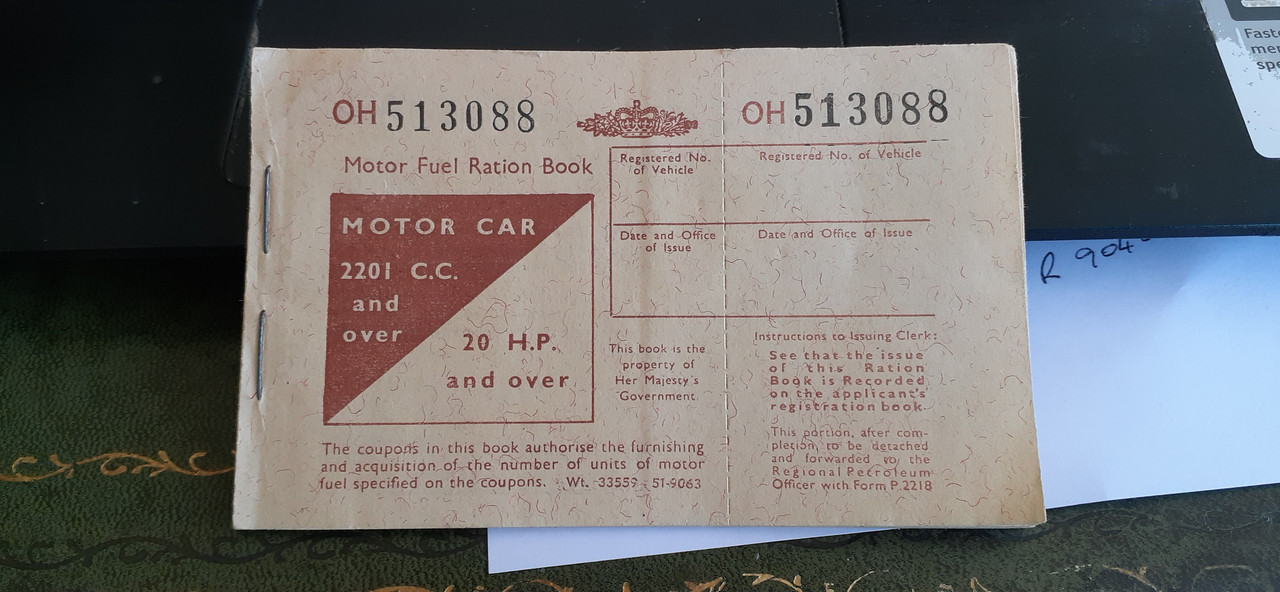

I still have my petrol ration book from 1973 issued but never actually needed.
The ration depended on the HP of your vehicle mine is "20HP and over", or by engine size "2201 CC or over"
I cannot remember which car I had at that time - it was either a 3.3 litre Vauxhall Cresta, or a V6 Ford Zodiac
