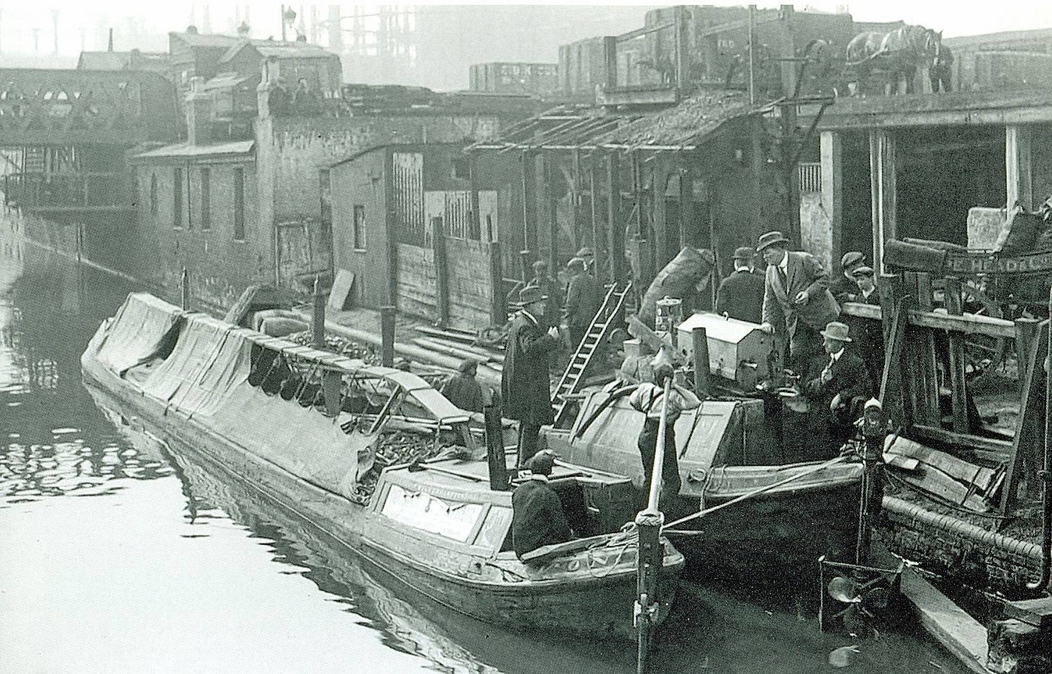

David Mack Posted February 19, 2025 Report Posted February 19, 2025 (edited) This image of Barnes and (probably) Belfast at Tyseley Wharf, taken in 1944, shows the standard Grand Union gear wheel on the right and a lever speed control on the left which appears to move horizontally to vary the speed. I believe this was the original arrangement on the Woolwich boats, although most were later changed to speedwheels. https://www.iwm.org.uk/collections/item/object/205201191 Edited February 19, 2025 by David Mack

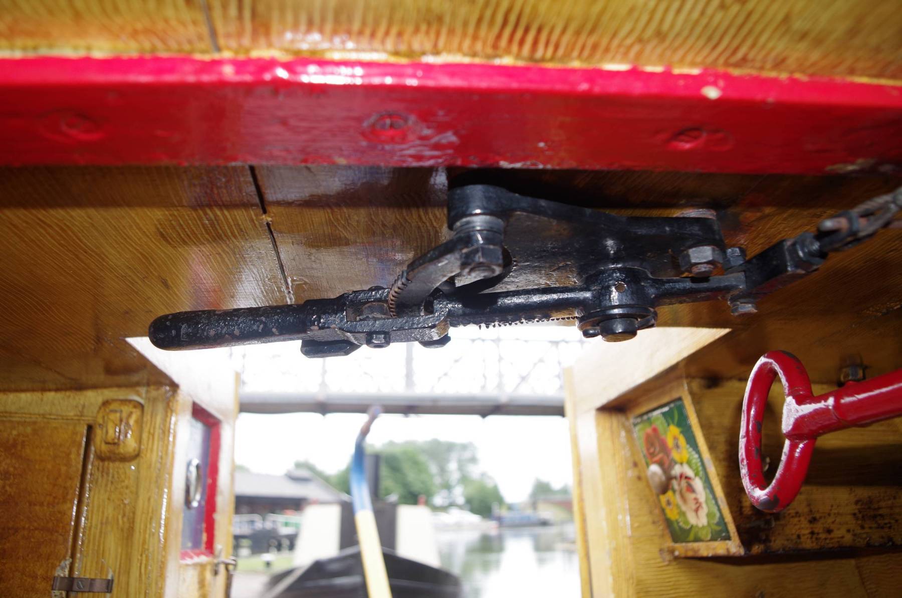

Ray T Posted February 20, 2025 Report Posted February 20, 2025 This, on Mendip, if my memory serves me correctly.

Tonka Posted February 20, 2025 Report Posted February 20, 2025 1 hour ago, Ray T said: This, on Mendip, if my memory serves me correctly. Had one of those for the throttle on Adele, had a gear lever which came up from the step which you pushed forward or back
Speedwheel Posted February 20, 2025 Author Report Posted February 20, 2025 (edited) Thanks all, Having had different controls on different boats over the years, I'm looking for some options and just wondered if there was anything that historically might have been used but had been largely lost in the mists of time. 4 hours ago, Ray T said: This, on Mendip, if my memory serves me correctly. That's rather good. I had a far less fancy version on Satellite. Edited February 20, 2025 by Speedwheel midst vs mists

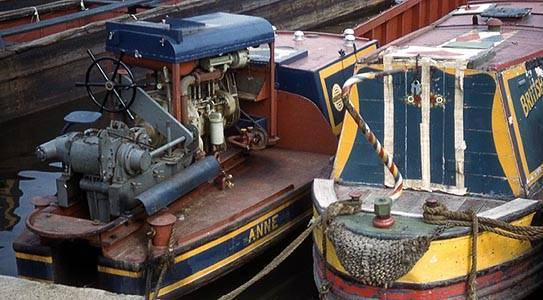

Ray T Posted February 20, 2025 Report Posted February 20, 2025 (edited) Speedwheel, you could try one of these! 😁 Or something different, Anne. Edited February 20, 2025 by Ray T 1 1

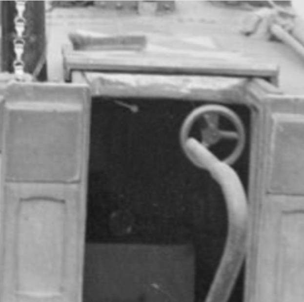

Derek R. Posted February 21, 2025 Report Posted February 21, 2025 Must be several variations of this, but TYCHO's 'other end' of the speed wheel.
