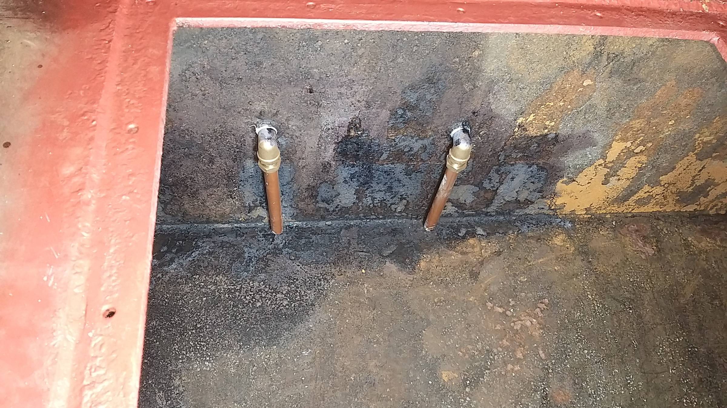

matty40s Posted February 14, 2025 Report Posted February 14, 2025 It is well worth a look inside, you might have a shock.... 1

matty40s Posted February 14, 2025 Report Posted February 14, 2025 5 minutes ago, ditchcrawler said: Its when you leave the hose running but the tank never gets full Or...you never need to use a hose, it never gets empty.... 2

matty40s Posted February 14, 2025 Report Posted February 14, 2025 Believe me, this was bad, the two water out pipes fell off when we pressure washed it...we had to fabricate new...
