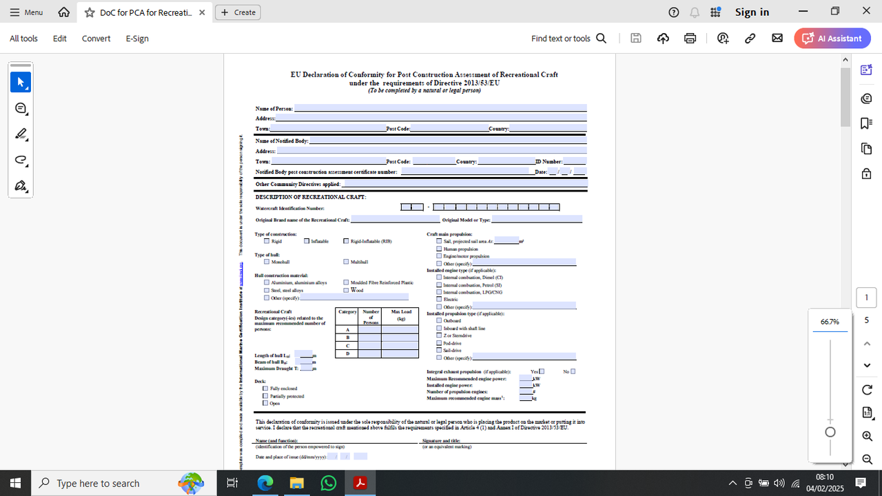

9 hours ago, Alan de Enfield said:
If it does not have a certificate of compliance from the builder from when it was put into use, then it must have a PCA before it can be sold or transferred.
What does this certificate of compliance look like and how might a buyer check it is not a forgery?
I cannot post the Pdf as it appears to be too large for the forum, but, a screen shot that might enlarge enough to read ;
It has to be signed by one of the two authorising companies (notified bodies) and the examiners number givenso it can easily be checked for authenticity.
Page 1 of 5
Edited by Alan de Enfield
It has to be signed by one of the two authorising companies and the examiners number given
Page 1 of 5
Thanks.
But thats a PCA, not an initial Certificate of Compliance which could have been issued up to 27 years ago.
My concern is the type of boat seller inclined to offer a doctored survey report might also not be too concerned about issuing a Certificate of Compliance they made up in Photoshop.
How would a potential buyer go about verifying a supposed PDF scan of say, a dog-eared 25 year old original Certificate of Compliance?
Edited by MtB
Delete a redundant word
29 minutes ago, MtB said:
Thanks.
Apologies, I thought you wanted to see a PCA.
Here is an original "Written Statement of Compliance (multilingual)
Again, signed by the authorised signatory of the 'Approved body' and his position (not the manufacturer)
