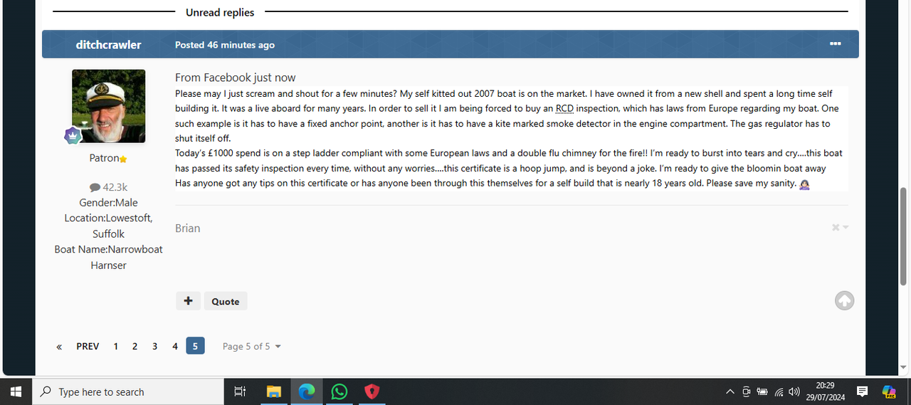

But @Alan de Enfield, those despairing FB posts are both from somebody who wants to sell via a broker who insists on RCD compliance, not privately or via a broker who doesn't.
Which is entirely his decision, but is not a legal requirement, is it?
As various brokers have said, it is perfectly legal to sell or buy a secondhand boat without these documents, even though the trade body (and some brokers) insist on it this is their decision not the law.
