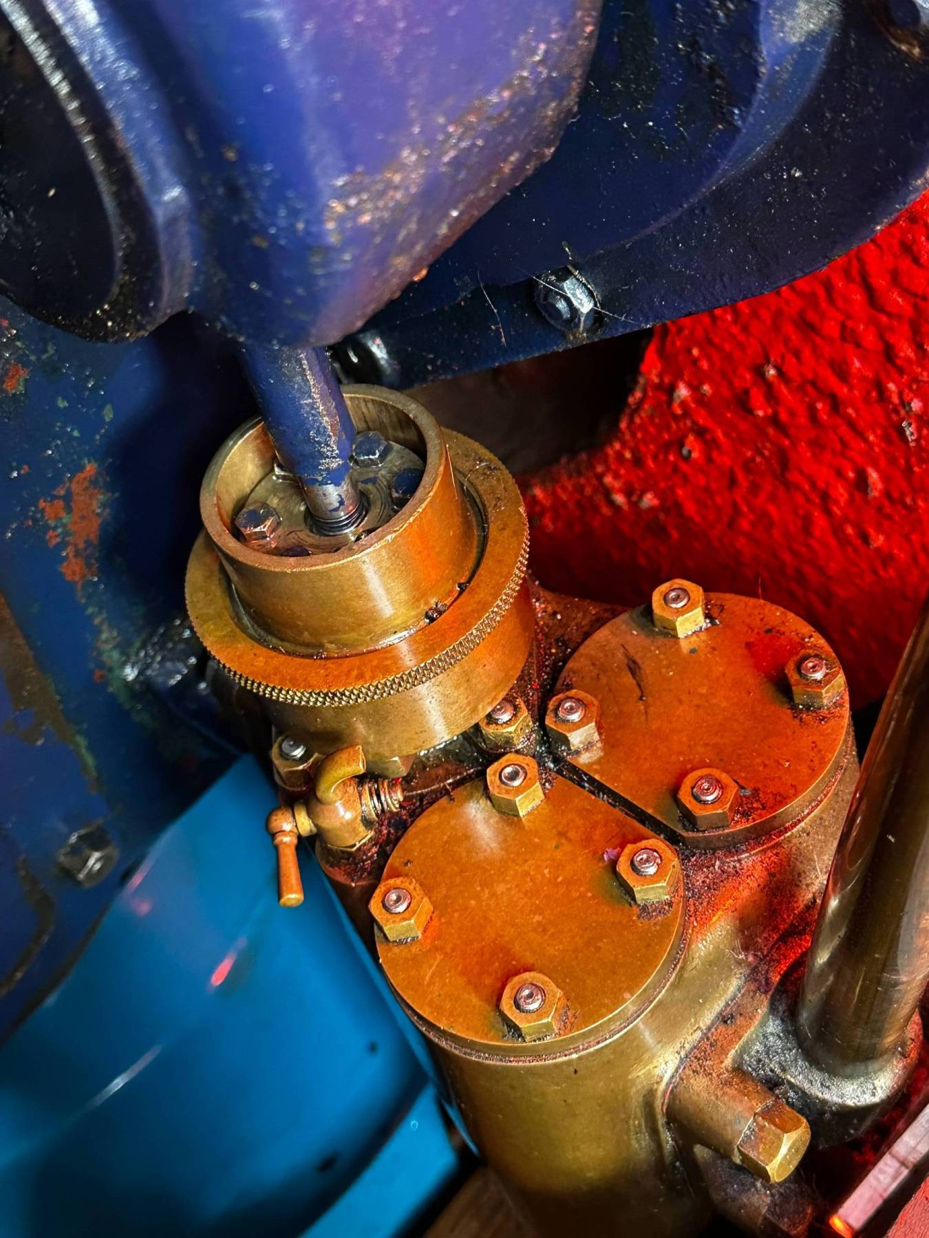

BEngo Posted February 2 Report Posted February 2 If it is not a hose, my money would be the water pump packing, provided it is the single acting type pump. The piston tends to wear so it is hour-glass shaped, so if not left fully up or fully down water can seep past, especially if the valves are a bit tired.. The good news is that it usually only drains the engine. Start it, refill the header tank with mixed antifreeze and then go round all the pipe and water joints with a sheet of big blue bog roll, or kitchen towel. Include the core plates on each cylinder- these have a nasty tendency to rust away internally where the studs are fixed. You will soon see which are damp. Then look at the water pump. The water seeps out of the packing and if leaking it can be seen running alomg the flat part between the follower ring and the ccrankcase. Changing the hoses generally involves removing all the pipework on the cylinders. It is a reet PITA. N 1

BEngo Posted February 3 Report Posted February 3 The original water pump packing was 3/8 in sq. The piston diameter was 2 in and there is only enough room for two packing rings. That means you need about 18 in of packing to do the job. It is easier to get the piston back in if you slightly flatten the packing before fitting it. The follower will bring it back to shape when you tighten down. N 1

BEngo Posted February 3 Report Posted February 3 Yes, but Have a look at ghe parts book to see how it all goes together. Set the WP crank at TDC. Undo the locknut on the connecting rod. Undo the ring Unscrew the piston rod from the connecting rod Push the piston down. Rock the conn rod out of the way. Pull piston and piston rod out. Reverse to reassemble. You may need to turn the engine to move the conn rod back down before the piston rod will screw in. N 1

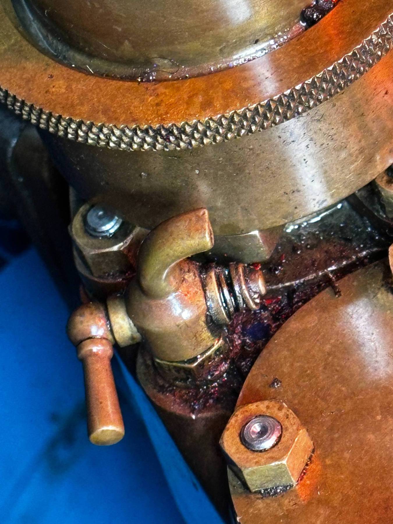

Floaty Me Boaty Posted February 7 Author Report Posted February 7 Hi All, Thursday's visit was eventful. Once i had cleaned all the water up and dried her out, i went through all the checks recommended by you all, thank You, and once i had refilled her, i could hear a spitting noise when turning her over. On further inspection, the Drain Cock on the pump had somehow been knocked open. All other checks were good apart from the fact i couldn't find any pump packing in the toolbox. I will contact Tom later today to see if he can come down and re-pack the pump as it is no good me stripping it down on Monday, only to find i cannot finish the job.
