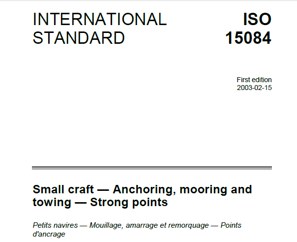

46 minutes ago, Gybe Ho said:
BSS approved attachment of bow T mooring cleat
I'm pretty sure that the BSS doesn't cover the 'bow T mooring'. I think you mean in compliance with the RCR and the ISO
