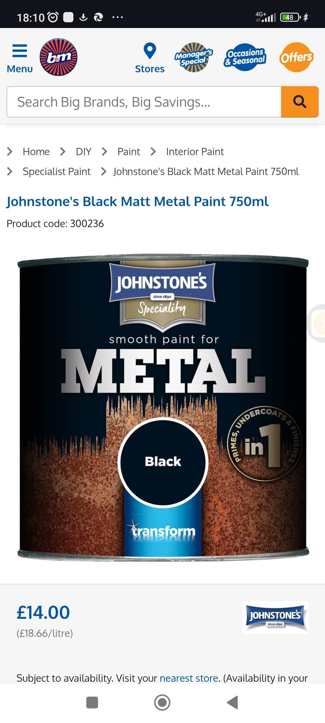

MrBadger Posted January 8, 2025 Report Posted January 8, 2025 Hi! I am interested in blacking my boat myself it is 40foot. Can anyone recommend me some places or brands that would do the job and perhaps how much paint I would need please? Interested in this two pack epoxy too but I find it confusing! Added a brand here is this any good? Appreciate the advice! Hannah
Mike Hurley Posted January 9, 2025 Report Posted January 9, 2025 That is not boat blacking, you need a bitumen type or epoxy 2 pack paint. I think normal bitumen is about 50 quid for a 5 litre tin. If you go 2 pack you ideally need to grit blast the hull as 2 pack wont stick to bitumen. Do you know what is on there now?
