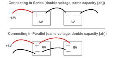

Alan de Enfield Posted January 8 Report Posted January 8 10 minutes ago, Tony Brooks said: I note that the OP runs an inverter, that makes me suspect those times may be a bit low for winter. Yes you are probably correct.. @Ramlin Rose I think you need to get the engine running and leave it running for at least 8 hours. start at a 'fast tickover' (maybe 1220-1400 rpm) and as time goes by you can slowly reduce the revs. Don't forget that it is prohibited to run the engine between 8pm and 8am. What sort of electrical monitioring gauges / equipment is fitted in the boat - Picture would help. If it is simply a volt meter plugged into a cigarette lighter socket (for eample) that is useless. Depending on how batteries are connected you can get : 2x the voltage of one battery, or 2x the Capacity (Ah) of the battery but with the same voltage.
Ramlin Rose Posted January 8 Author Report Posted January 8 Thanks @Alan de Enfield for the diagram, I will have a look at how they are connected. I'll send photos of the monitoring thing (what I'm calling the indoor display).
