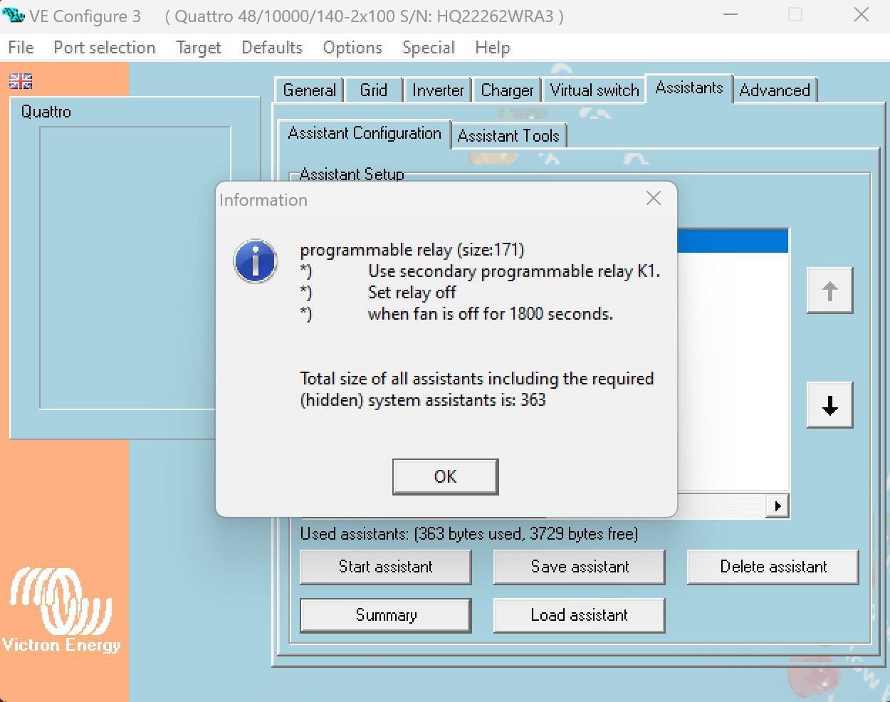

If all you want is electric cabinet cooling fans there's a much easier way, use the Victron fan assistant on the combi via one of the inbuilt relays to turn external cooling fans on at the same point the ones inside the combi come on, all you need is a fan and a wire. Does a much better job of controlling the combi temperature, fans are turned on when the combi decides they're needed because it's getting warm.

You can fit a temperature sensor to one of the Cerbo temperature inputs and a piezo buzzer to the Relay 2 output (it should be below the small allowable current rating of the relay) and program Relay 2 to work on temperature from that sensor.
I found one such piezo buzzer, it was rated at 103 decibels! That is dangerous to human hearing and might make it too painful to approach the electrics cabinet to investigate the heat source.

Your input is much appreciated. With a Cerbo and Multiplus already in the budget, it will not cost much to enable the capabilities already present in the Victron kit as you described. I suspect that hot electrical cabinets will become more of a thing as higher powered gear is shoehorned into typical corner electrical cabinet on a narrowboat. My intention is to design in a solution for this problem from the start rather than deal with it once the problem becomes evident. The RV / Motorhome community is ahead of we narrowboaters on this matter because they design for smaller spaces.
One tip I got from @IanD was the presence of an external fan connector on the Quattro and presumably the Multiplus. This sounds useful because the first sign of overheating will be the Multiplus increasing the internal fan speed and signaling the external fan connector.
All this stuff costs a few extra pennys to enable, if only I could find the hood style fan as shown in the RV fitout video I linked to a week ago in this thread.
