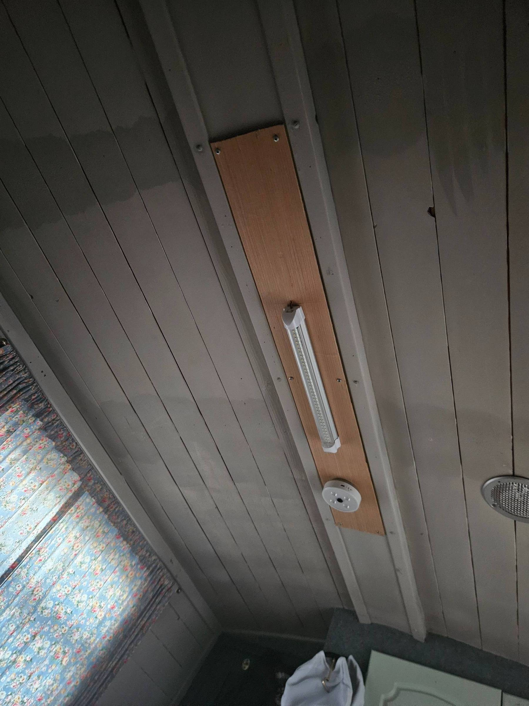

Hi,
I assume it's condensation when it's cold but how do I stop it happening? My roof above my bed drips on me during the night. I don't have a clue how to stop it.
6 minutes ago, Rod Stewart said:
Probably caused by uninsulated cross members as you say. The only real solution is to insulate them.
How do you do it? Is it a rip out job?
Remove the paneling to expose what is behind it, possibly bare steel, add insulation and put panelling back.

1 minute ago, magnetman said:
Is the Boat properly ventilated and heated?
I think so I have mushroom vents up and heated by a stove in day
If you live on the Boat or use it a lot during winter it should ideally have a multifuel stove. Occasionally it can be good to really get it going and warm the whole Boat up properly. They work as a dehumidifier if the Boat is also properly ventilated.
Some people call it a draught. I call it air.
ETA you have a stove. Thats good.
Is there flow of ventilation air from front to back as well as the mushroom vents? Door vents or similar.
As Alan says, take it down, add insulation replace. I had the job of doing just that on a 60 foot boat. I suppose you could fit another ceiling on top of that one but I would not recommend it.

8 minutes ago, Alan de Enfield said:
Take the ceiling down, add insulation, replace ceiling.
Is there a special type of insulation or is it a rock wool type
If you take the inner grill off that mushroom, you might access the insulation to see what type it is. If you can get a torch in there, you might be able to see the extent of the problem if there is no obstruction in the way.
