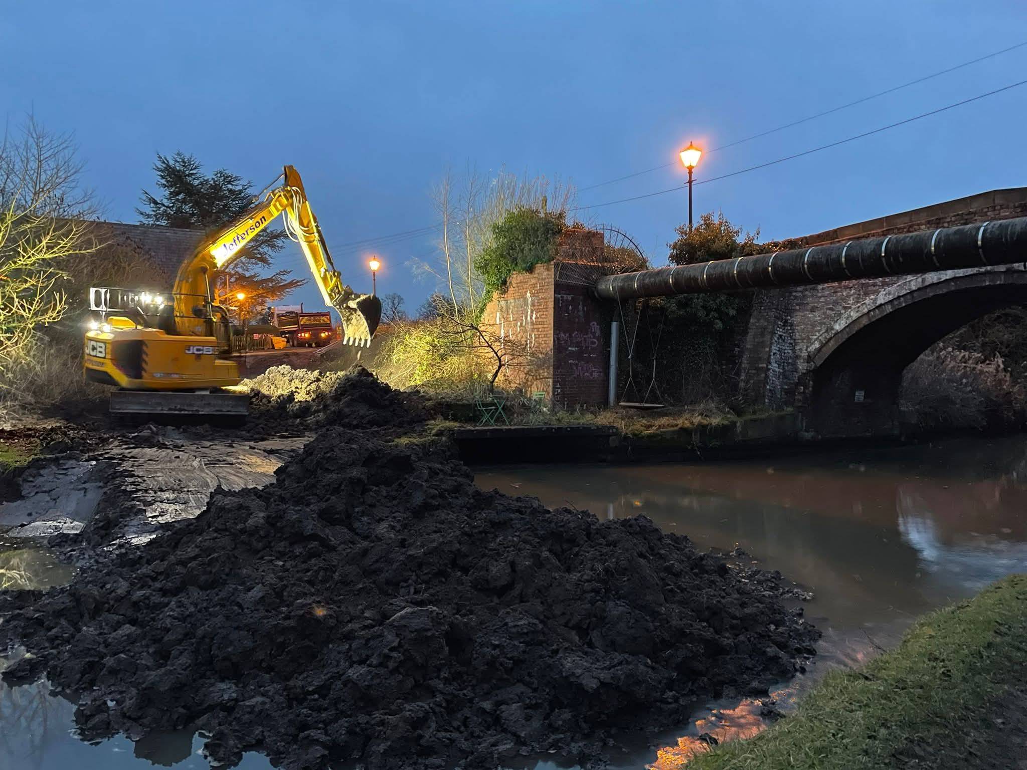

I was stuck behind that contraption at 19 o'clock this morning. It came on a low loader from Warrington. Would have expected it to have done the job in less than an hour. It's got a serious bucket on it.
That's Dunham school bridge so one further away from the breach than where they put the stop planks in.
