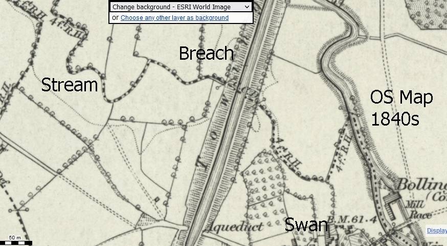

Non canal man here. I am familiar with the area and eventually I found a current map with the stream showing on east side of breach, the oldest OS I could find (1840s) just labels a "hedge"there--but the hedge does appear to follow that stream. I can`t source a detailed map PRE canal (late 1700s). No doubt again the legal profession will be the winners in this mishap.
Nice to find your site and see the drone footage ahead of the MSM.
I best ack. the OS map copy I suppose even though "open"
