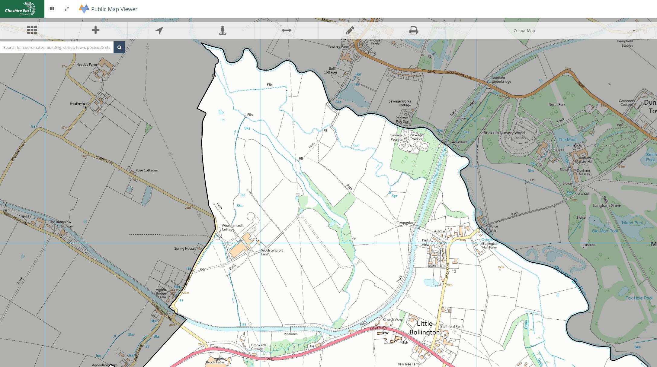

13 minutes ago, Liam said:
Was there any mention of an old culvert that goes under the canal which may of failed? Apparently that is under Warrington Borough Council's jurisdiction so here starts the arguments!
A spit of Cheshire East covers this part of the canal. Unlucky for them.
https://maps.cheshireeast.gov.uk/ce/webmapping?&e=378220.01&n=364472.00&s=1600000.00&bm=oscolour
Edited by nighttrain123
Didn't see any marked on the old OS maps

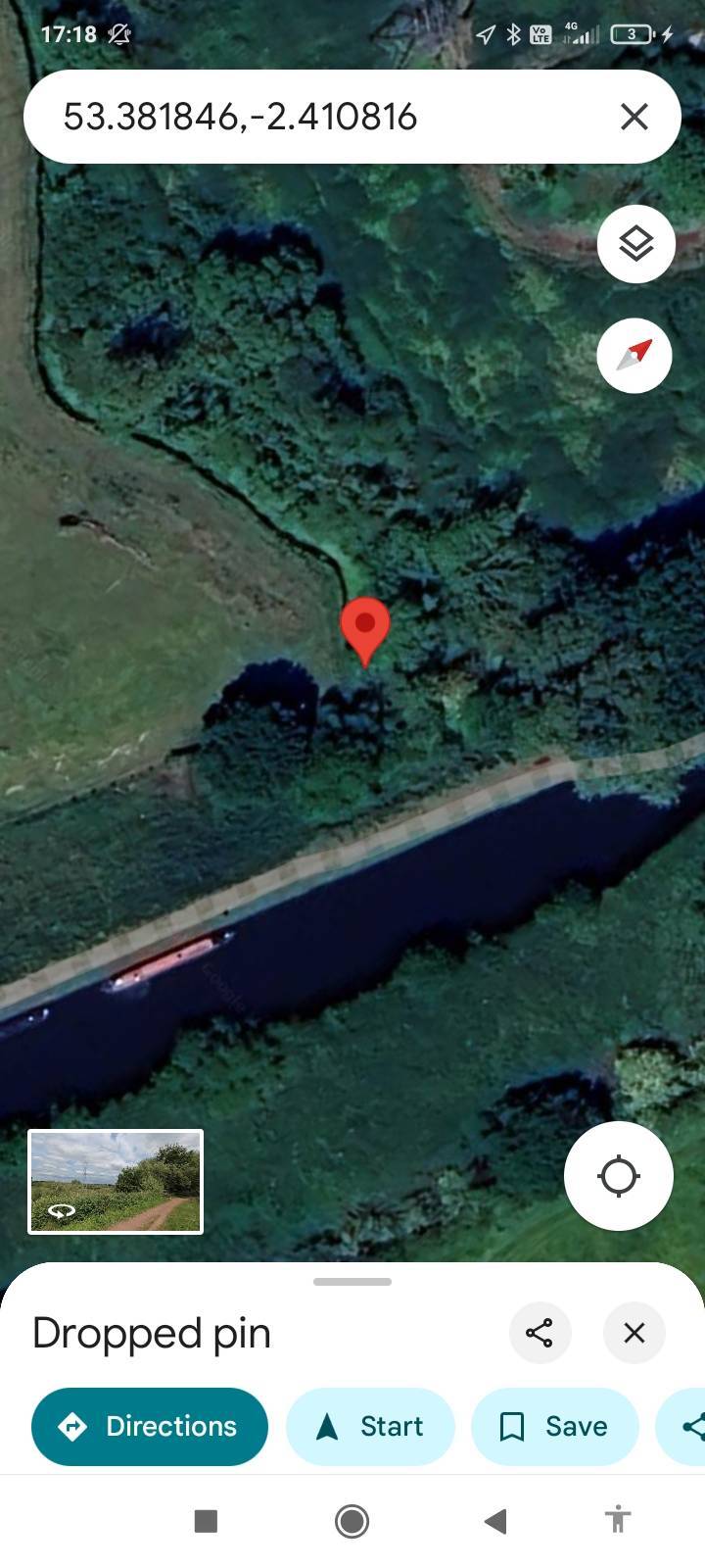

10 minutes ago, magnetman said:
This looks like a culverted brook.Screenshot_2025-01-01-17-18-57-651_com.google.android_apps_maps.jpg.5df2e87893cad9f68be3ba7254e9736c.jpg

Looks like the nearest  culvert might be at Agden brook 800m away, and then there is little bollington aquaduct, then the breach, then the river.

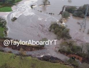

before (pylon visible top edge of image)
after
That little brook must come from somewhere. It just appears. Maybe it is going under the canal in a little tunnel.

Also looking closer to the canal on the satellite view there are round shapes. There isn't an old flood sluice is there?
Well yes, that is why everyone is going on about a culvert. The brook passes under the embankment, presumably. The flooding on the east caused a massive flow through the culvert which disintegrated and the embankment got washed away from underneath, at a guess.
Yes I know it is a culvert I wrote that in an earlier post. Its odd the brook does not come out the other side on the map. Maybe it is part of the embankment drainage or a flood sluice.

1 hour ago, Paul C said:
When I saw the piling collapsed inwards, I assumed that during normal (canal full) level, there is little/no force on the piling, with the weight of the water in the canal being balanced by the weight of the ground on the bank. But during the exceptional scenario of the canal being completely empty, the weight of the soil/ground (remembering it will be heavy and waterlogged too) would easily push it inwards. The canal may have failed there, or it may have failed much further downstream and the water flowed away.
The piling hasn't been pushed in by the weight of the ground behind. The piles extend way below the normal canal bed level, but as a result of the breach the canal bed has been eroded to a much greater depth and all the ground around the bottom of the piles has been washed out, leaving nothing to hold them upright.
47 minutes ago, David Mack said:
And the money!
Apologies, the bit I needed to see was behind the copyright notice. Now there's another video, I can see what you mean now.
