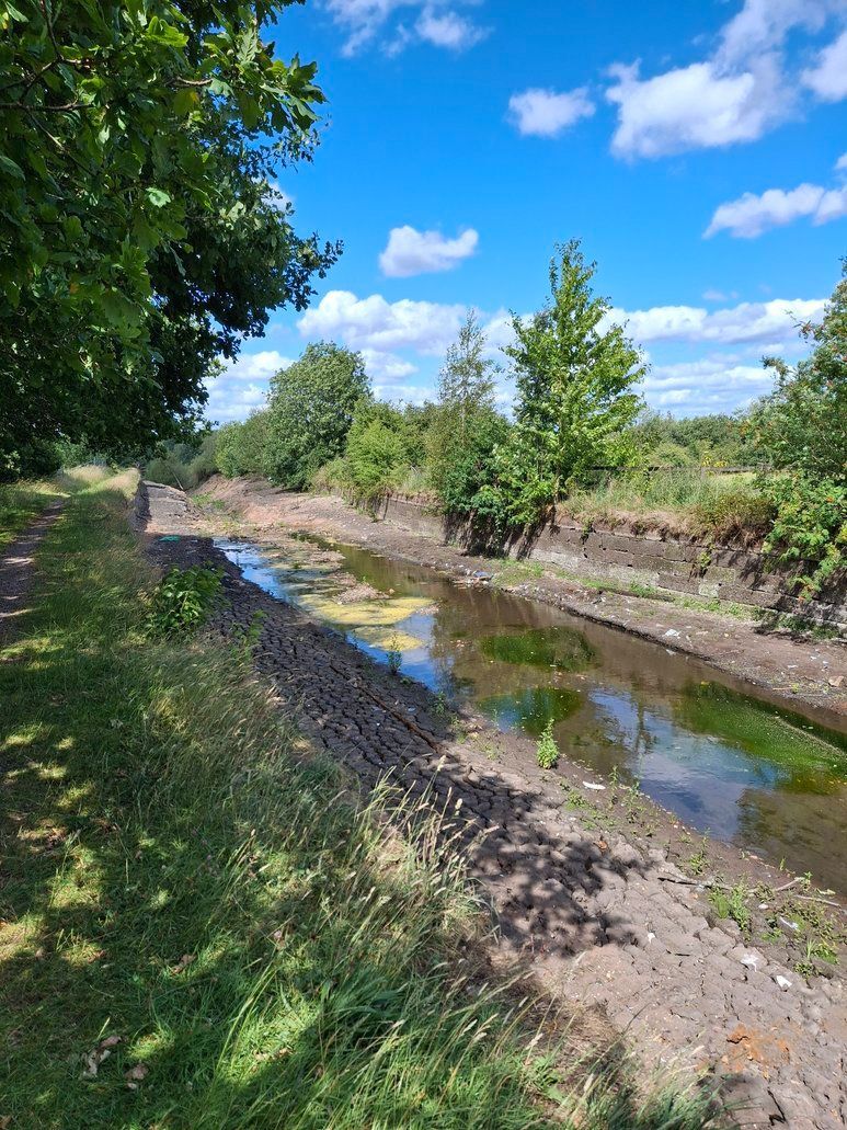

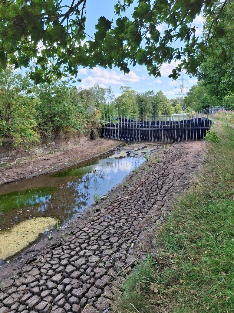

Below the fabric dams on the breach side of Little Bollington winding hole. This is where I saw the surveyors working.
View from the fabric dams towards Bollington underbridge and breach
It looks to me like the clay lining has dried out, shrunk and cracked. Is this going to be a major problem if/when the canal gets fixed? and more concerning, is this happening all over the system now where canals are empty?
The base of the basin at Circus Field cracked quite extensively whilst the rest of the moorings were being bullt.  The cracks took up after a time, once the wzter was let in.  It was several weeks though before you could not clearly feel them with a shaft.
On the Bridgewater I expect they will perforce get a good going over from heavy machinery whilst the rebuild is done so will probably take up a bit faster.  The rebuild might even include a run over with a sheeps foot roller  to deliberately knead any clay base.

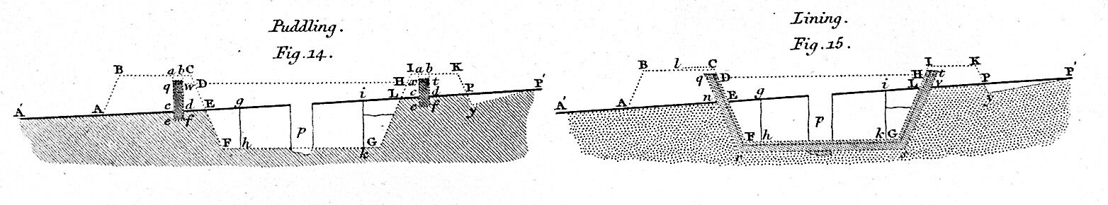

Puddle clay is a lot thicker than you might expect at about 2-3ft, and there'll be a layer of silt on top of that. I doubt those cracks penetrate far enough to be a problem.
2 hours ago, Francis Herne said:
Puddle clay is a lot thicker than you might expect at about 2-3ft, ...
That seems to be a very large amount of material which was presumably transported over land.
Where did they get it all from ?
5 hours ago, Francis Herne said:
And quite rightly, given this week's announcement that the remaining T&M locks at Middlewich are to close on Tuesday!
Thursday.  Not Tuesday.
Alistair did a search for me and suggested that in some cases Brindley may have deliberately routed canals through areas known to have adequate clay supplies to avoid the logistics problems.
The thickness of canal lining all depends upon what was used. The clay which we see as normal today would have been too expensive to transport any distance by road. Some was carried shorter distances on partly-finished canals, when there was a foot or two of water prior to the side lining being installed. Lining was the more usual term for the water-retention layer as puddle referred to clay used in a trench to stop seepage under any earth bank built over, as per the image below. From the research I have done, it seems that the main canal lining material was called 'semmel', probably from the German word meaning a collection. It described a loamy soil in which there were small stones, the Austrian canal engineer Maillard suggesting they could be as large as a pigeons egg. Such soil occurred naturally, and the exact canal route may have been altered slightly to find such soils, though deviations were only allowed within specific distances provided for in the canal's Act. Semmel was then laid down in layers of perhaps 18 inches and this was thoroughly pummelled before the next layer was added until the base of the canal was five to six feet thick. The sides were perhaps around two feet thick, and there certainly seems to have been problems in getting a good seal at water level initially. The amount of lining would vary depending upon the type of subsoil, and the level of the water table.
Clay, as we know it today, was used initially in specific areas such as where a puddle trench was necessary, and was probably introduced more widely for maintenance purposes after the canal opened, as then it would be possible to carry it long distances economically. I suspect that each canal company would have its own supply; the L&LC certainly had several clay pits, though eventually just the one on the Leigh branch was used, and not just for the L&LC in BW days.
Yes, looking again I reckon that its silt, its the right colour for silt and in the right place for silt to deposit.
I suspect that 2 to 3 feet is a bit optimistic in some places.
