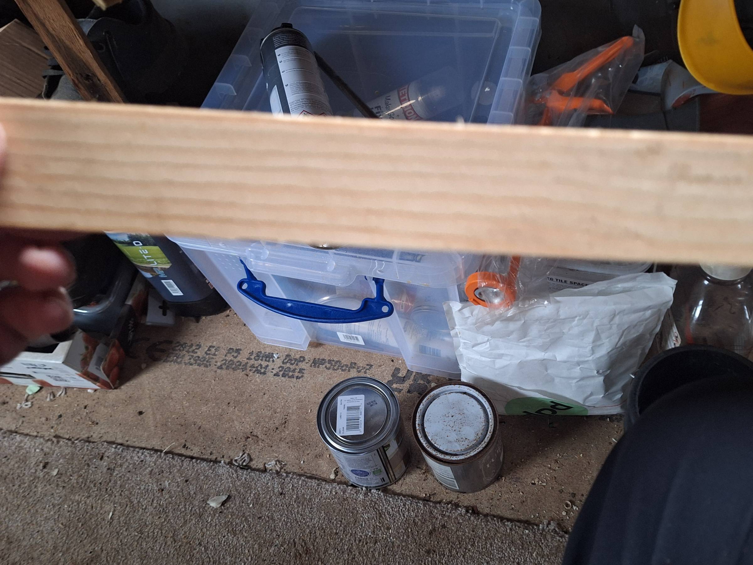

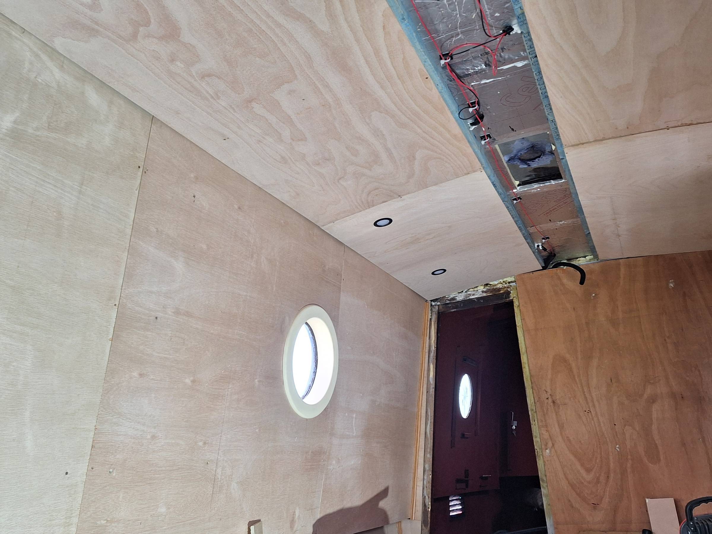

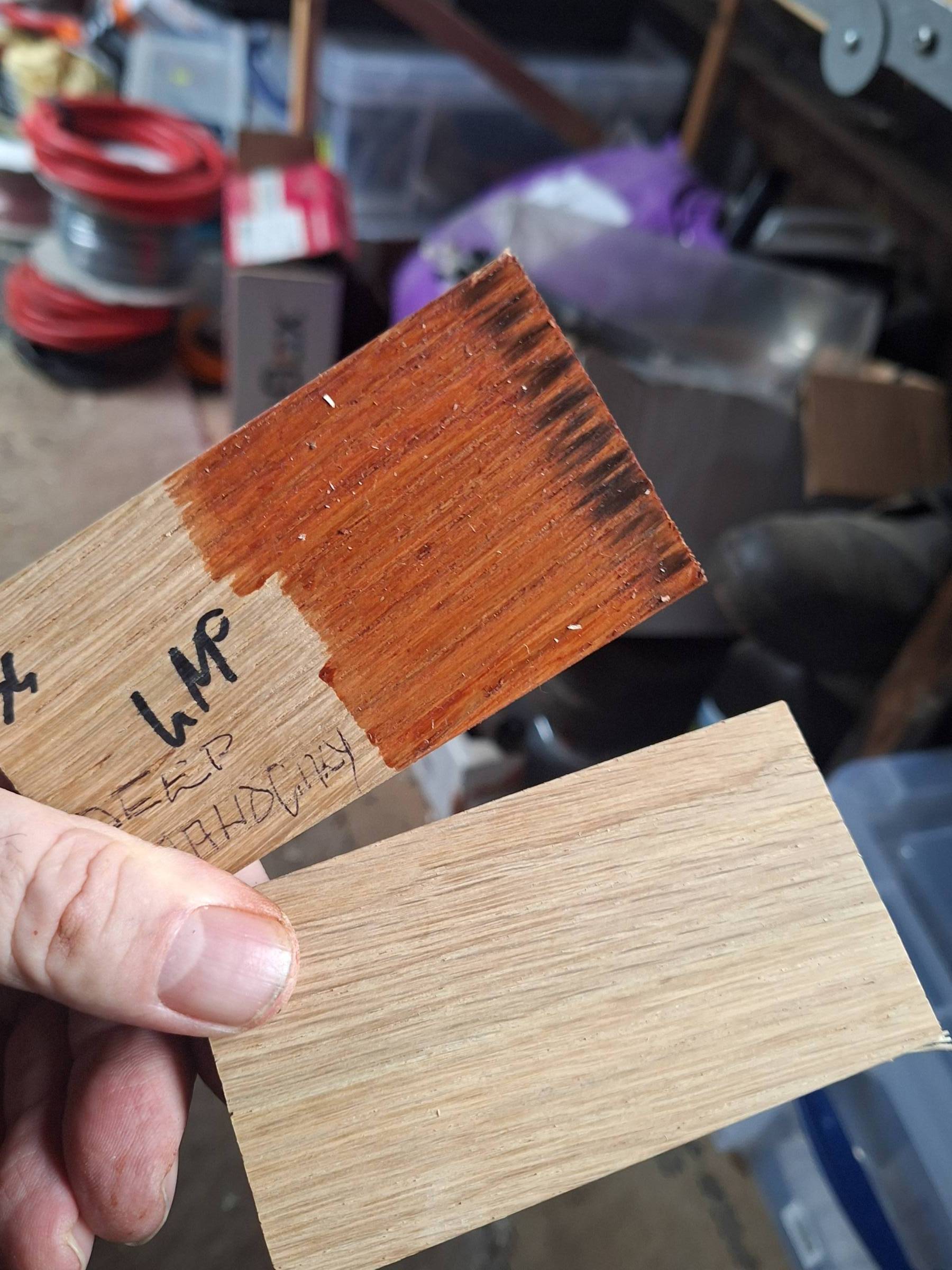

Manxcat54 Posted December 27, 2024 Report Posted December 27, 2024 (edited) Hi Bit of a dilemma on what to use and what colour of stain/varnish, I bought some 60mm x7mm oak flat, but it feels overpowering when I try it, I also have 36mm softwood and that looks less overpowering, I will probably paint the ply lining in a cream shade, but cannot decide on a contrasting colour for the trim, can anyone offer decent advice please. Edited December 27, 2024 by Manxcat54

blackrose Posted December 27, 2024 Report Posted December 27, 2024 (edited) You're asking for advice on which shade of wooden trim to use? Surely that's all down to personal taste? It's like someone asking if they should paint a room in their house white or magnolia. Only you can decide. I would use the oak without any stain and a clear satin yacht varnish, but you've already decided the oak is "overpowering", whatever that means to you. Edited December 27, 2024 by blackrose
Russ T Posted December 27, 2024 Report Posted December 27, 2024 (edited) If you do go for varnish/stain, don't forget, it is likely to get darker over the years as it ages. Obviously paint is a different kettle of fish.I always like to contrast light with dark, so maybe a shade of blue would work well with cream, but as said, it's all down to personal preference. Don't discount that at some point you might want to sell it, so painting it black inside might not be the best option. Edited December 27, 2024 by Rod Stewart
David Schweizer Posted December 27, 2024 Report Posted December 27, 2024 15 minutes ago, blackrose said: You're asking for advice on which shade of wooden trim to use? Surely that's all down to personal taste? It's like someone asking if they should paint a room in their house white or magnolia. Only you can decide. I would use the oak without any stain and a clear satin yacht varnish, but you've already decided the oak is "overpowering", whatever that means to you. Agreed. Even clear varnish will darken the wood a little, and oak will naturally mature over the years to a lovely golden brown.
Manxcat54 Posted December 27, 2024 Author Report Posted December 27, 2024 39 minutes ago, blackrose said: You're asking for advice on which shade of wooden trim to use? Surely that's all down to personal taste? It's like someone asking if they should paint a room in their house white or magnolia. Only you can decide. I would use the oak without any stain and a clear satin yacht varnish, but you've already decided the oak is "overpowering", whatever that means to you. Yes I know it's a personal taste, the 60mm oak is probably too big, maybe if I purchased some 35mm x 5mm thick, also with clear varnish, I did a tester and wasn't convinced, I was hoping someone would have a tried and tested set up, Maybe more fidlin about tomorrow.
David Mack Posted December 27, 2024 Report Posted December 27, 2024 Why not use the softwood trim and paint it the same colour as the ply.
Bee Posted December 27, 2024 Report Posted December 27, 2024 I would try routing the edge of the oak first, some sort of 'Ogee' profile although that can look fiddly or just round it off or something. That might take some of the heaviness out of the appearance. As for colours I find Farrow and Ball colours are good - I find one I like and then try to match it by mixing it myself from the stack of old paint tins in the shed or (a much better idea) find sheet of RAL colours from e.g. Black Country Paints and see what works. A light cream is a good colour to start with (well I think it is) 1

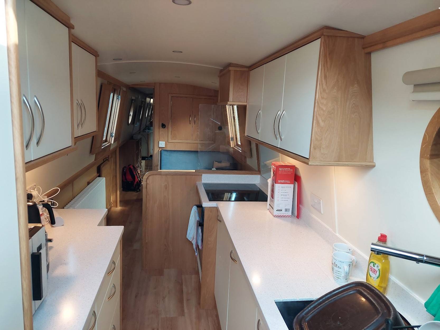

Manxcat54 Posted December 27, 2024 Author Report Posted December 27, 2024 37 minutes ago, David Mack said: Why not use the softwood trim and paint it the same colour as the ply. I want a contrast dark against light (I think) I have just returned home and I am going to look at some boat interiors, I like the shades on that ladies boat "The mindful narrowboat" I think her blog is named, I'm going to see, also look at the sizes of the trim, I have never had to do the interior of a boat before, it's nothing like a house or even a campervan.

LadyG Posted December 27, 2024 Report Posted December 27, 2024 I would keep any routing absolutely simple as fancy work will collect dust. As for staining, i would avoid this as long as there is some nice graining. Once done it cant be undone. I like a gloss clear varnish interior. Maybe a clear high quality epoxy might work.

Gybe Ho Posted December 27, 2024 Report Posted December 27, 2024 An Ogee profile would be a tad fussy on 7mm thick trim but taking the edge off would help soften the impact of a varnished trim. I find the red/orange tinge in the varnish finish to be too strong, how about a neutral wood oil. You cannot go wrong with a wood trim border around a painted cream panel, it is a classic for a reason. However I notice that your panels are not well aligned wall to ceiling and the porthole nearly collides with a panel edge so in that case an all painted finish is better. Go for the square edge shaker look on the trims with just a hint of rounding on the edge.
Peugeot 106 Posted December 27, 2024 Report Posted December 27, 2024 6 minutes ago, Gybe Ho said: An Ogee profile would be a tad fussy on 7mm thick trim but taking the edge off would help soften the impact of a varnished trim. I find the red/orange tinge in the varnish finish to be too strong, how about a neutral wood oil. You cannot go wrong with a wood trim border around a painted cream panel, it is a classic for a reason. However I notice that your panels are not well aligned wall to ceiling and the porthole nearly collides with a panel edge so in that case an all painted finish is better. Go for the square edge shaker look on the trims with just a hint of rounding on the edge. I reckon the fit of the ply is pretty good. He is planning to paint it and the trim is to hide the inevitable gaps. I’d be pleased with it if I’d done it. I’m not sure how you could get it to be a perfect fit without it taking ages and the boat will probably move slightly in any case which is why people use trim

Gybe Ho Posted December 27, 2024 Report Posted December 27, 2024 (edited) 2 hours ago, Peugeot 106 said: I reckon the fit of the ply is pretty good. He is planning to paint it and the trim is to hide the inevitable gaps. If you spend more time superimposing varnished wood trim onto the panel joints you will see the problem. The vertical trim right of the porthole centre will collide or nearly touch with the porthole liner. The nearest ceiling trim would be about 150mm off from the vertical trim and a wide 60mm ceiling trim would nearly meet the flange of the nearest ceiling spotlight and both ceiling spots would not sit well within the varnished wood trim framed ceiling pane. These are minor aesthetic oversights and would be lost to the eye if painted trim is used. Edited December 27, 2024 by Gybe Ho

agg221 Posted December 27, 2024 Report Posted December 27, 2024 I went with Osmo oil when did the oak windows, doors and sills in our kitchen. It had two coats and nothing since for a decade. It had minimal effect on the colour and the sheen is very slight, and it still looks fine. Alec 3
