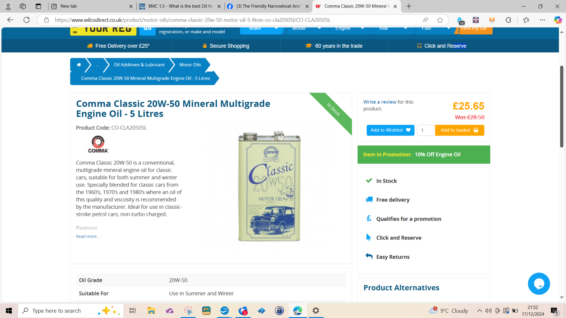

Wilco use to sell an oil of suitable spec. I did hear they were now trading on line, but I don't know if its right
Edited by ditchcrawler
