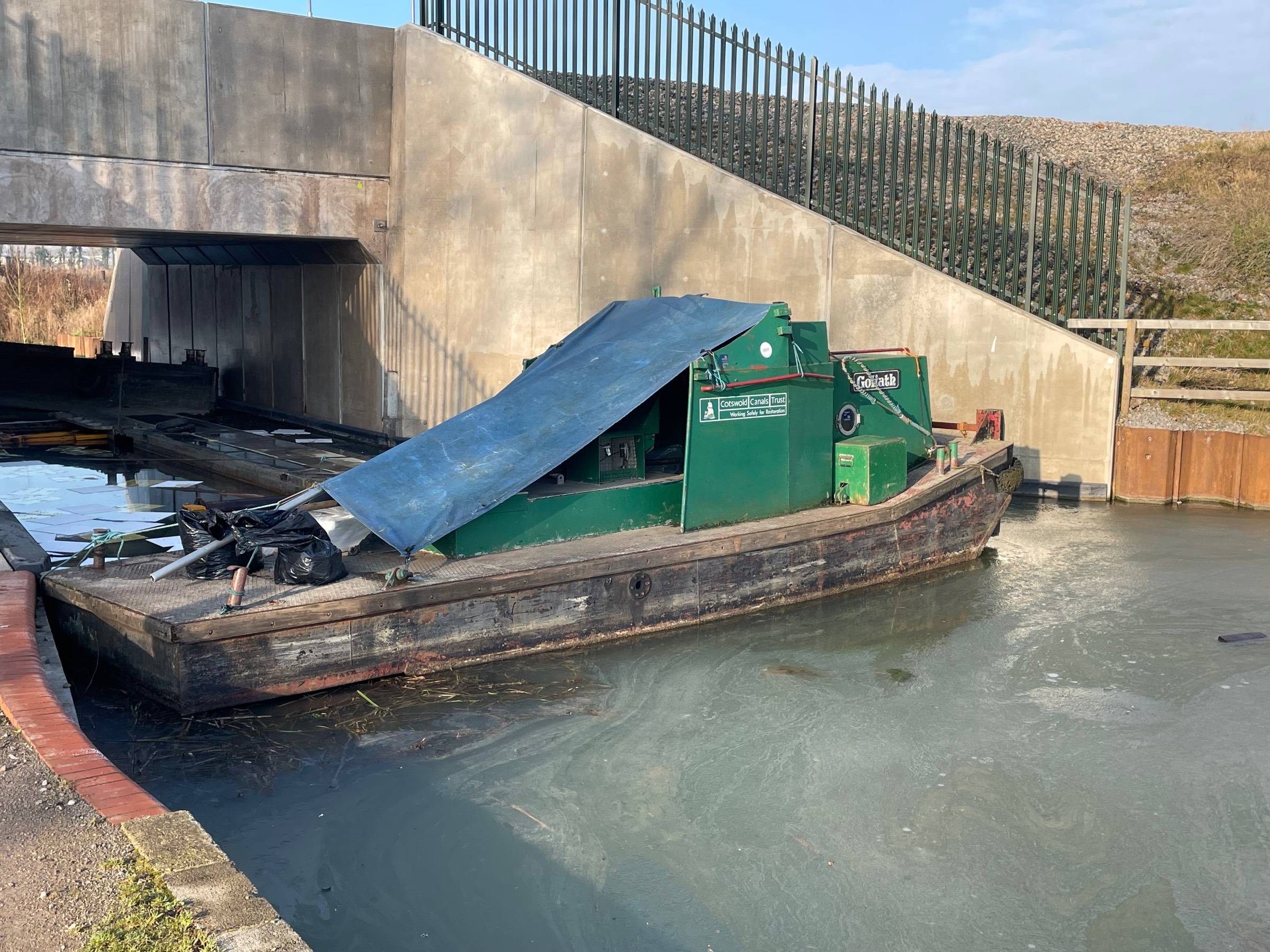

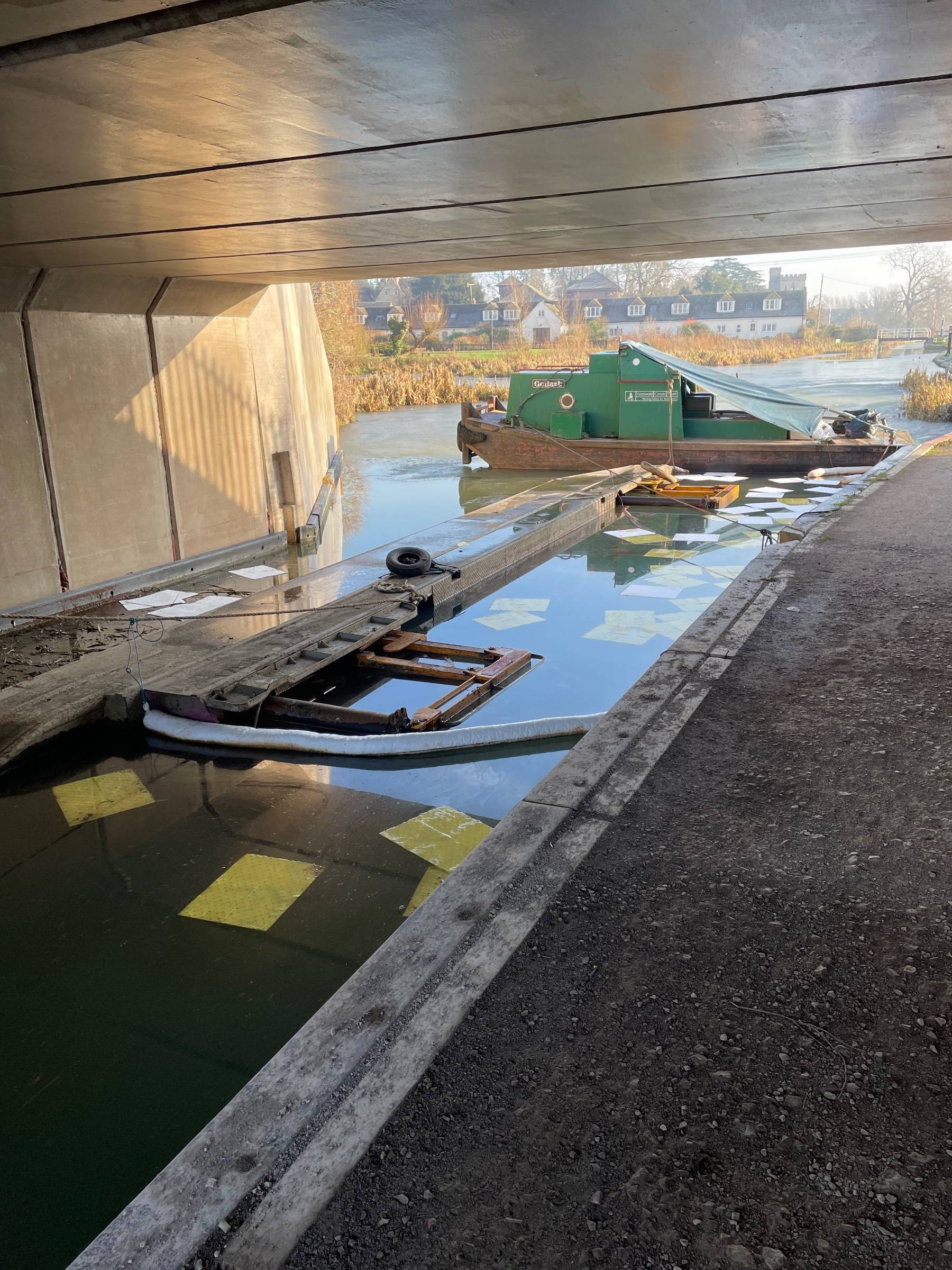

Sadly it is proving very tough to refloat Patricia. She is pretty much underneath the new railway bridge completely on her side.
To make matters worse there was a leakage of possibly diesel a couple of weeks ago and a kingfisher appeared to have died as a result.
Finally the canal level has been drained right down this week  but still it wasn’t possible to right her. Another go next week. It’s 2 months since she sunk so hopefully it will be sorted soon.
Apologies I only have pics from a friend. I noticed @5239 seems to be in attendance.

We had a similar ex BWB machine for many years, fortunately it never sank  in our ownership. If it is of any help, ours weighed around 18 tonnes in a length of 32ft.  and much of the ballast was poured concrete about 6ins thick over the rear 3/4 of the hull. It was always top heavy  and unstable due to the weight of the digger arm when closed up , at max height. I suspect that was the problem here, boat being moved with stabiliser legs up.
I think the first stage of recovery would be to get it right road up. I assume there is no access for a crane? If a winch could be attached to the top of the boom of the digger it might be possible  to right it , then lower the canal level  until gunnels are above water and pump out. Does it have any ballast tanks  built-in which could aid refloating (once righted)? I wish you well and hope she doesn't have to be cutup in-situ.

Bit of an update. Sadly Patricia remains on her side without any progress other than knowing some things that won’t work . She is pretty top heavy which won’t help.
The water level was dropped significantly to have a good go at the end of January but with no success. A coffer dam is still there at the swingbridge.
On 01/02/2025 at 11:07, Paul C said:
Would be interesting to know how it is eventually recovered, given the location and that winching off the bridge is a no-no. Can vehicles access anywhere even vaguely near the site?
there is a narrow embankment on the one side. (With three leaks also being looked at ) There is access possibly the other side but the ocean is very wide. There was access the other side of the bridge in order to build the railway bridge but that’s probably no good for a crane.
I do fear an ask of Network Rail at the Easter shut down for a mobile crane (huge cost probably) maybe an answer. Presumably links from building the bridge could prove useful.
