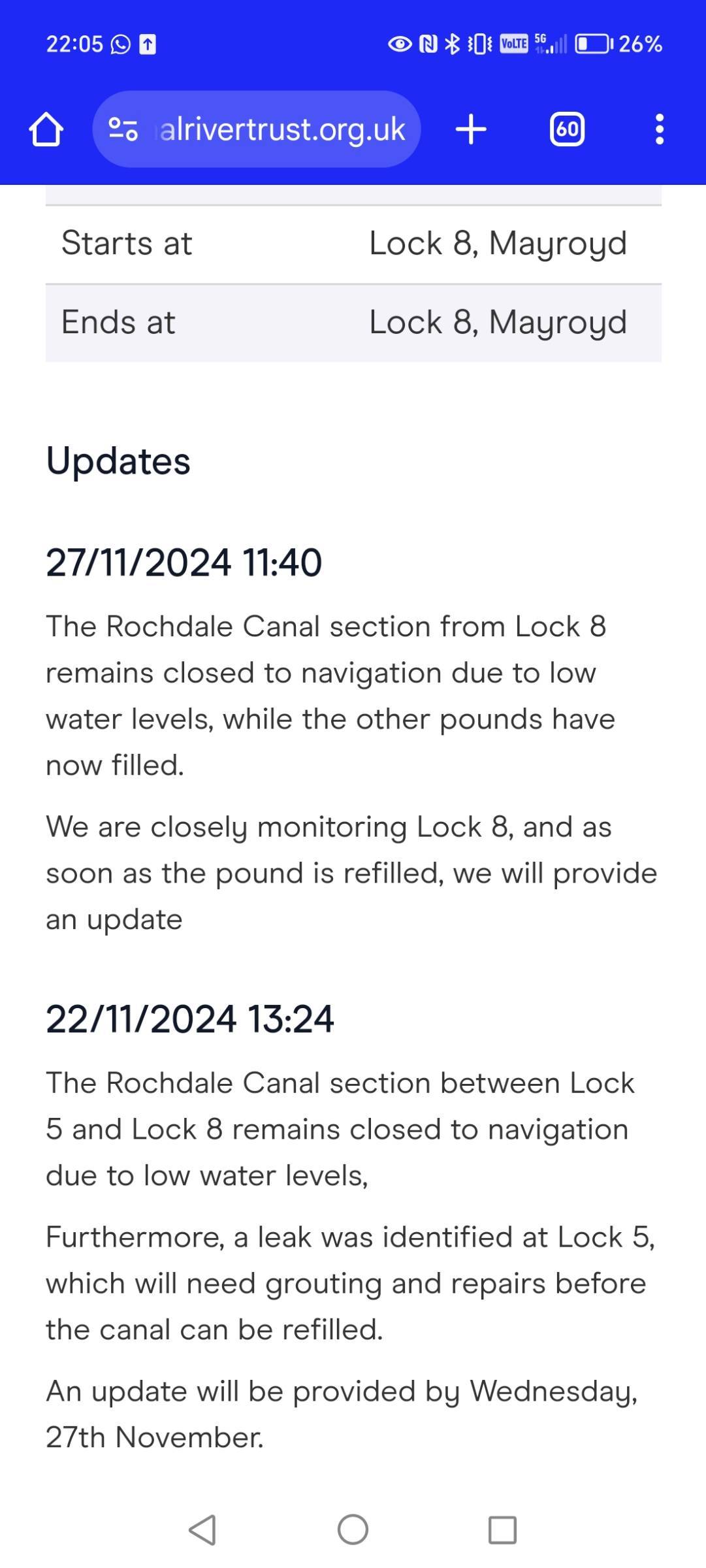

Lock 8 at Hebden Bridge has continually been a problem, with a leakage issue meaning the pound above it always being low, but CRT have apparently been fixing it.
Except we just had horrendous rain, with Eastwood (up from Hebden Bridge) flooding the canal and Hebden Bridge flood alarms going off...
So if ever there was a time for water levels to be fine, it would be now. Heck, the pounds down to lock 5 which were low have refilled.
Except, you guessed it, the pound between lock 8 and 9.
I'm sure they'll actually fix whatever the issue is at Lock 8 at some point. Its only been 3 years now of continual problems :D
